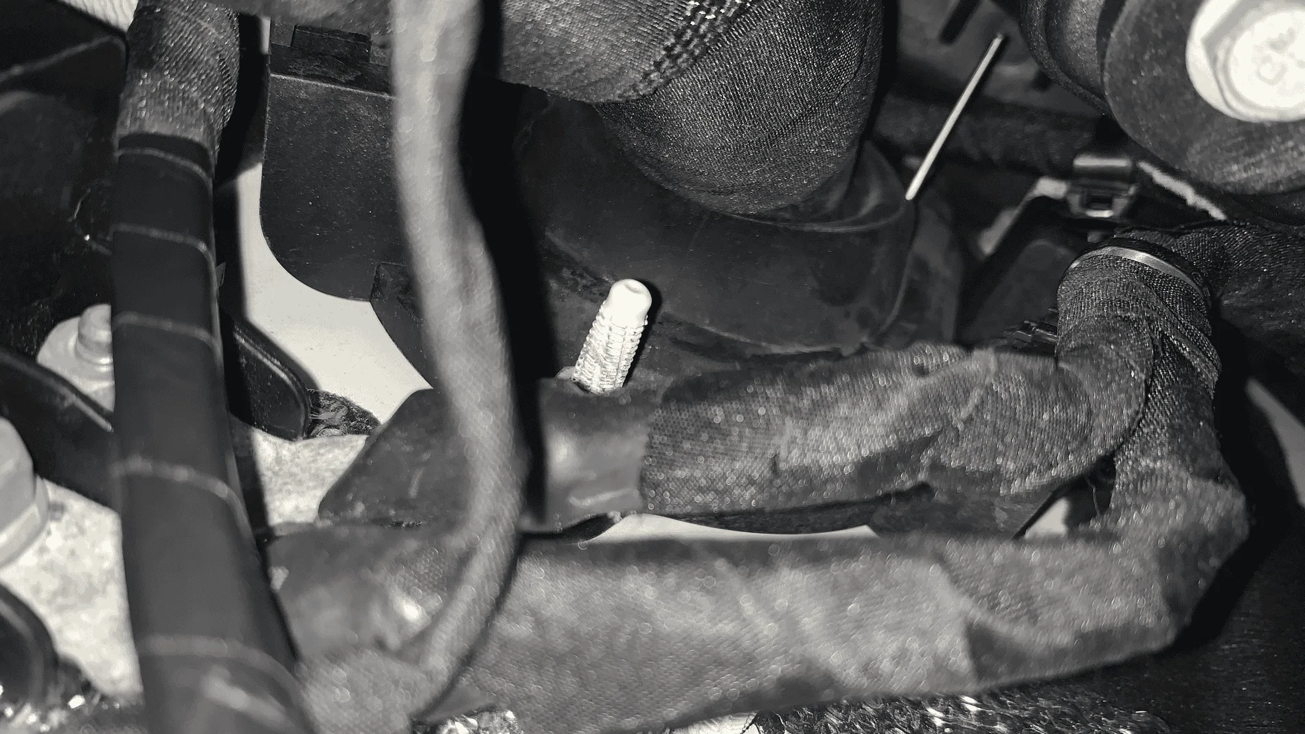

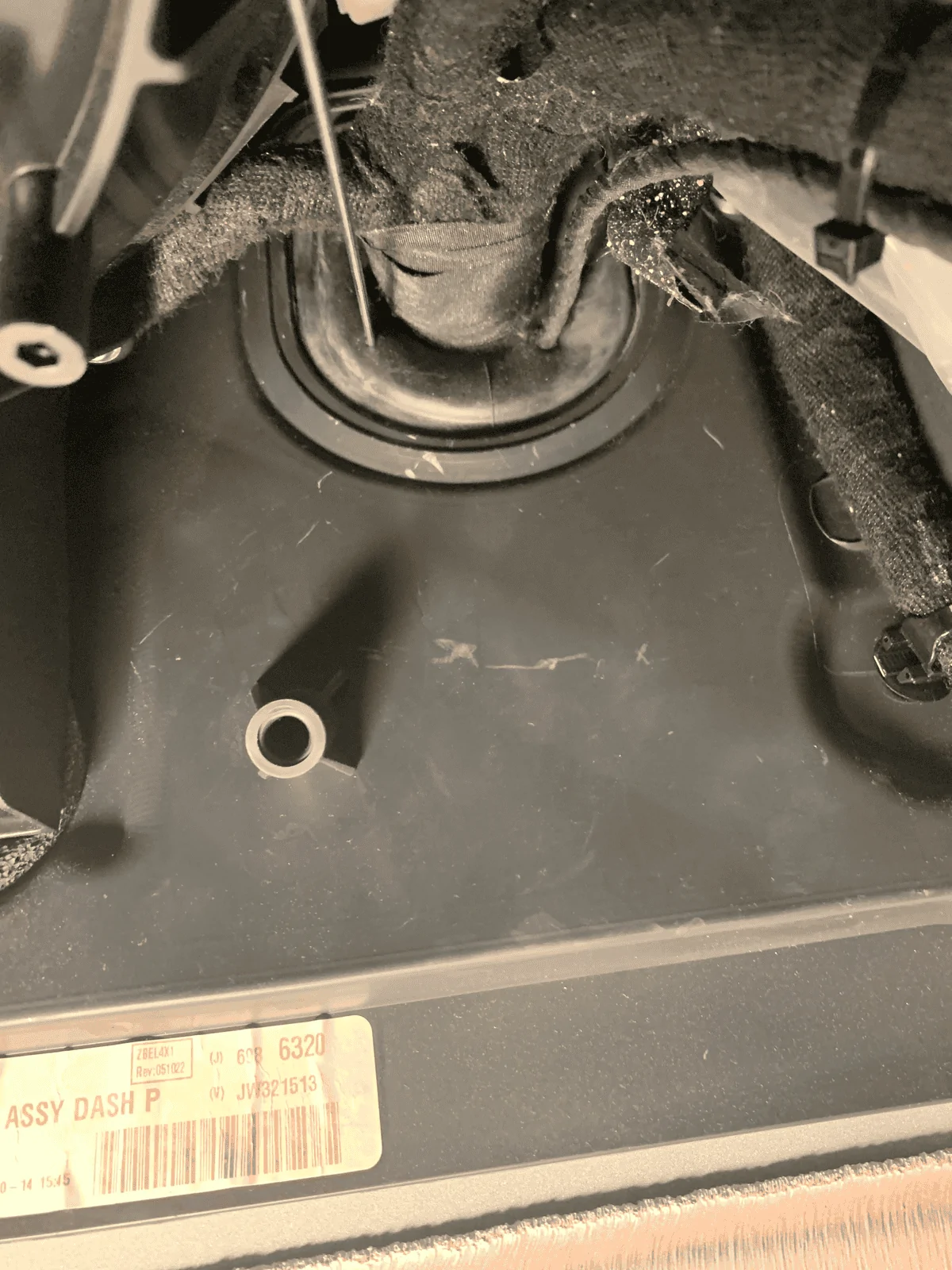

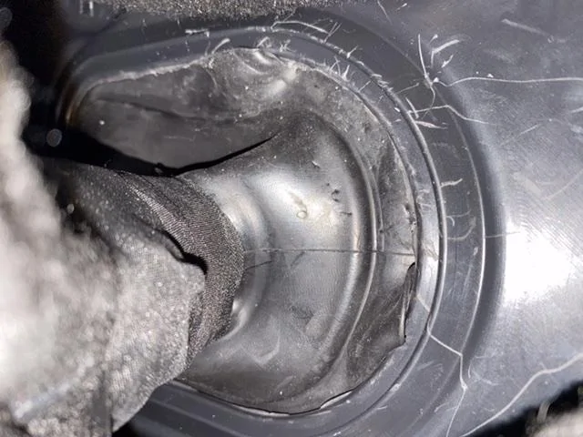

Getting through that grommet was tremendously challenging. The grommet felt like a solid puck of rubber, that gripped anything I tried to pierce it with. Bending down in that footwell, looking up, and trying to both pierce horizontally while only angling vertically... oof. I ultimately used a coat hanger to pierce the grommet, make a hook with pliers in the engine bay, and then yank it back through.

I used a small razor knife and cut a slit in the inside and then had no problem getting it through the grommet.
