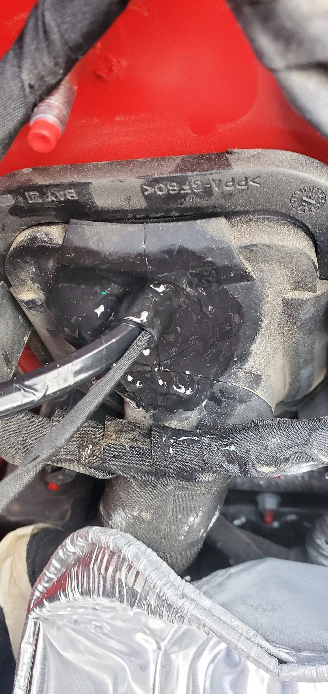

Having flashbacks about punching through the firewall while I'm on my back in the passenger side footwell. The rest of the install took 15 mins, that took 2 hours. Ha!
Same here, it is a pisser. I considered myself well versed in doing wiring and followed the instruction to a tee and still wound up cutting a factory wire at the firewall grommet pulling the harness through.

Wow I used a lot of lube doing that....

Why is all the lube on the outside??
It started on the inside and on the bundle. All the forceful ramming it in and out got it everywhere.
