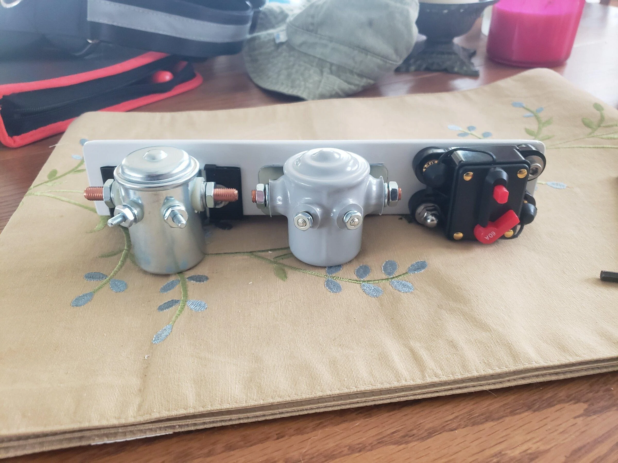

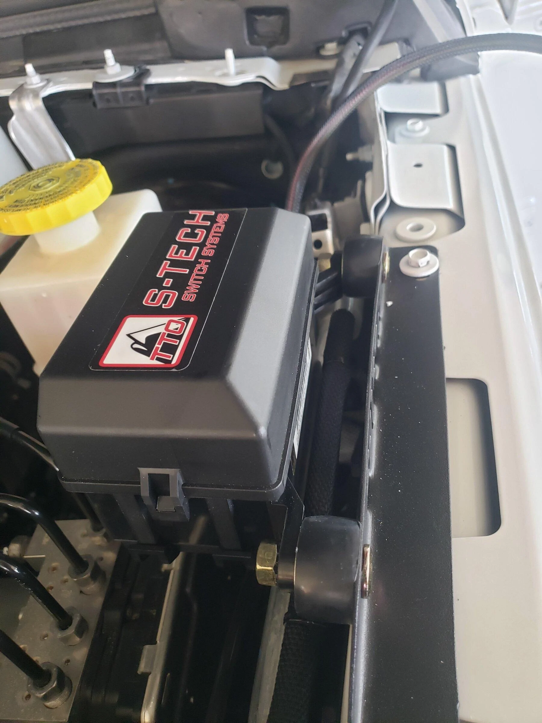

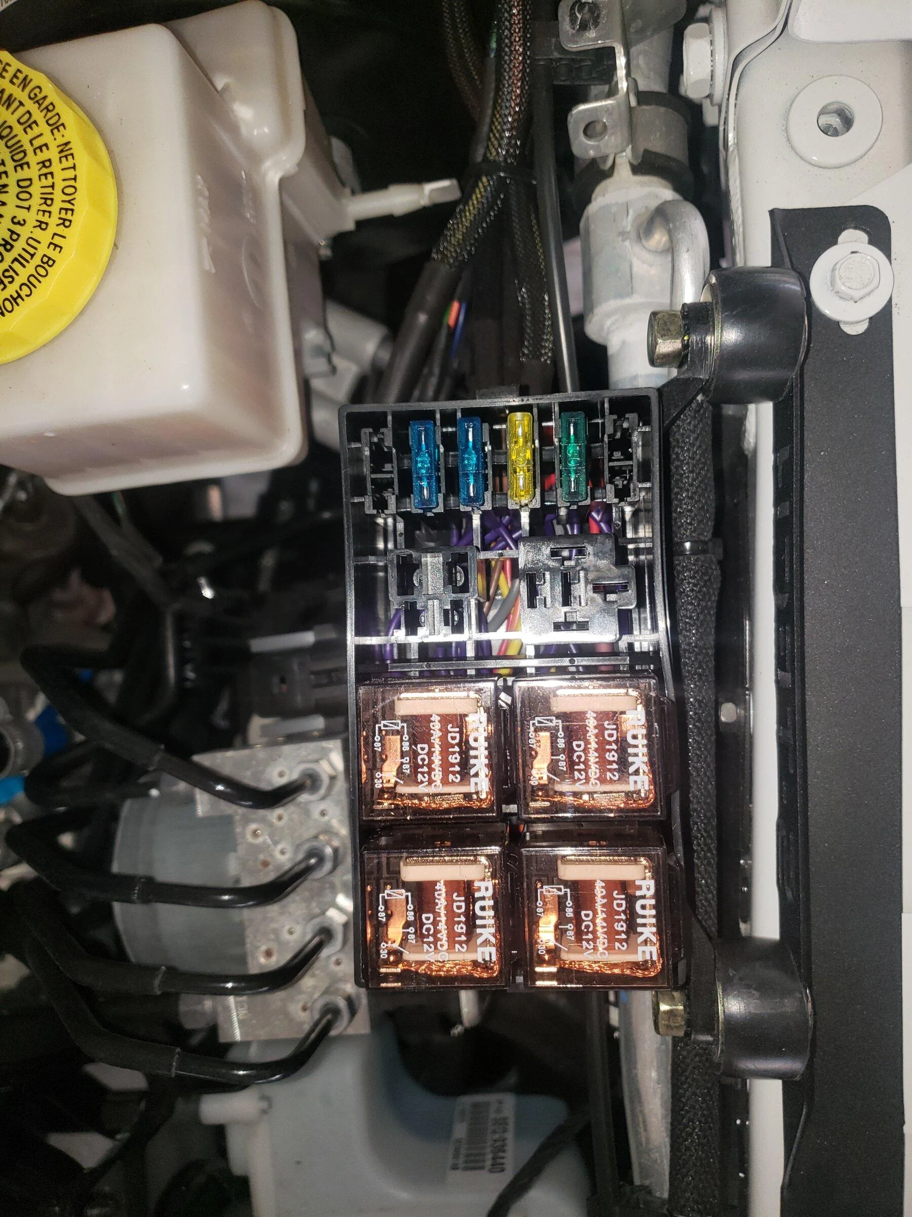

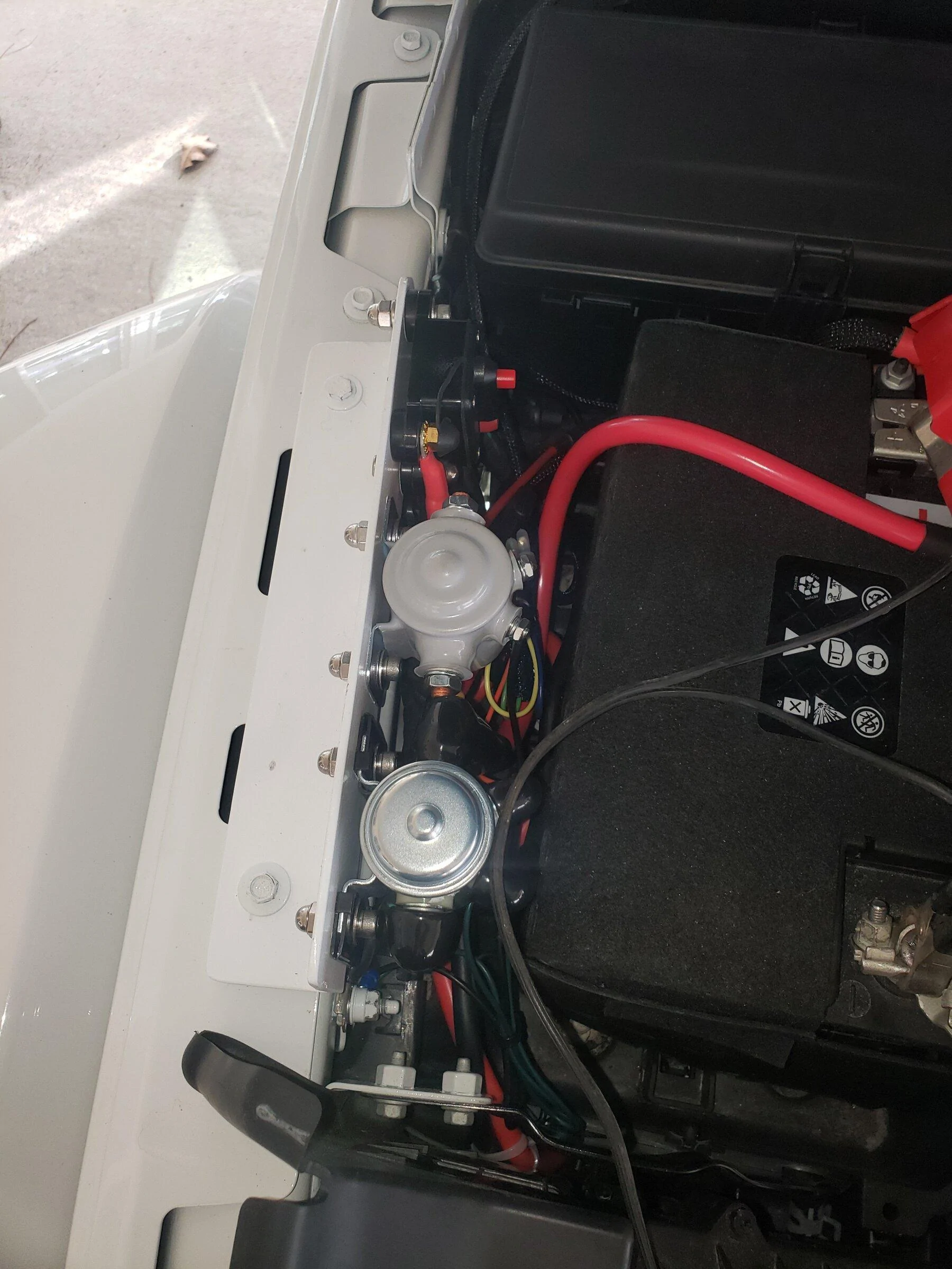

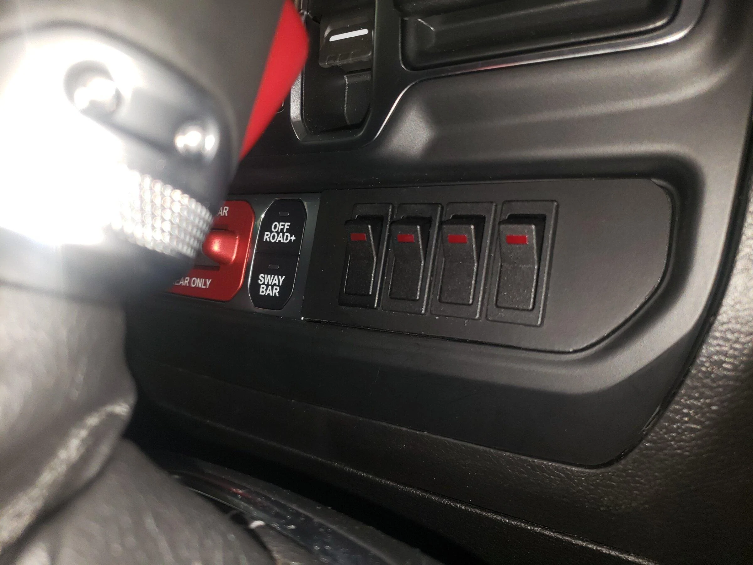

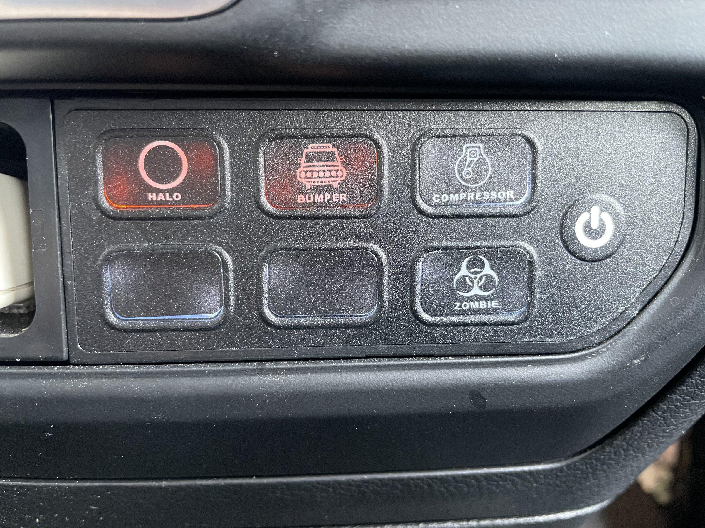

I have a question about the different auxilary switch panels available. Are these switches can bus type switches or can they wired directly to my own relay?
I want my switches to be located where factory put them. I currently have a small cubby at the lower right of my dash panel. I bought a switch panel from S-Tech ( don't have it yet ) but it looks close to the factory switch panel.
I finally got around to hooking up the auxiliary switch panel.
