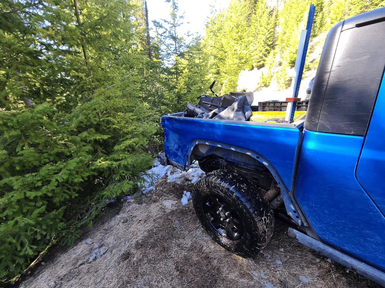

I have an issue with the rear fender (ripped off) on my JTM that I am hoping to get some guidance on.
I really prefer the OEM painted flares (hydro blue) that I currently have. I know the best deal will be to wait for something to pop-up locally, but I don't know if I can wait that long.
Does anyone know where you can purchase a single OEM rear fender, other than the dealer?
I know the fronts are different, but are the rear fenders different on the Mojave versus other Gladiator models?

Mojave and Rubicon are the same.
You can check somewhere like car-part.com you should be able to find one if you're patient.
How bad is the old one?
Pretty scraped up and I am assuming some broken attachments. Knowing that I will most likely be forced to paint one regardless, my other option was to see if this one could be repaired.
Just trying to weight the cost between the two (repair or buy new) versus waiting for the right one to pop up for sale.
Thanks, I will try that site.

Most of the time the only thing that breaks are the mounting clips. They are cheap to buy on amazon.

Keep an eye on the normal places, eBay, Marketplace or even here in the classified section.
For an idea on cost. I had to replace the pass. front fender on my JLUR in Mojito! green (BTW, insanely hard color to match). The new Mopar fender and painted was roughly $750. I installed it myself, the new one already had the new clips and LED turn signal/marker light installed on it. Took about 25 mins swap the fenders and liner out.
Since the rear fender is smaller, it should be cheaper.
ALSO, Mopar/Jeep does NOT sell them painted
Hope that helps you make a decision
Thanks, I just bought some to see if I can make it work.

Thought I would provide an update on my fender situation after I finally got the nerve to inspect the damage.
I had forgot about the PPF that was on the fender which did an AMAZING job of protecting the paint. Very impressive stuff! Unfortunately, there were a couple of sections that weren't covered by the PPF. The inner splash-shield tabs were ripped out where they connect near the frame and again on the outside where it connects to the fender. With tabs also broken on the painted section, I determined that it wasn't able to be saved. At this point, I chose to touch up the painted portion of the fender and then do the rear fender "chop" where you separate the inner fender from the outer.
The replacement parts I have found for the 1 fender are in the $300 range, plus paint. I will wait for a little while and see if I can find one for sale before I choose to just buy a new fender.
Appreciate everyone's help and suggestions.
