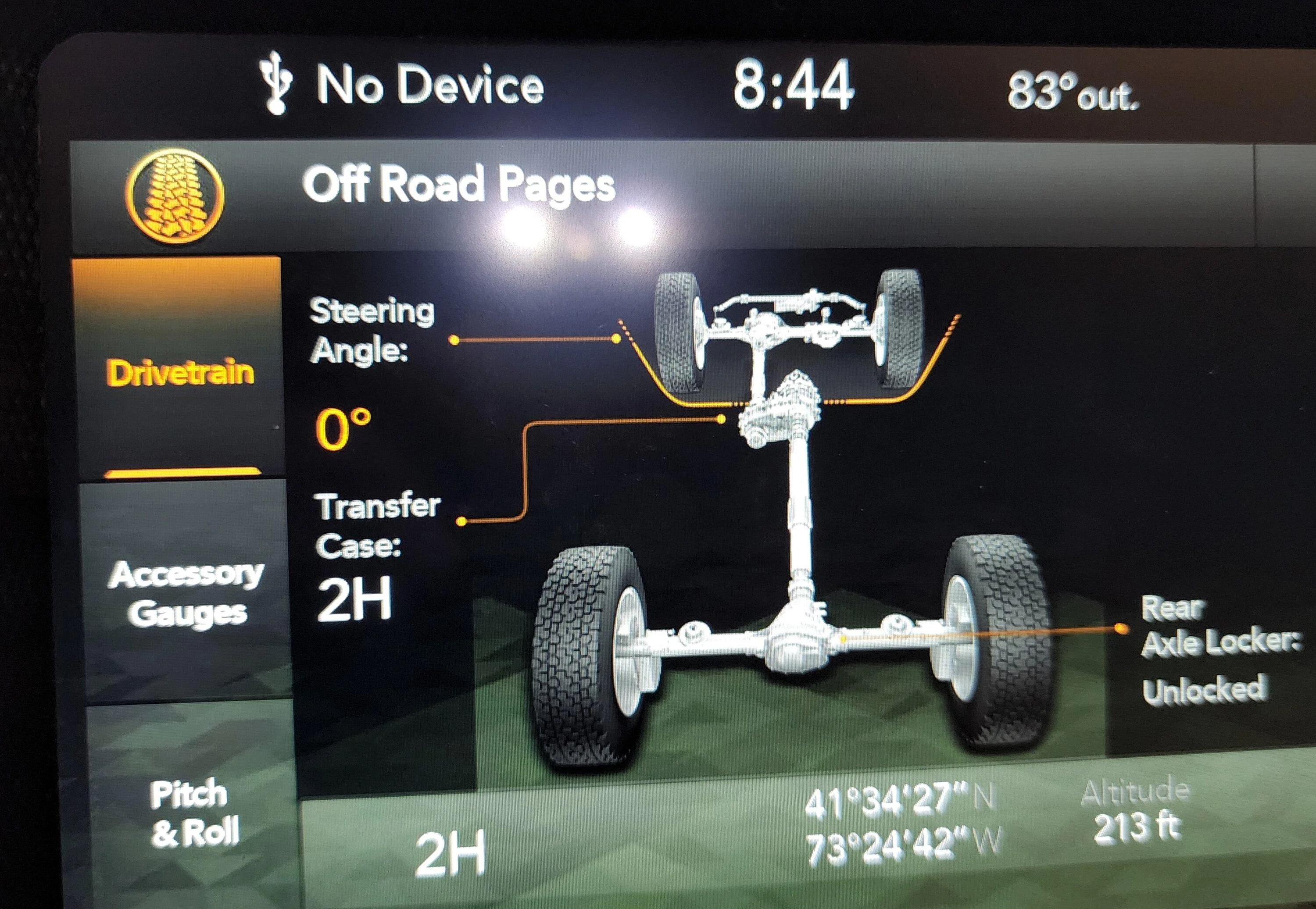

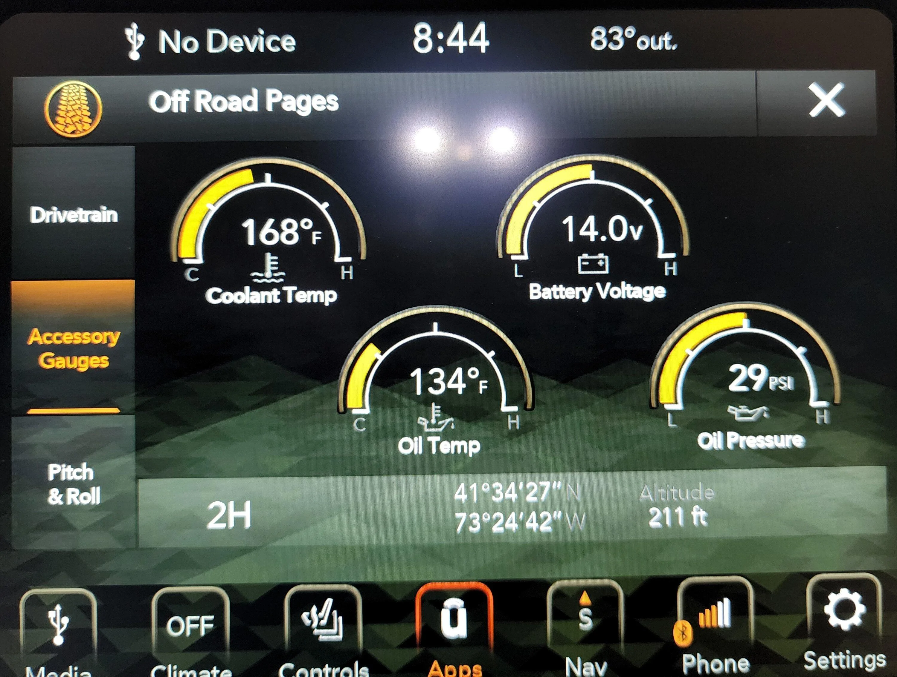

WE HAVE CONFIRMATION
Good work! So this is 2 for 2 now (me and you) that have confirmed that the SGW bypass does indeed seem to be required to get the gauges to work. Plus the infotainment.com website basically saying the same thing.
I'm guessing you have the 6-speed? I have a transmission temp gauge too but that wouldn't be there obviously if you haves a manual.
Again, thanks for confirming this!
