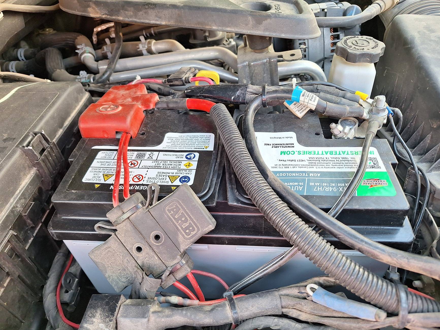

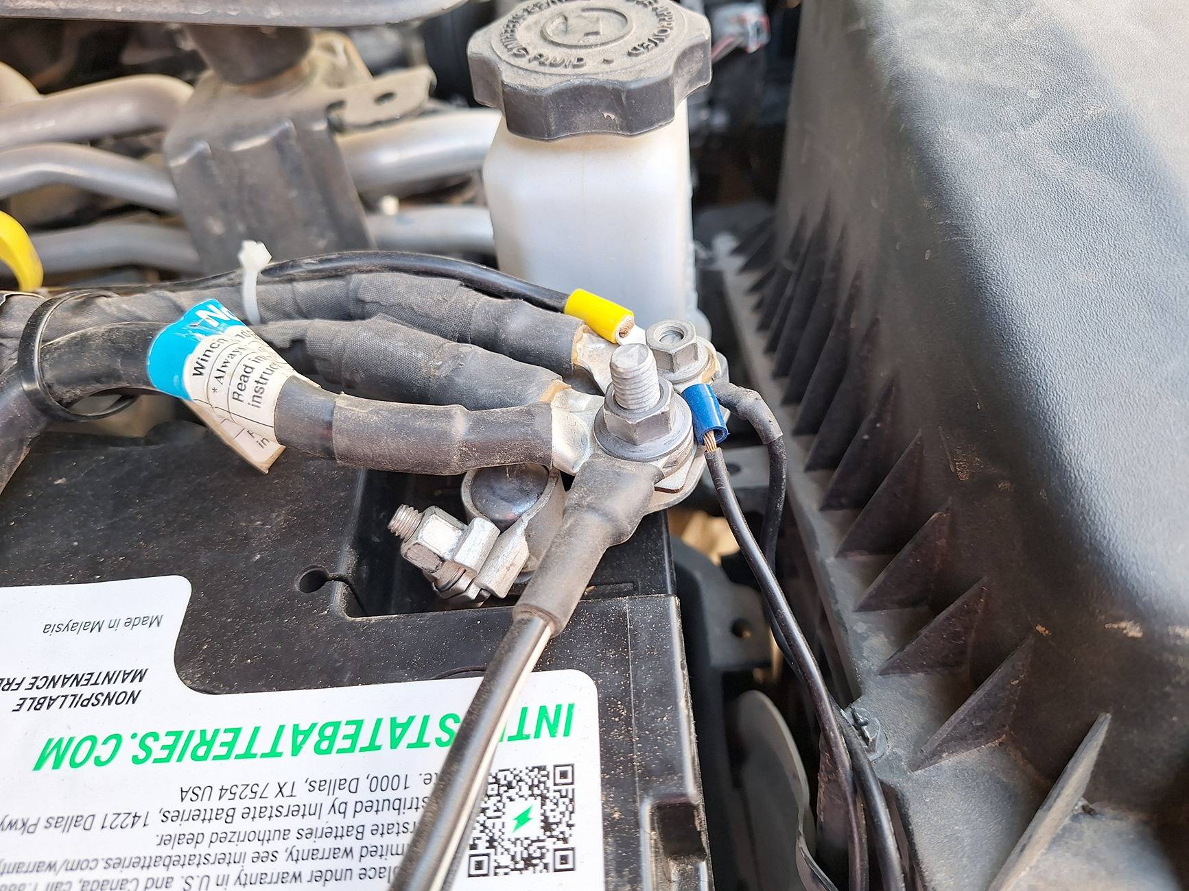

A picture of your situation would do wonders for those trying to help

Deleted the Aux Battery and replaced the main battery. Everything seems to be working Gunner now. Here are two photos and one shows the accessories post on the negative side that folks were questioning me about.
