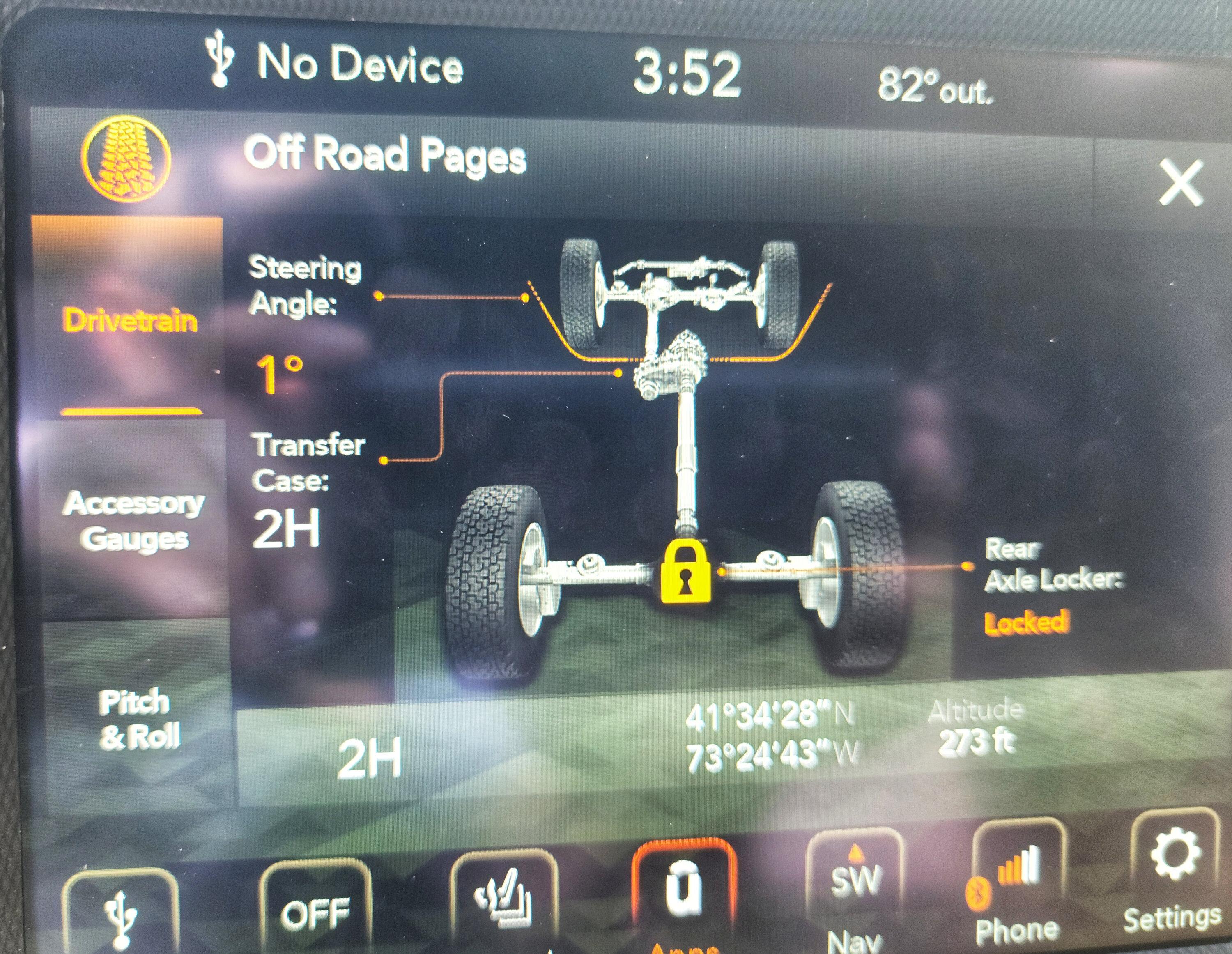

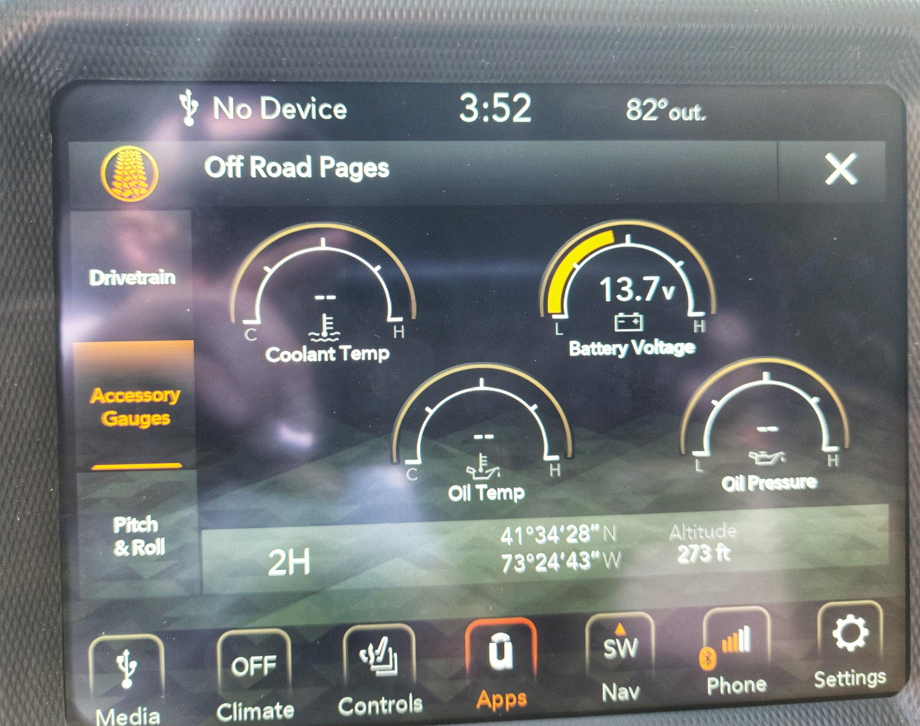

There was a post by someone that got the ORP to work. They activated it with a programmer, but had to have a module plugged in to the bypass cable for all the gauges to show on the ORP screen.

So riddle me this...You buy one off of someone (with the correct code)
You install it
The OFR icon appears and runs but doesn't show all functions
If it isn't authorized why is it showing up and showing some of the info correctly?
If what you are saying is correct the icon should not be showing at all...Not saying you are wrong, Im just trying to understand.

I know it doesn't either. But look at this:
https://www.infotainment.com/produc...pages-programmer-c-orp?variant=31054959247396
They sell an OBDII dongle JUST FOR ENABLING ORP and it's $179! And look what it says in the details:
The bypass device must remain installed for the Off Road Pages to function. Do NOT remove the Bypass Module once installed.
I wrote to their tech support to ask why that is, and this is what they said:
The bypass needs to be installed because if removed the security in the vehicle will disable the programming for off road pages.
That seems to me to be further confirmation that for some solutions a SGW Bypass must be in place for ORP to work correctly.
Then its the security key that needs to be enabled .
