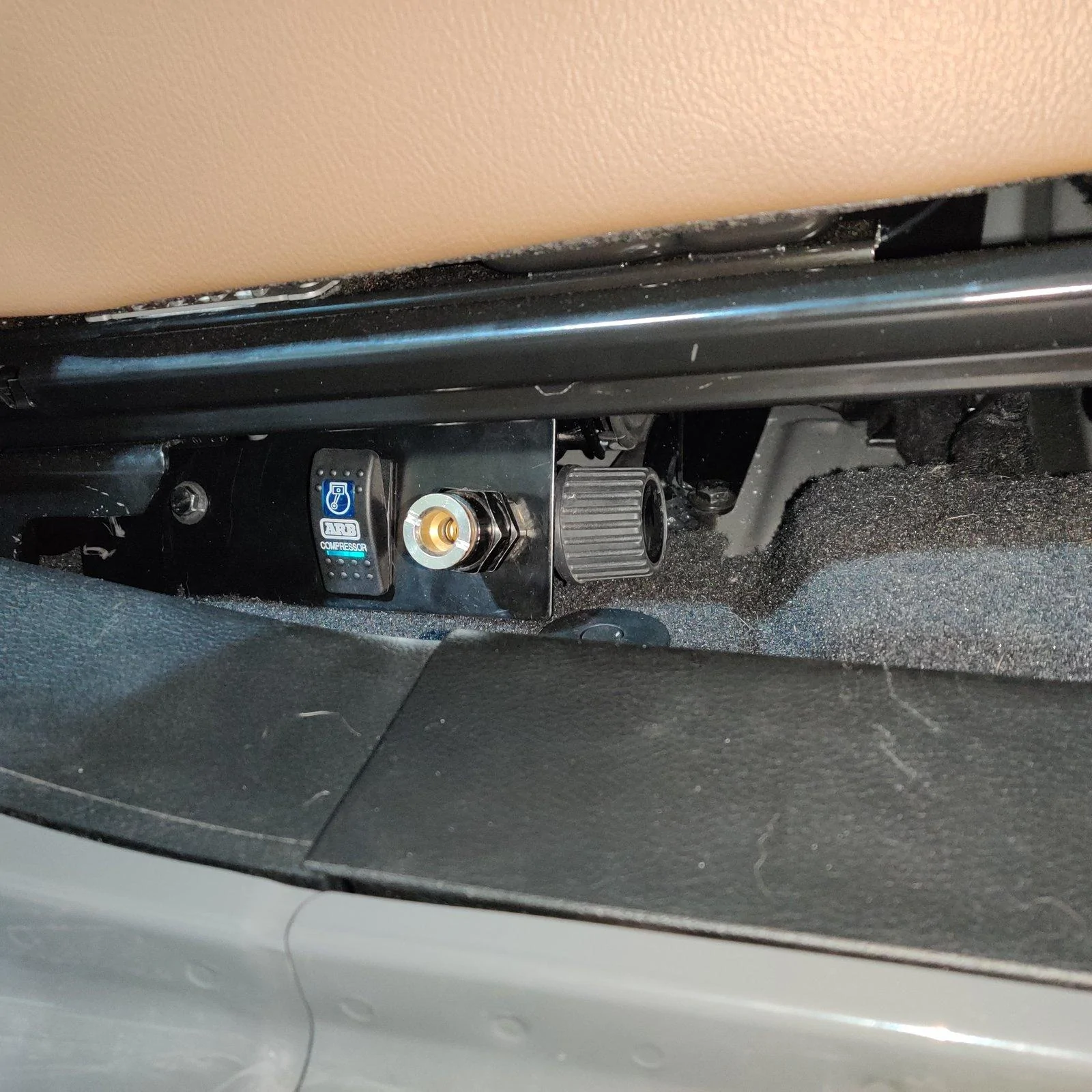

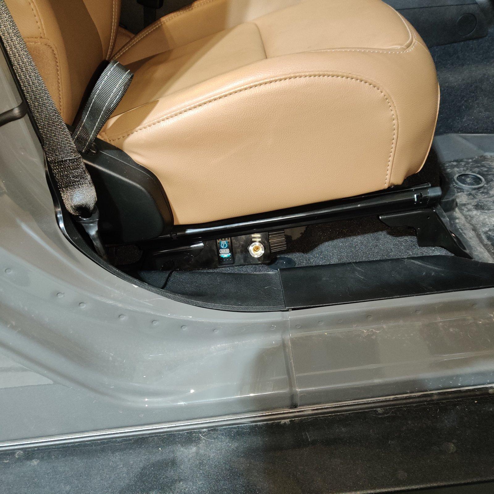

ARB twin installed using their JL/JT mount. Added a regulator for giggle shits and I had it.
Can you explain why you prefer to mount inside the vehicle vs mounting under the vehicle (or hood)? Is there pluses and negatives to both?
Lots of people have had issues with overheating them with the only under hood mount I've seen. Xoverland had trouble with theirs too. A lot of heat next to those headers there. Underneath. Water and these things are not cheap. Under the seat is protected and cooler.
Wayoflife has a kit for connection to the firewall that routes out to the bumper (he just put a video out for it). Do you think there would be possible overheating issues there etc?
Had to look it up as I would never run anything made or sold by Eddie. He still deserves a swift nut kick for what he did to me and others on JK forum. I hear the bounty on his rat tail is still available if someone cares to collect but he tends to hide.
That being said. It's the exact same setup that everyone is having issues with. That area is very hot and will heat soak. This caused several people to have compressors shut off due to thermal overheat. Mild success has been found with heat wrap but it's still questionable if it will get all 4 tires every time without shutting down. Not everyone has this trouble but I live in Utah and hot is no stranger here. To avoid this whole hassle I opted to avoid the situation and just go underseat. Especially since the ARB kit came out and is further under the seat with a kick guard compared to the jkinovation underseat that puts the filters in the foot zone. Also the under seat ac vent blows right on the compressor now so I'm not worried about it warming up the cab too.
Thanks for the info, glad I came across this before I made the purchase. All makes sense. It'll be going inside for me to.
