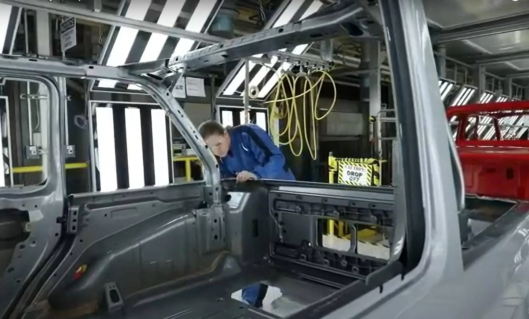

Quality? The paint on my 25 is absolutely horrible compared to my 22. It's like it was sprayed in a local shop.

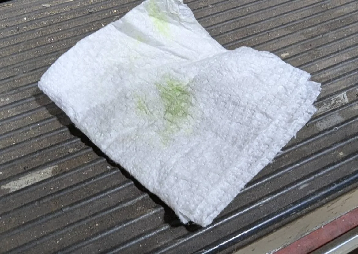

When I was wiping down the door sill area to put some clear paint film protection on the sill area, the rubbing alcohol dissolved the paint on the sill.
i assume it failed inspection after assembly and they did some touchup?
Paint should not come off on a paper towel with cheap rubbing alcohol.
I’d bet that is just some overspray that you wiped off, don’t know what order they paint these things in but I’d make sense to do the can/roll bar then doors/hinges/exterior, who knows.

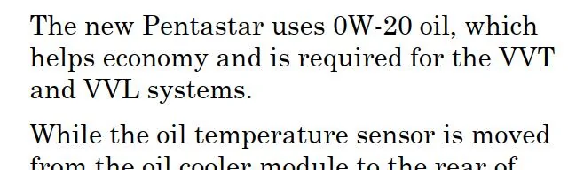

Ok, serious question. What changed in the pentastar 3.6 to move from 5w30 to 0w20? I mean this isn't a new design or new engine... so... why did it change?
Yes, it is a new design. MUCH changed, in fact there's a multiple page document with the changes.
VVL added, VVT methods changed, crankshaft bearings are quite different - sizes, materials and so on, 2-stage oil pump.
Things are monitored closely - including valve lift stage, CCDIFF and more.

Valve guides are shorter, different springs, totally different timing chain and sprocket design......... it's a long list.
The PUG was introduced in 2015 for the 2016 model year of Grand Cherokee and some others.
JK still used the old design 3.6
Wrangler didn't get the new design until 2018 (JT from day 1)

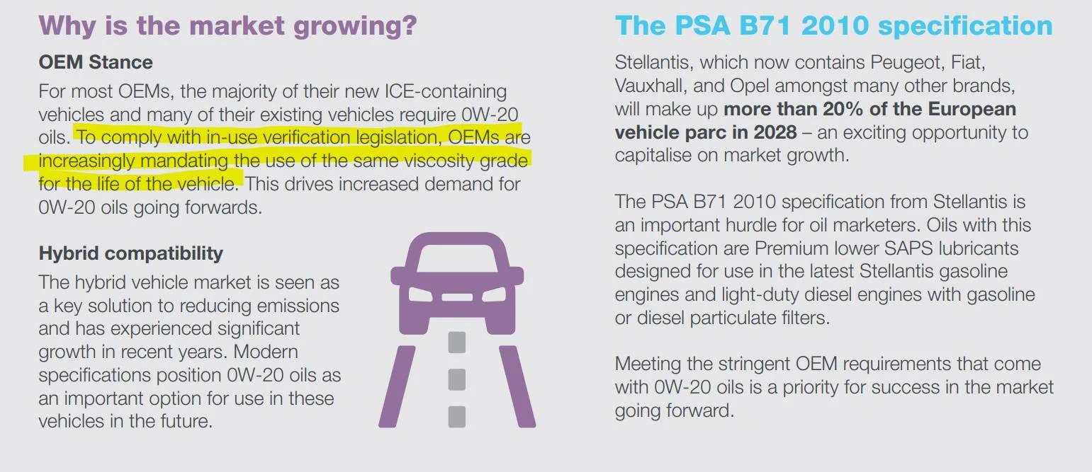

GM in Europe is in big trouble because their rules state that a vehicle that is designed for a specific oil, and comes out with a specific oil, must run the remainder of it's' life on that same oil.
In other words, GM is getting by - literally CHEATING customers/owners - but in the EU, this won't fly. Sorry, GM - you must fix it so that it will again run on 0w20. Don't pass go, don't collect $200 - go straight to jail.

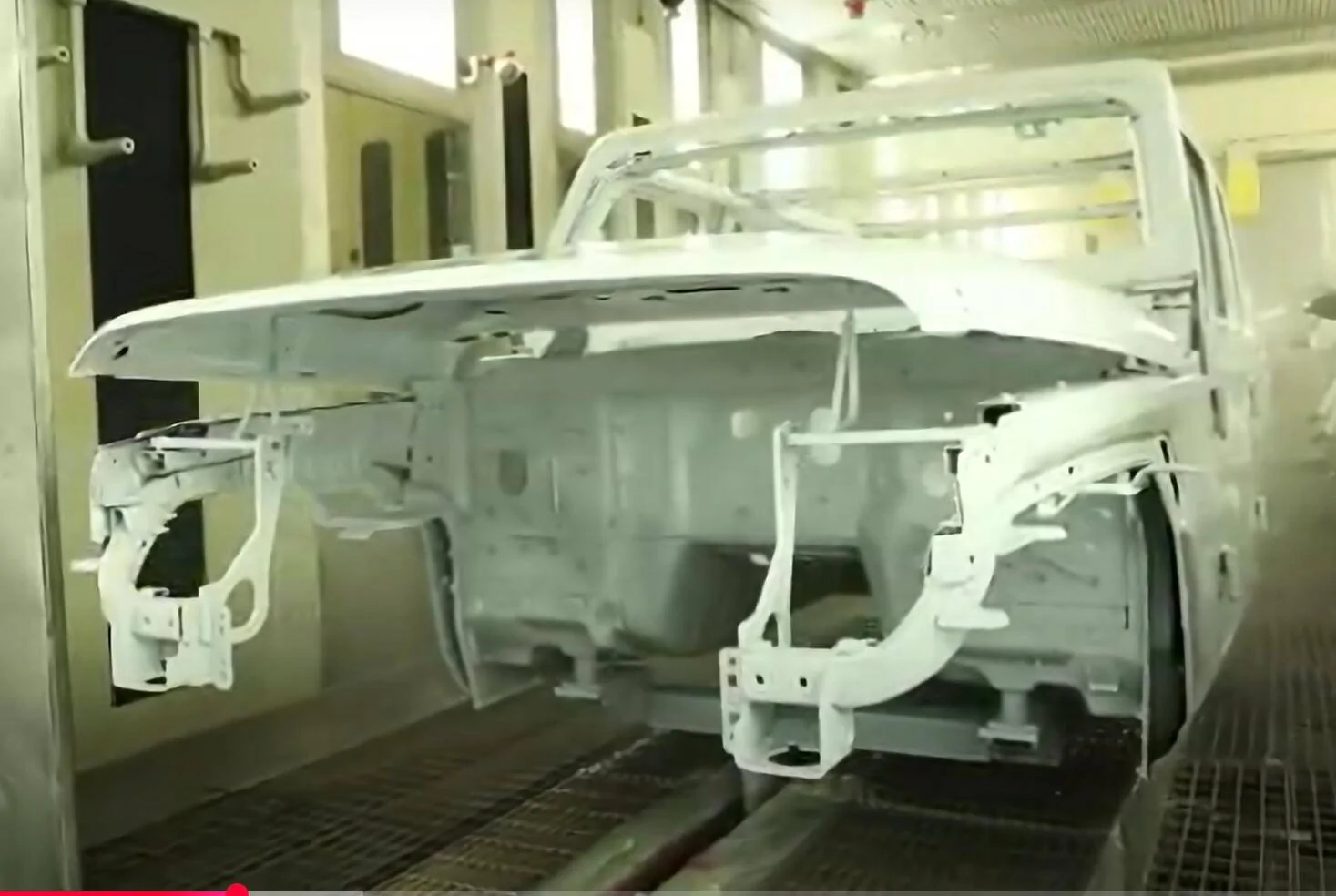

Painted as a unit - body, hood, doors, windshield frame, roll cage, all of it. Grill and roof added later.
It was only on the right front door sill area where the paint came off and it looked a bit different.
I suspect a flaw was found and addressed with "touch-up paint".
