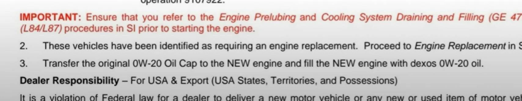

HI All, New Info.. there is a 3rd notice - not public yet per this youtube video.. look and see.
And this is exactly what I've been saying - the 0w40 oil is a MASK, a bandaid, kicking the can down the road, a "nothing to see here, just do this instead" thing.
If the 0w20 oil was the problem, then explain WHY is GM stating this -
PUT 0w20 oil in the engine!
Jeep Gladiator OIL, 0-20 or otherwise (couldn't find the other oil threads) 1746568974251-ra
So GM is admitting there is NO PROBLEM with 0w20 oil - otherwise they sure wouldn't tell people to put it in the replacement engines.
The 40 weight is akin to putting sawdust in the old gear box to quiet it down instead of actually fixing it
This supports what I've been trying to say - the oil is not the issue - idiots working at GM are the issue.
