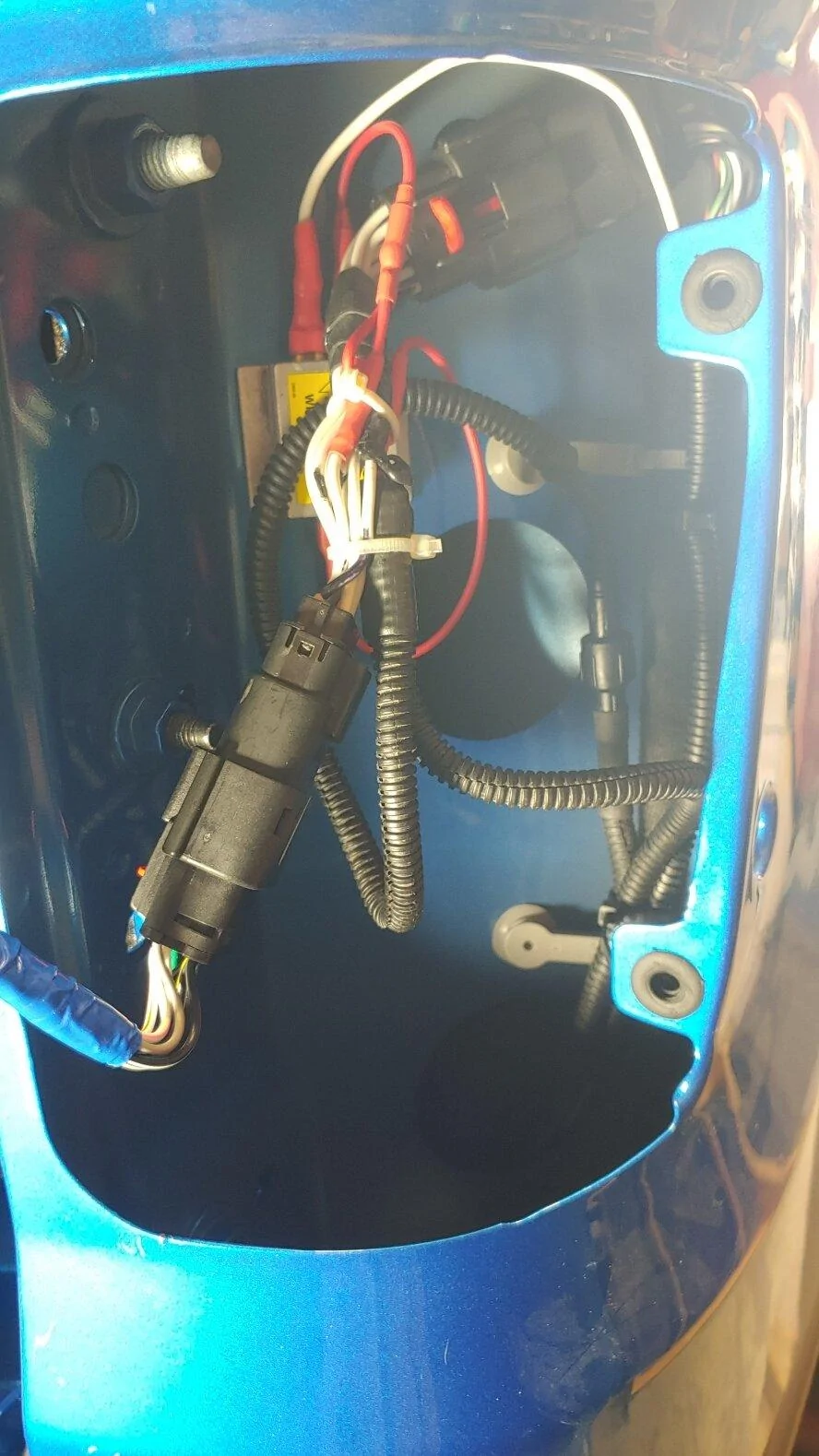

I had actually wondered about doing that as a solution in some cases - your lights don't have a huge draw, but these systems really monitor things closely and anything out of range can trigger an error.
(I had thought about buying a second harness for my setup for another reason - I run your lights from an aux switch through diodes. This means, though, that only your lights come on with my switch and not the factory lights. I'd like to rig it so that the original and Oracle lights come on with the switch and the easiest way is another harness the way I have things laid out)

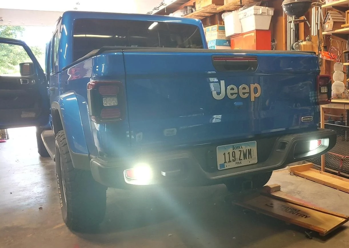

These will be plenty bright to help when I load up my cars on the trailer in the dark - this shot was in the daylight, sun streaming into my garage and the garage lights on......
Sounds good! Do you want us to send you a new harness for this?

Hey! Before you make any modifications, let me jump in! Another option for you is we can send you another harness and you can split the load, and this would prevent the error. Another suggestion is T tapping into the trailer tow harness, this usually works the best.
If you are interested in T taping it we are happy to provide you a credit for the unused harness you no longer need.
Please keep me in the loop or DM me if you need anything further.
I appreciate the offer, I'll handle the work around. I don't want anyone to think I'm not pleased with the kit. The fit and finish of the lights is awesome and they are bright as hell. Just a hiccup that happens, I'll move ahead and not worry about them.
Thanks for reaching out though, not many vendors do.
