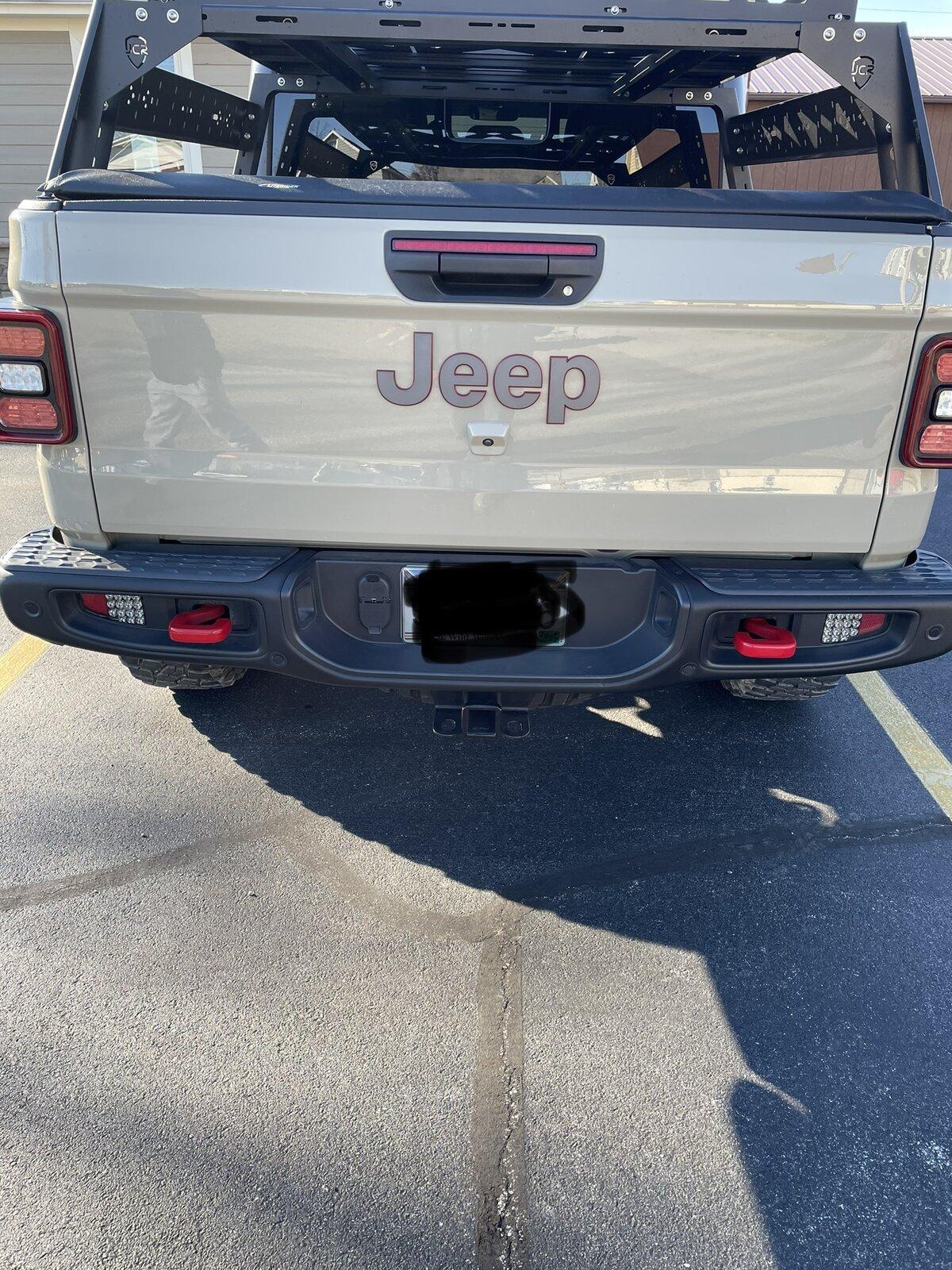

I am going to do this, I just got Curt harness. Do you remember what color wires the reverse and ground wires are that I would be tapping into by any chance? Im a newb when it comes to this stuff so any help would be great. I looked at the harness from Curt and there was no info on what wire was what. Thaks again
It is the the outside wires on the five pin side. The reverse is Blue and the ground is White.

When I think of using the Aux switches all I can think of is running a wire all the way to the back. Ha.
One thing Ford did with the Aux switches on the new bumper is they terminated the leads at different parts on the vehicle. Some in back, some under the hood. One even above the front windshield in case you wanted to install a light bar.
Easy run to the back. There’s a stock wiring bundle that goes all the way back on the passenger side, and can be followed and zip tied to. Clean and won’t touch anything. Easy as you don’t need to reinvent the route. Mine are wired to the reverse circuit and aux switch 4. Works great and was worth the work.
Yup, that's exactly how I wired the X Vision reverse lights. Way too bright to have them come on in reverse all the time, so just on AUX 4.

Well, in my case at least, the Vision X reverse lights come with a full harness, relay and switch. Since I had the factory switches, I repurposed the rest of the harness for another project.
I actually don’t mind them for reverse as well, but really wanted them when no one was in the Jeep, or at least when it wasn’t in gear. Cheap mod, but one of several I like a lot. I thought about just wiring them only to aux, but installed them for the first month using the harness, as it was easier. :)
