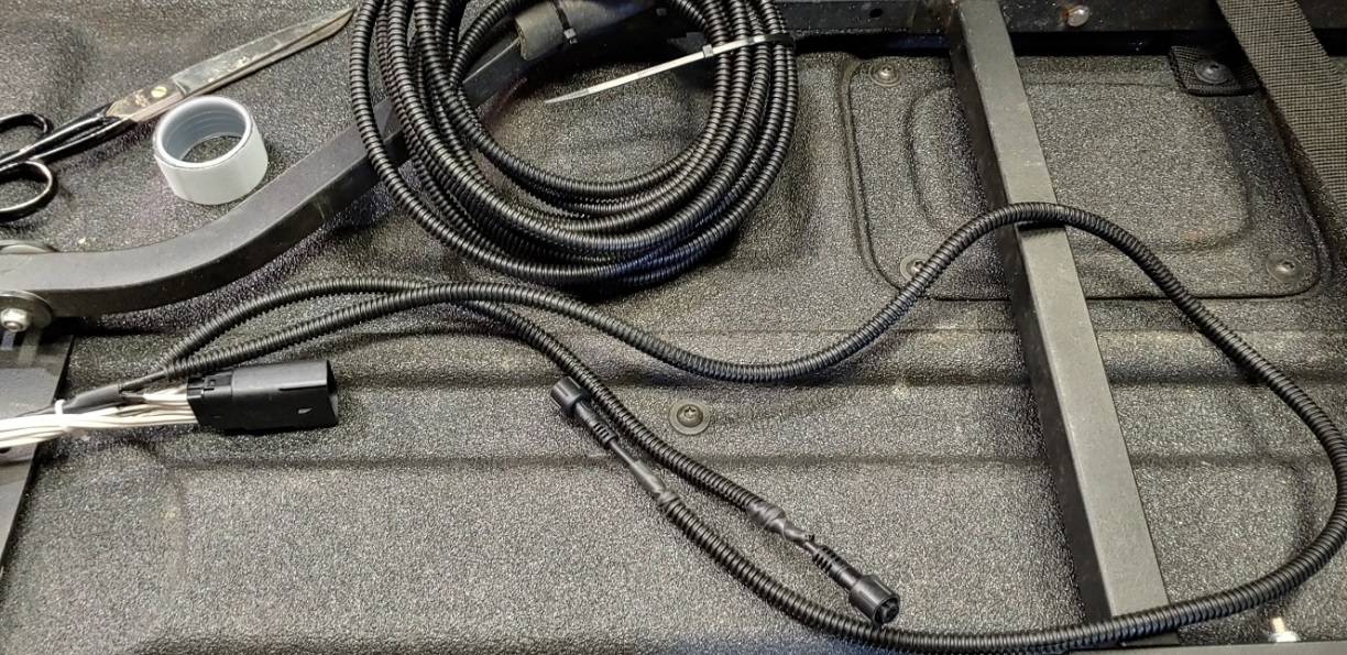

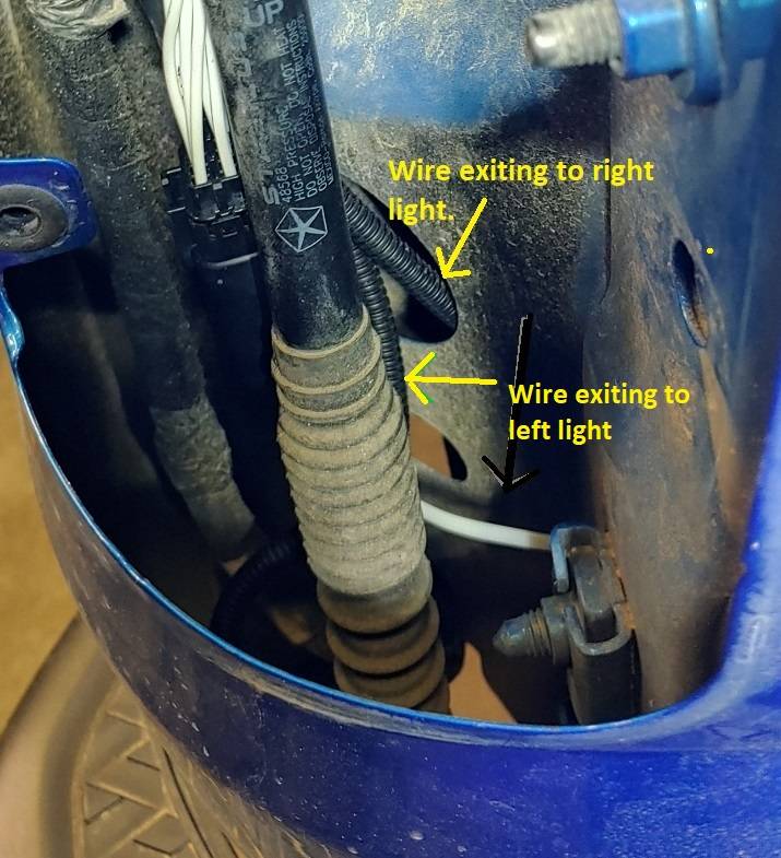

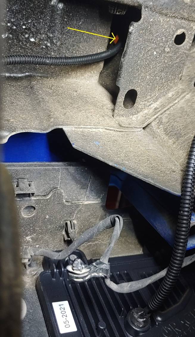

Mine came with the plug and play harness - remove tail light, disconnect factory connector, plug Oracle harness into each end of the factory wiring, drop the leads to the bumper lights out near the bottom (there's a hole I have pictured in my shots), run over to the backup lights in the bumper, connect, screw connector together, done.

The plug and play harness I got has a connector for each light.
Each connector has 2 pins - power and ground
Here is their plug and play harness - note that I put plastic loom over each length of wires but you can see both connectors in this pic - center lower half of picture.
The top is a roll of that plastic loom I used, scissors, my tailgate ladder, etc.
The tail light connector is on the lower left.
If you plug their harness into the left tail light then the short lead goes to the left bumper backup light and the longer one goes over to the right bumper backup light.
The connectors push together and then a shell screws over it all to hold it together.
Jeep Gladiator Bumper Reverse Lights 20210702_115845_HDR

Oracle is bright and very easy if you get the plug-and-play harness ($30 extra). You only need one since the hook up to the driver taillight runs a wire inside the bumper to the right side.
