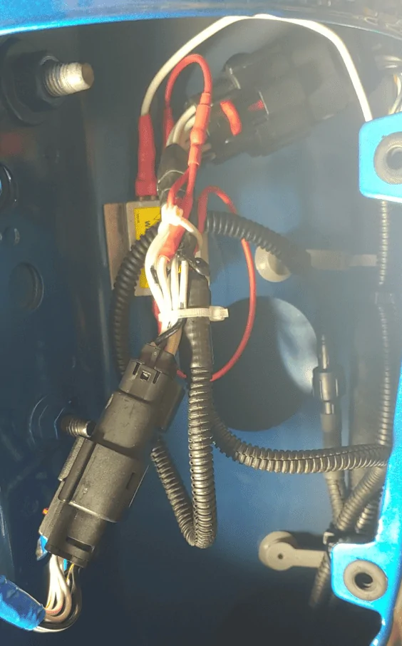

did you consider a 5 pin relay vs diodes for this application? I am about to wire mine in the same way with dual power sources. Currently compiling parts and seeing what my options are.
Diodes so much easier, nothing mechanical.
Two diodes allow you to have it in reverse powering all of the lights but not feed back into the aux switch, or have the aux switch powering them and not feeding back into the backup light feed.
You would need 2 connections for the relay coil - ground and feed from the aux switch assuming you are wanting to prevent back feeding to the truck's backup light feed plus the two connections from the NC switch of the relay. 4 connections, plus a relay.
White wire comes from aux switch up front to one of the "in" terminals of diode.
Red wire next to it goes to other "in" terminal of diode from reverse light feed position #5 in the Oracle harness.
Red wire from "out" terminal of diode goes to the Oracle backup lights.
I decided to not feed the truck's native backup lights via the aux switch because the bumper lights were more than enough for my needs.

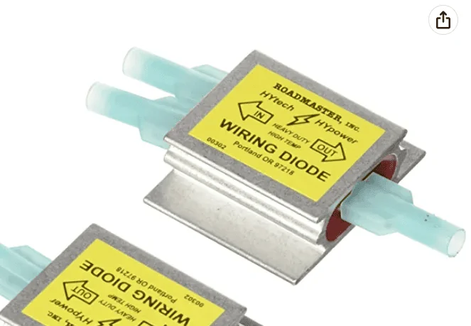

This is very helpful, thank you! Any particular diodes you recommend?
40,491
53,989
I have some small drawers (one of those cheap Walmart parts things with the clear plastic drawers) with a bunch of 1960s military surplus diodes and was going to choose from that, but instead went with a simple solution from Amazon -
It's got 2 in, 1 out, making it super-simple. And it saved me some time in the end - ready to go.
One of the "in" can be used for the connection from your aux switch,
the other "in" can be the feed from the truck's backup light circuit.
The out goes to the backup lights.
If I was going to operate the truck backup lights AND the Oracle lights from my aux switch, I may have gotten a second oracle harness and run them independently.
Multiple ways you can wire it up, really.

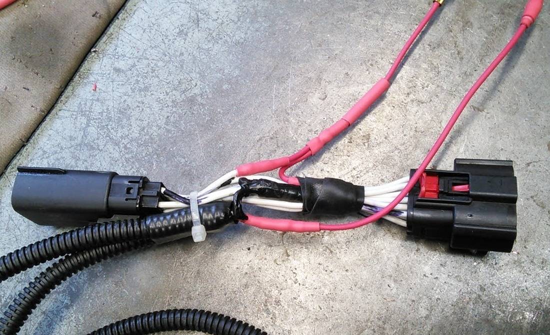

In the harness below:
Red on the right goes to power both Oracle backup lights - from the "out" of the diode above.
The red wire to the left of that goes to one of the "IN" terminals of the diode so when the truck is in reverse, that powers the oracle lights.
This setup does not power the truck's original backup lights from the aux switch, only the Oracle lights come on with my aux switch.
But that's fine with me as the bumper mounted Oracle lights are blinding anyway.
All 4 lights come on when in reverse.
