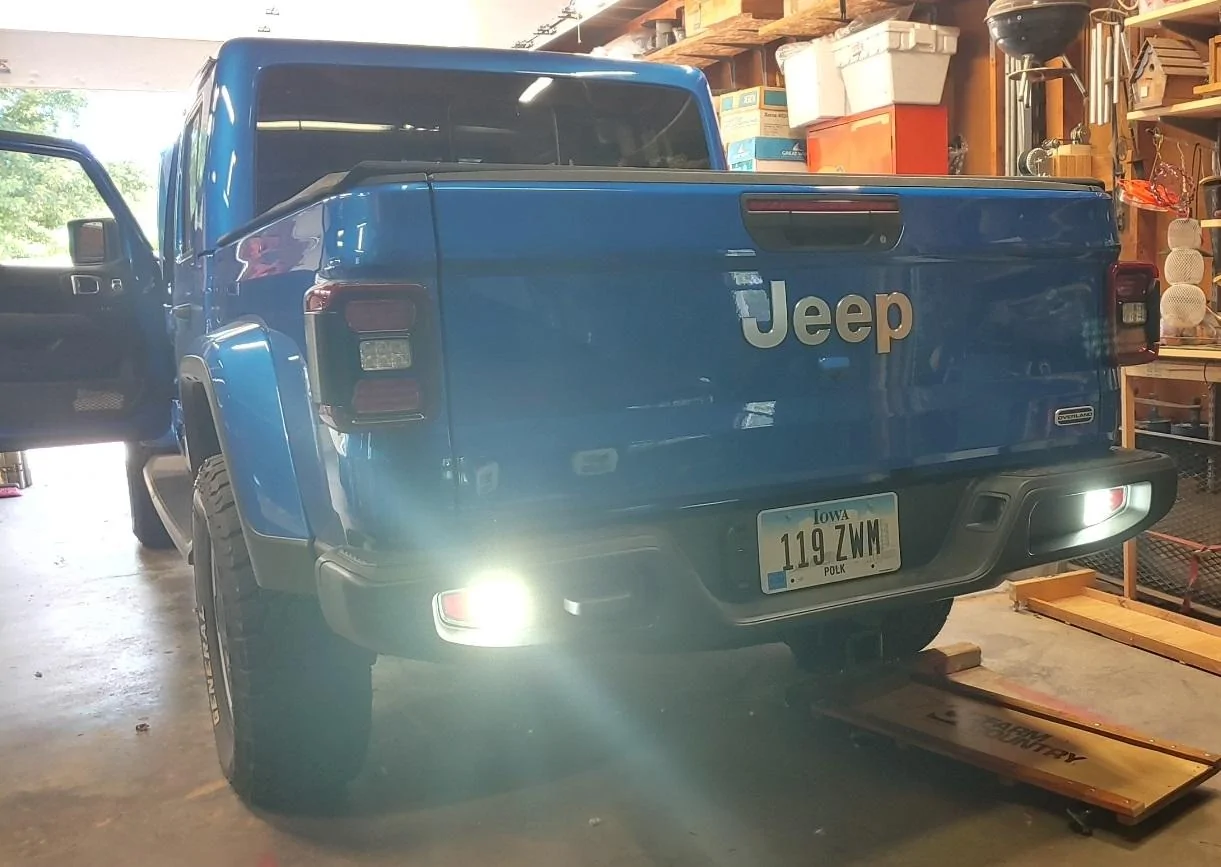

I am wondering if anybody can tell me how I can wire my rear bumper leds to come on when I put the vehicle in reverse but also hook them to my voswitch on my a pillar?

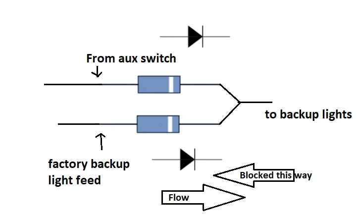

You need a couple of diodes or one of these -
https://www.amazon.com/dp/B0002UHVHI
Wire from aux switch to one of the "in" terminals, feed from truck to the other in terminal, then out goes to the red for the bumper LEDs

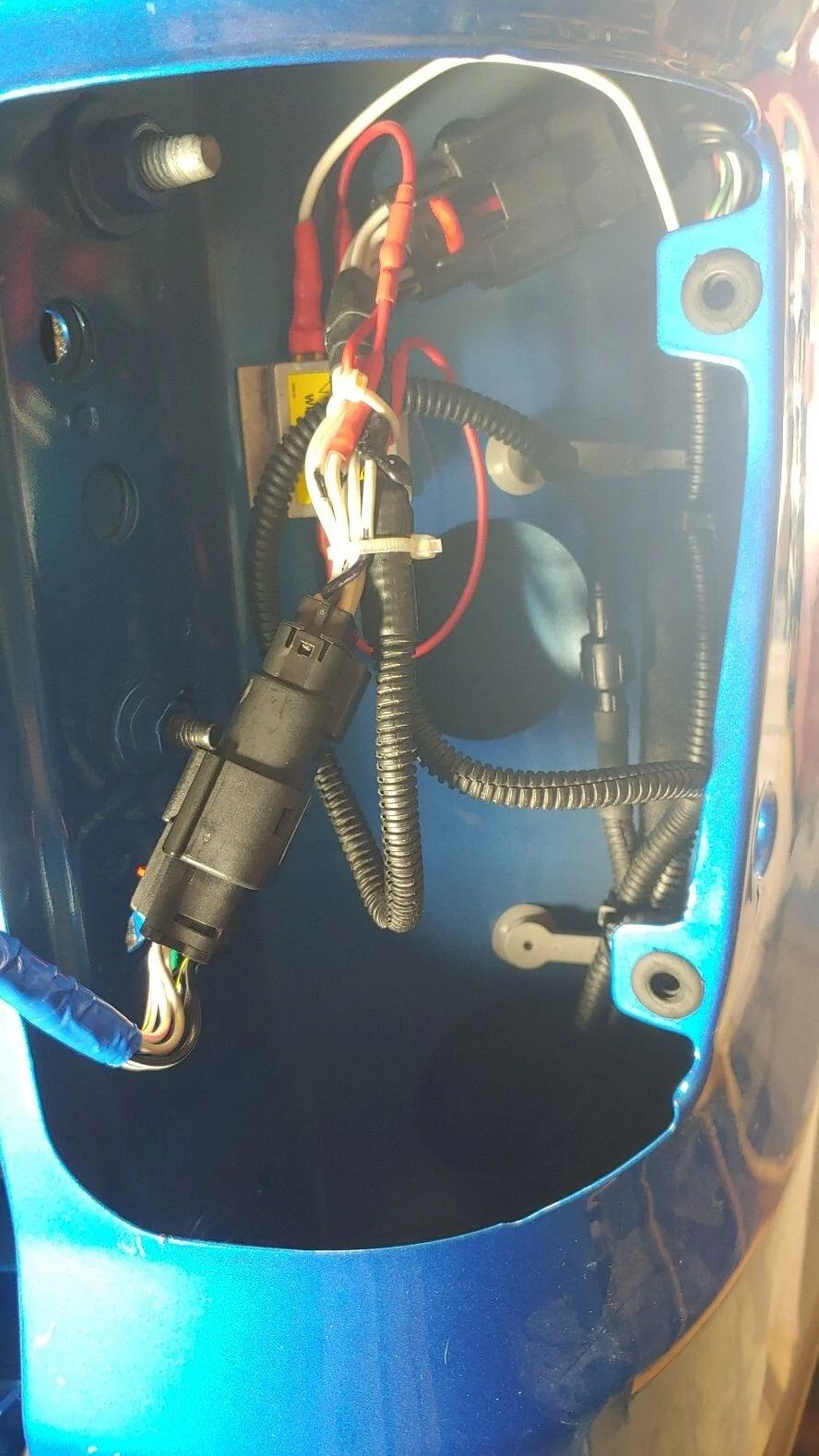

I ran the wire to the back inside the frame.

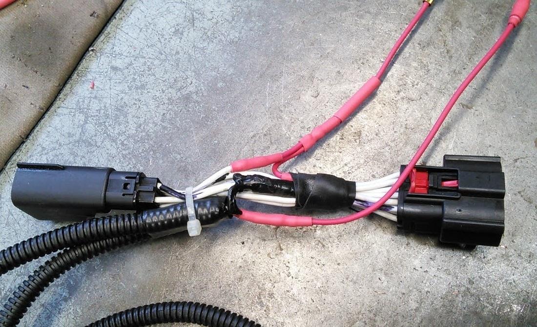

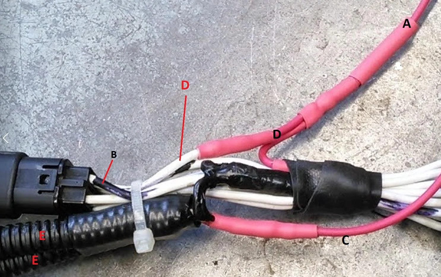

A from truck's backup light feed, to diode in.
B is led backup light ground.
C is from diode "out" to red led backup light harness
D is the wires I cut in the Oracle plug and play harness - it's the feed for the factory backup lights.
E is the harnesses to the Oracle backup lights.
