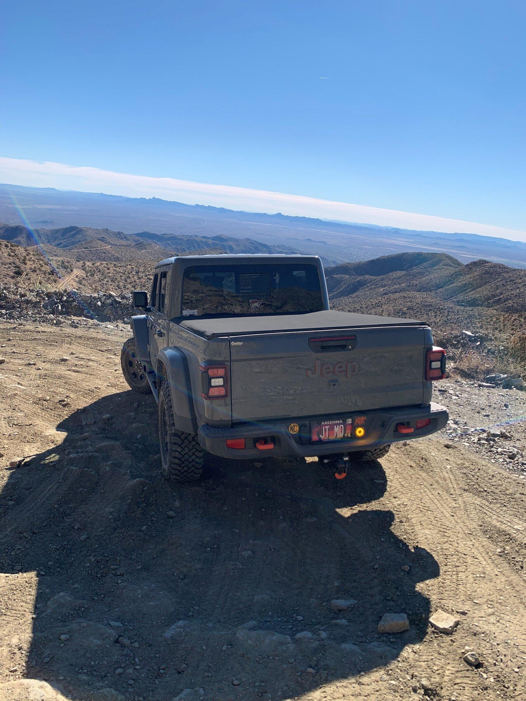

Jeep Gladiator Auxiliary LED Reverse Lights (Integrated Rear Bumper) Harquahala_JT_rear
LostWoods
Mar 13, 2020
2,027
2,420
Gilbert, AZ
2024 4Runner / 1995 YJ
I didn’t know about these, and love KC stuff. Thanks. I’m tempted to use them for rock lights. If anyone has used them for rock lights, and they sell a set of 6 for this, where are people mounting them?
They are ideal for rock or camp lights IMO. I have a bunch of them and they've all been solid but I will say the amber and especially the red suffer from loss due to the lens. Works for me because red camp lights work great at night but I would not be using them for dust lights or anything like that unless you are running a few together. That is, unless the new v2 ones are brighter in practice than the v1 that I have.
