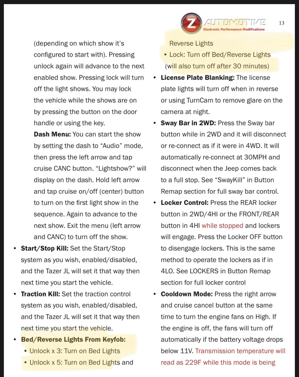

I planned on hooking it up to a switch with diodes but with the tazer install and hook up to reverse lights if you press the unlock 3 or 4 times it turns on the reverse lights. Hit lock to turn them off. That’s how I’ve been turning them on and off when loading or doing anything behind the car.
Very cool. I didn’t know that. I’m getting a Tazer soon to reprogram gearing and tire size. Maybe I’ll reclaim an aux switch if that works well.
yup! I found out by accident hitting the unlock button too many times but here it is in the user guide. This Tazer has so much to it.
Jeep Gladiator Auxiliary LED Reverse Lights (Integrated Rear Bumper) CD253628-9BE1-4714-9AB6-D65AD537A994
