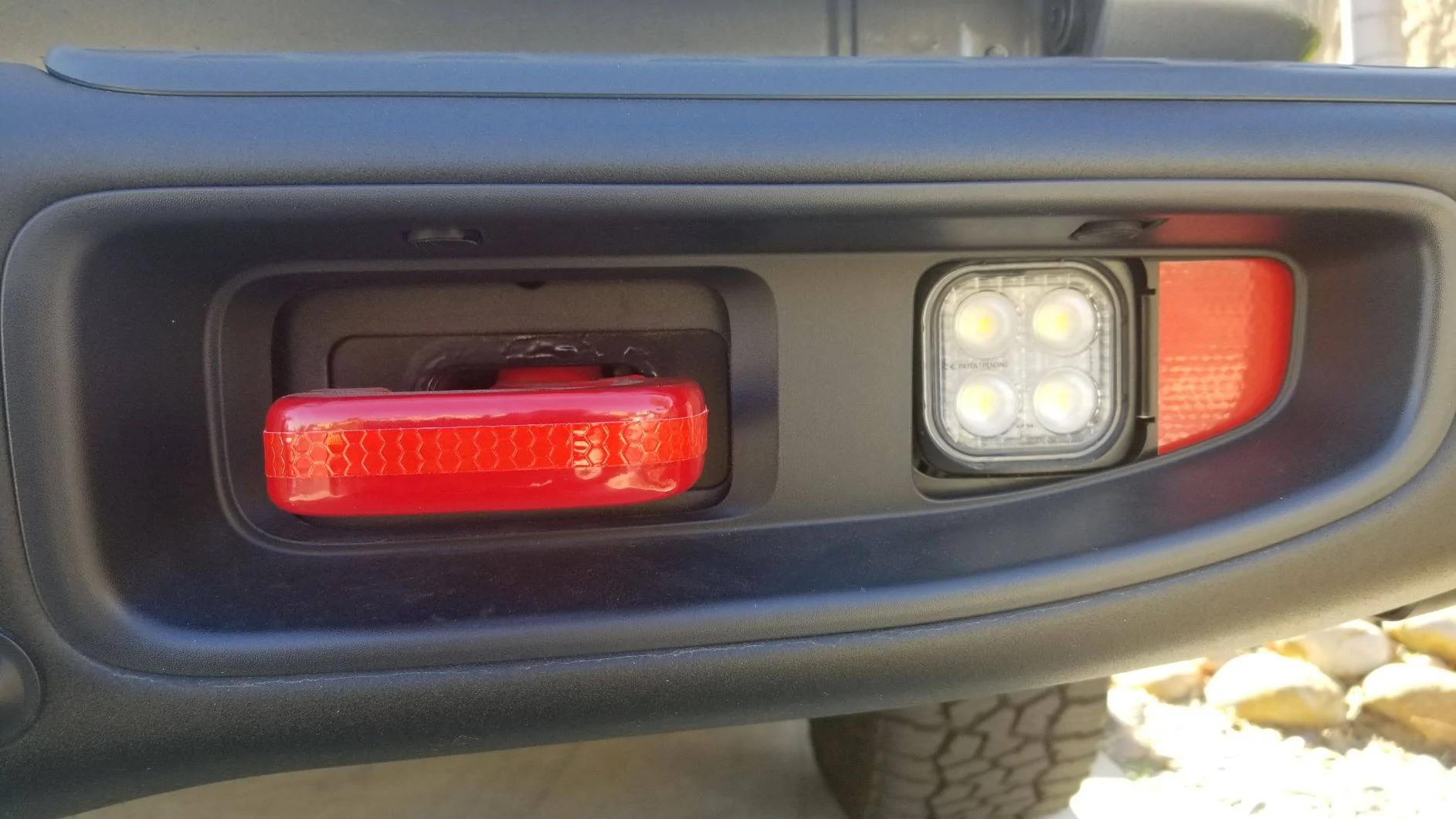

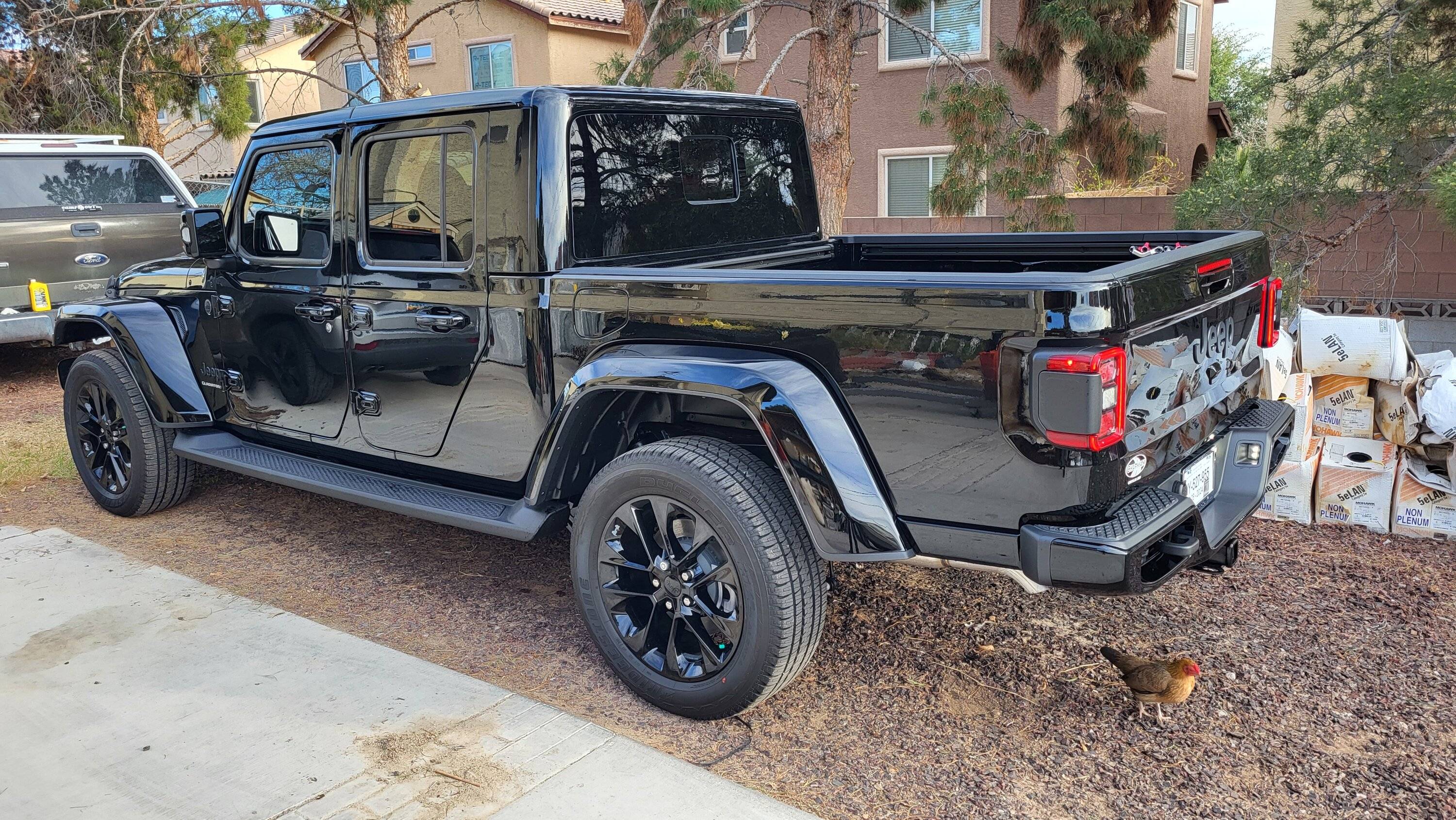

OK, how the hell is your camera that clean and clear at night. LOL I swear anytime Ive wanted to use it at night for backing up, its nothing but dirt bubbles.
lol it was just washed, look at the paint in the other photos.

Nice bit is they keep compliance with federal and CA regs on rear reflectors (probably barely, but no inspector can crap on you about it)
They are bright as heck.
So it looks like you have perhaps 2 or 3 options anyway. You can choose whatever would work best for you or however you wish to wire - which may be using that trailer connector pigtail again for simplicity.

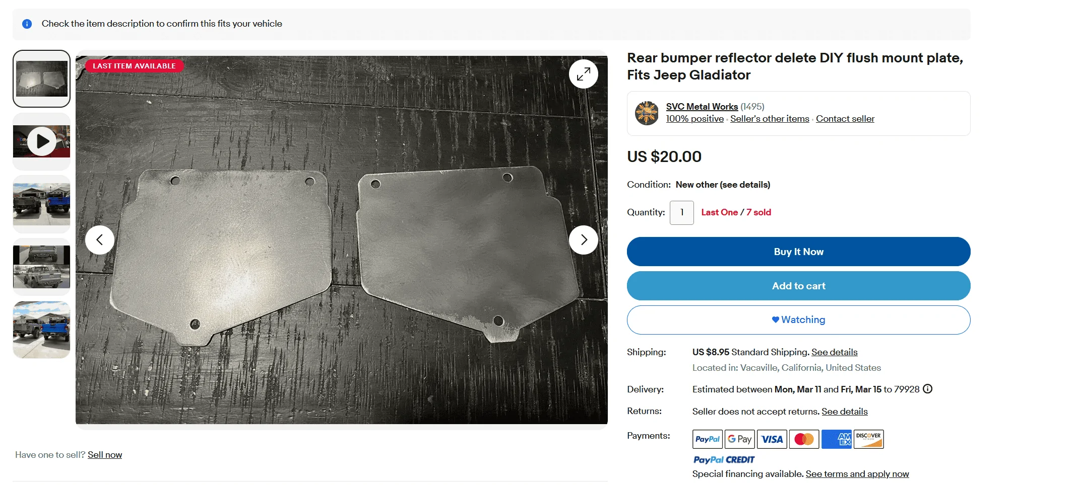

If you don't mind doing some leg work, you can mount whatever flush mount lights will fit in the bumper with this reflector delete kit. Just mark and drill your holes, and paint or powder-coat the plates afterwards.
I had a set of Rigid ignites on my old Go-Rhino bumper that would work with these for referance.
I may go this route. Some red reflection tape and a set of surface mount lights should be fairly easy to do.

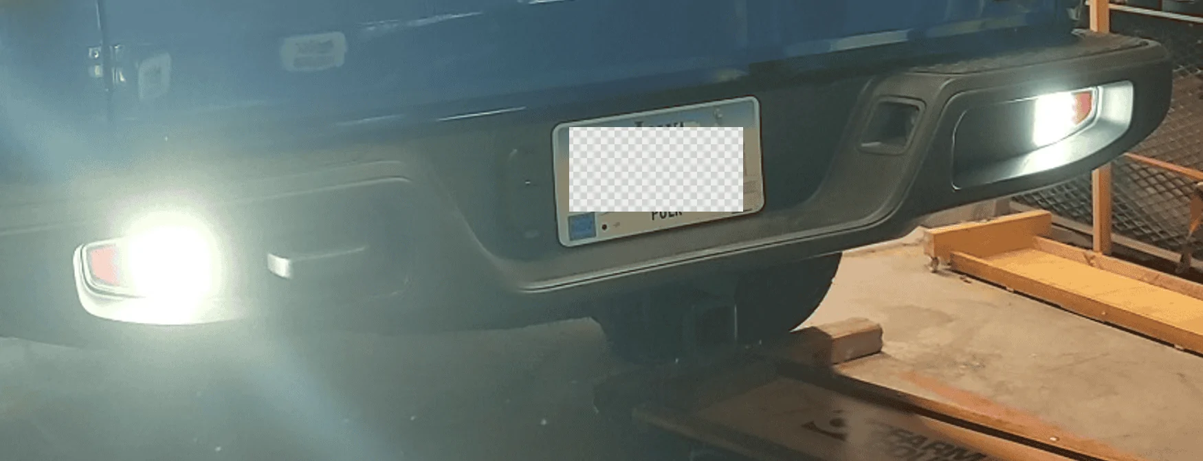

I've have oracle as well. Took them off last Gladiator and put them on my new one. No issues. I thought the issue people were having is they did not have LED lights and were getting an error.

I have no issues with my oracle reverse lights after almost a year.
40,442
53,859
Mine were put into my 2020 on July 2nd, 2021. They stayed there until July 2022 when I moved them over to my 2022.
So............. will be 3 years total this July.
That's considering they were removed and reinstalled as well.

I too really like my Oracle lights.

Just installed the Oracle lights a month ago, good so far, easy swap from factory reflectors

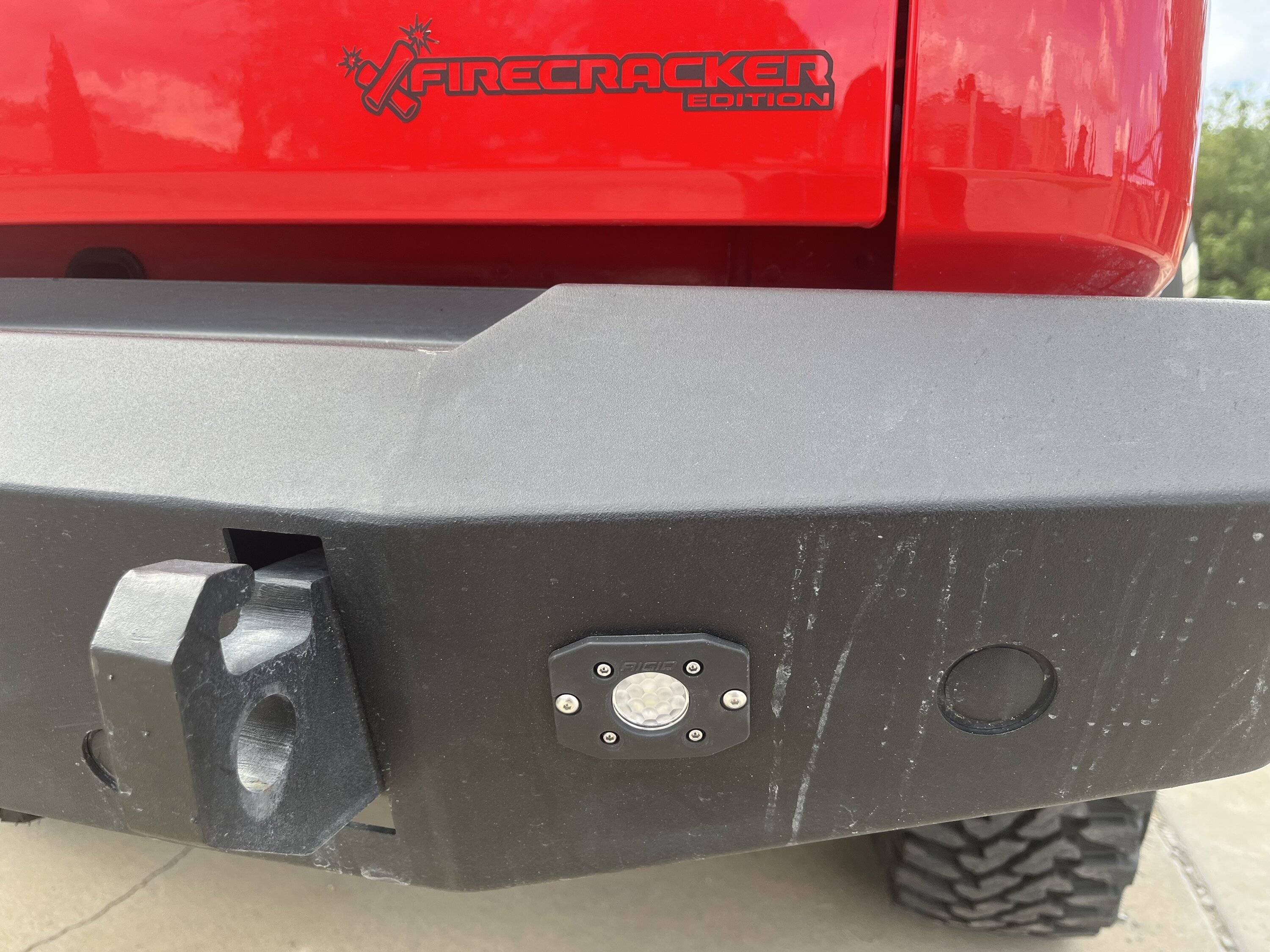

Jeep Gladiator Bumper Reverse Lights IMG_0231
Badweather
Mark
Aug 21, 2022
171
124
Oshkosh WI
2022 Mojave
Engineer

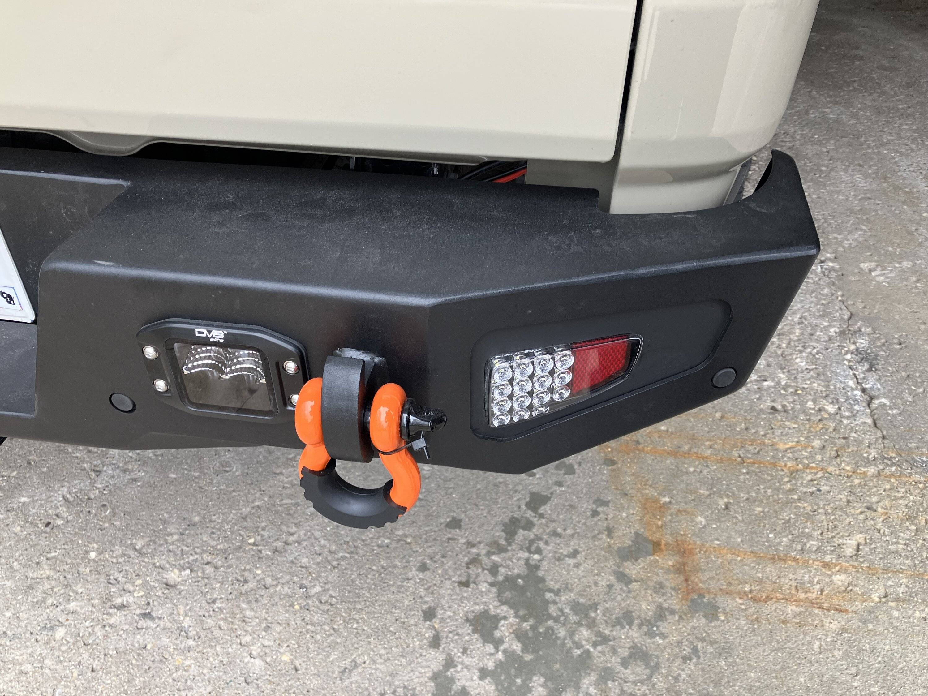

The above is my solution for backup lights. It is a Mopar steel bumper but I have lots of lights when needed.
