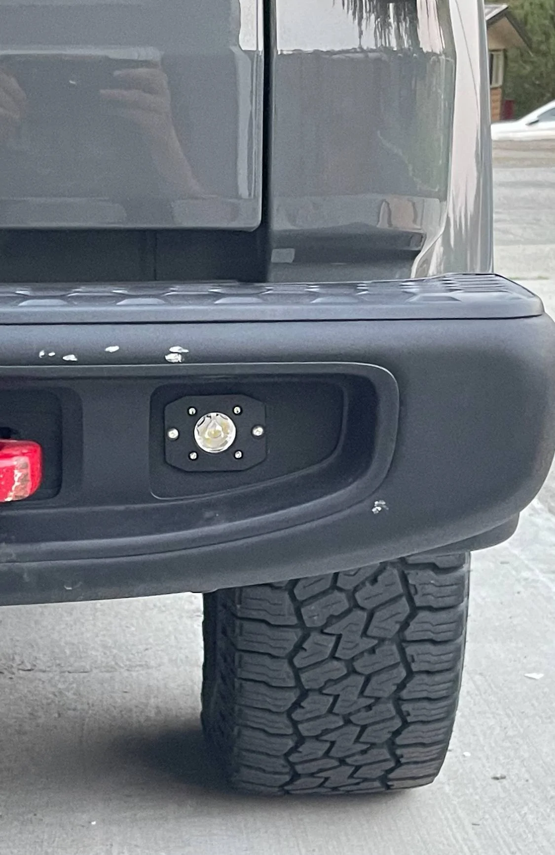

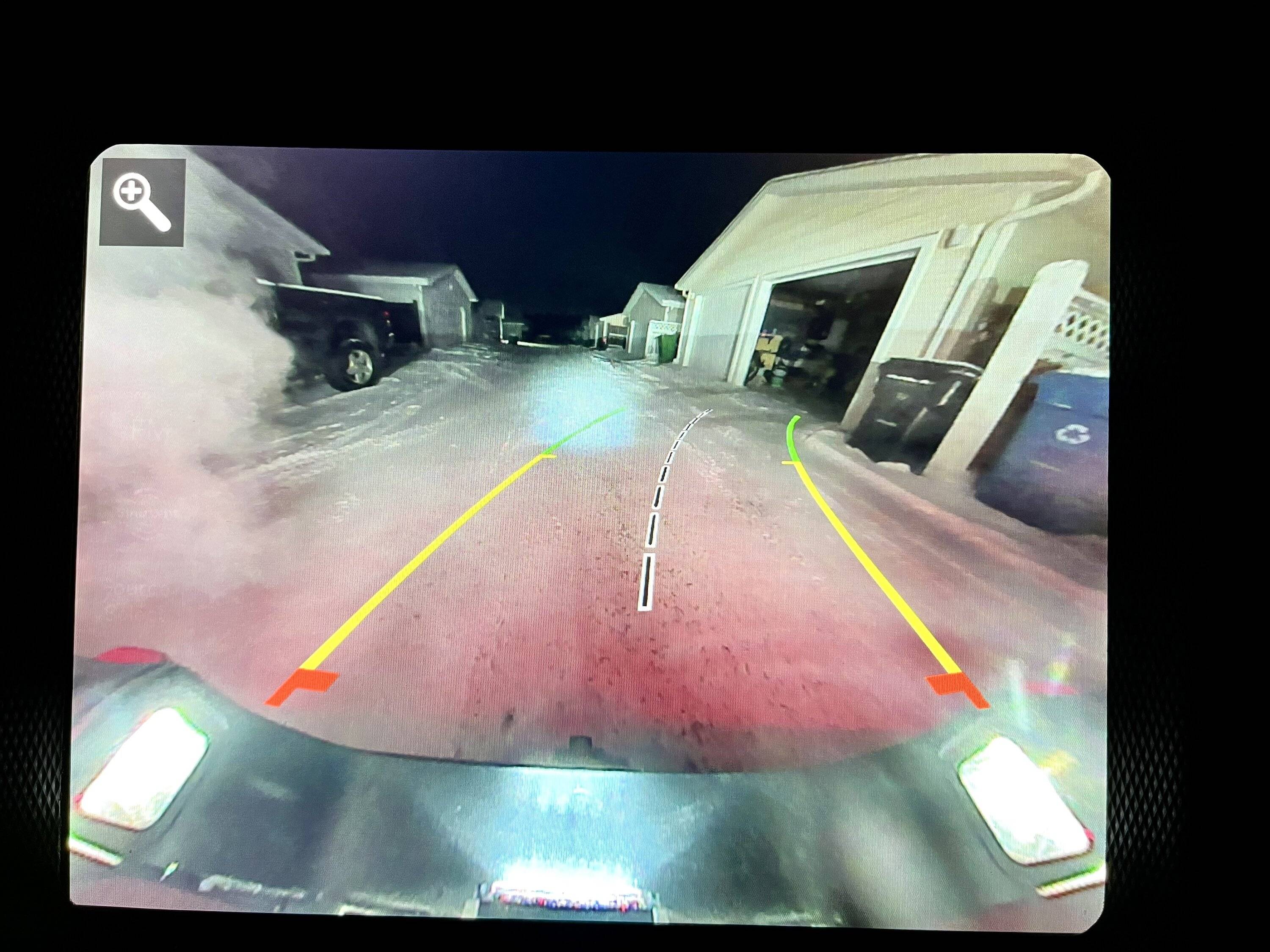

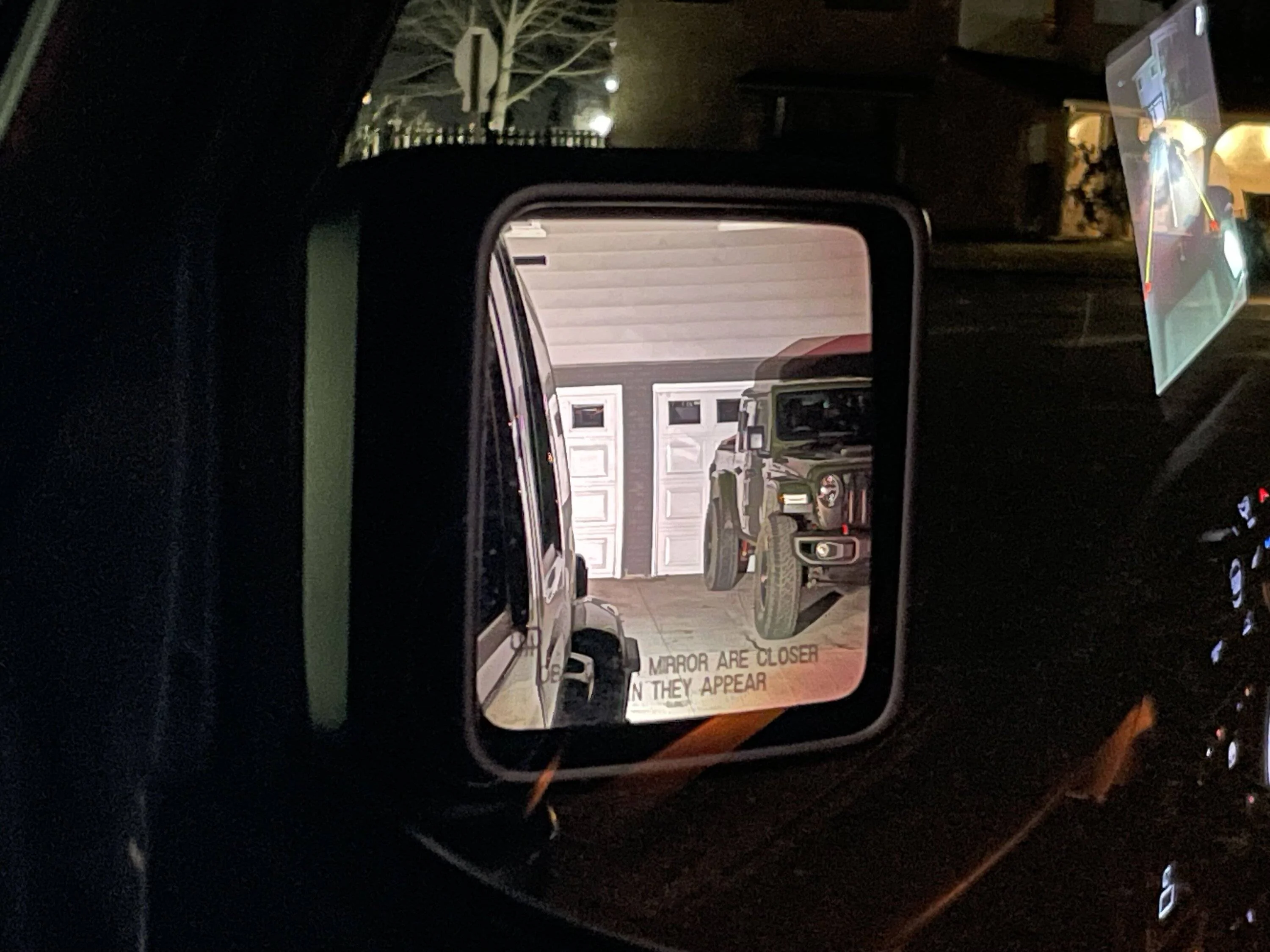

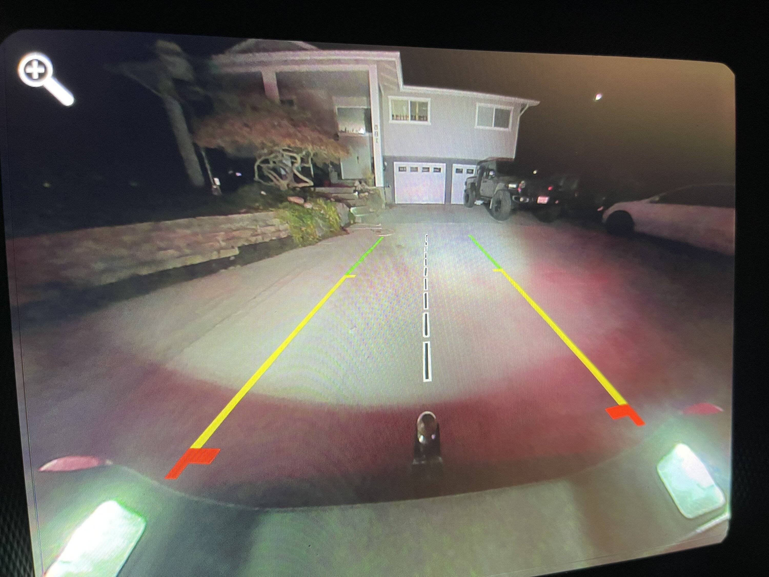

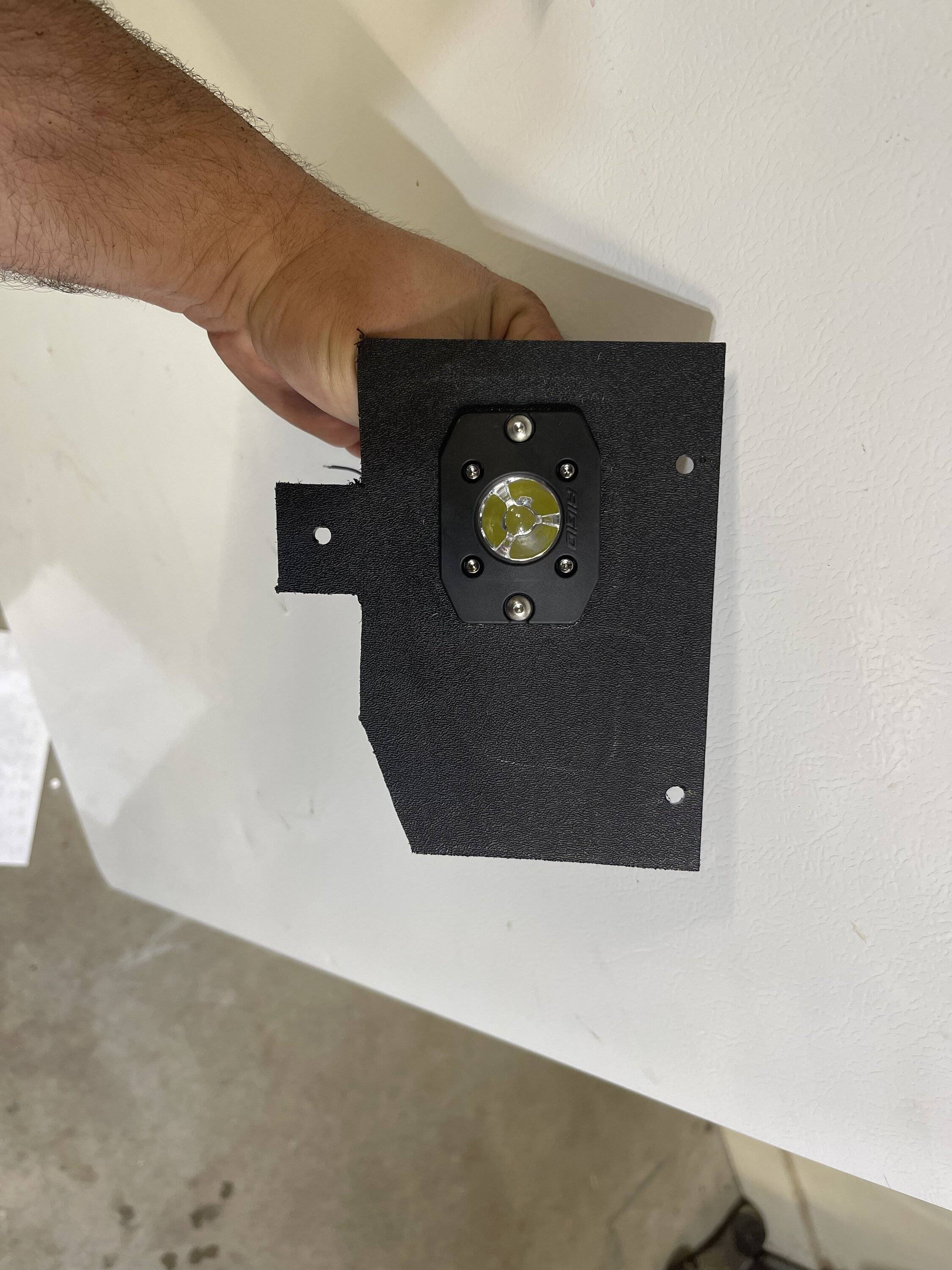

I mounted some rigid ignite series in a diy plastic cut out. Tapped into the trailer harness with a 1 second delay relay (doesn’t light up when shifting from park to drive… must be in reverse for a moment), with a manual override switch.
spot light on the passenger side, flood diffused on driver- works great in the mirrors and wonderful in the camera as well.

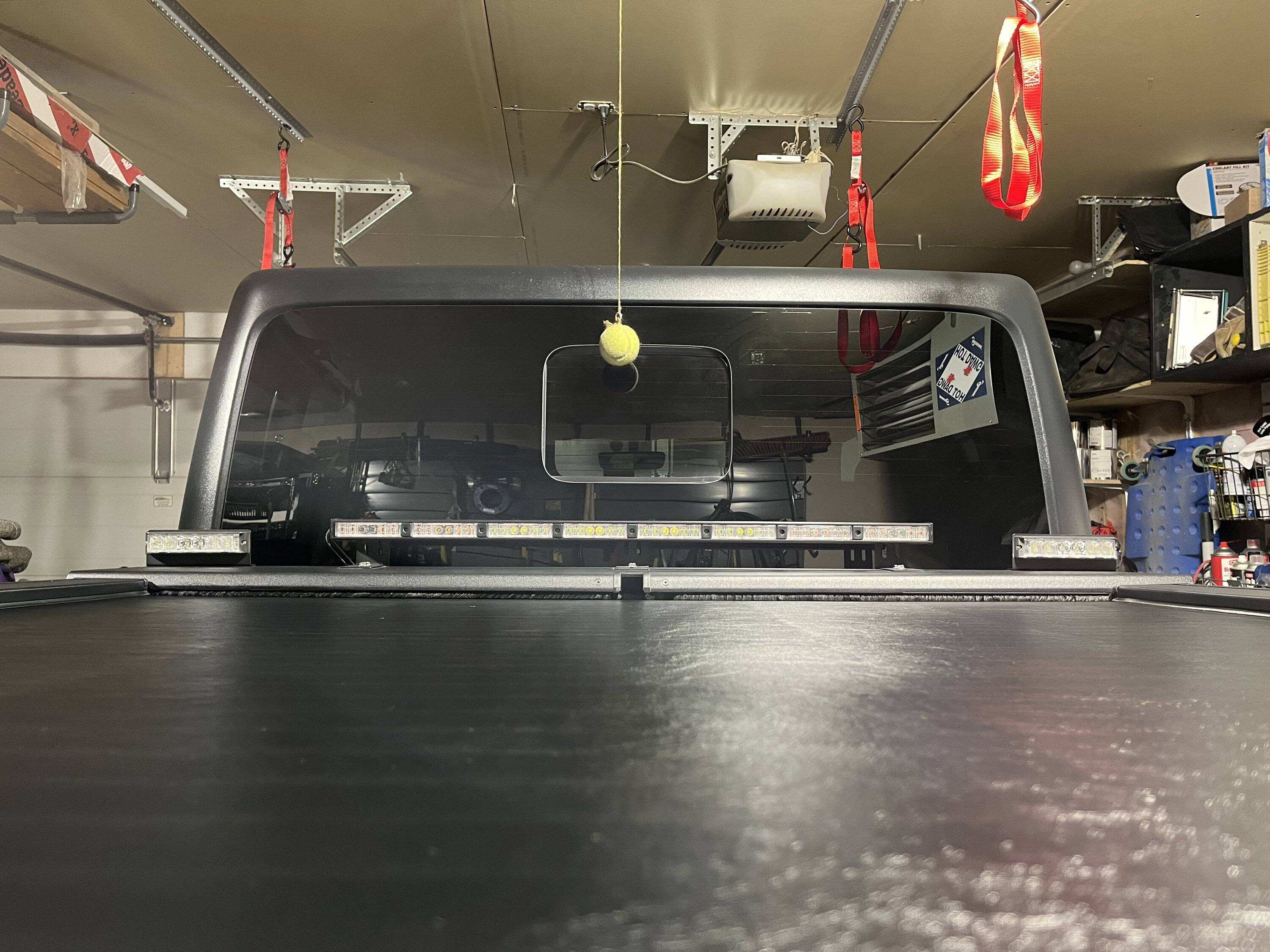

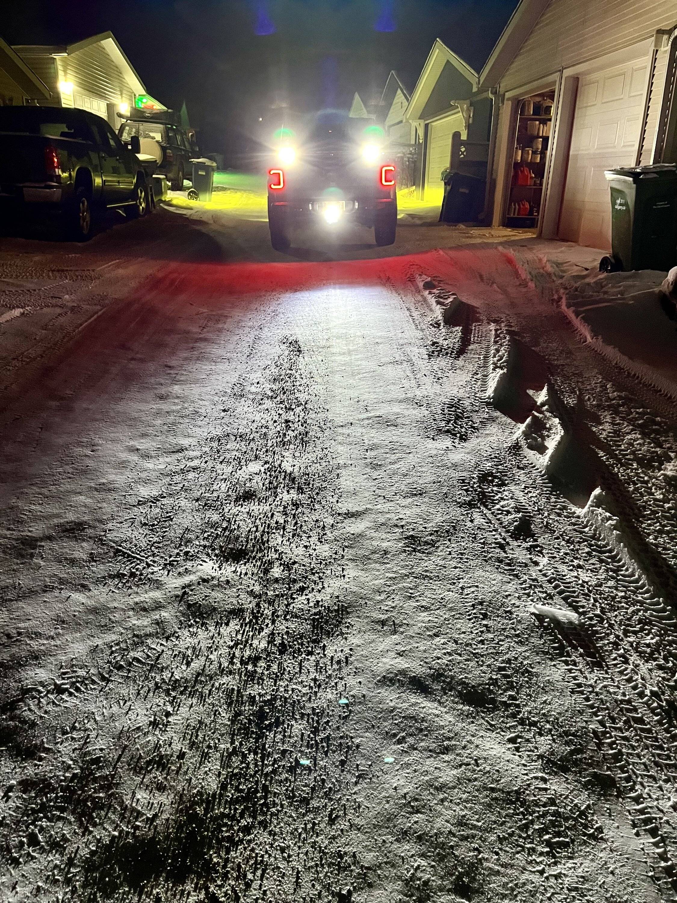

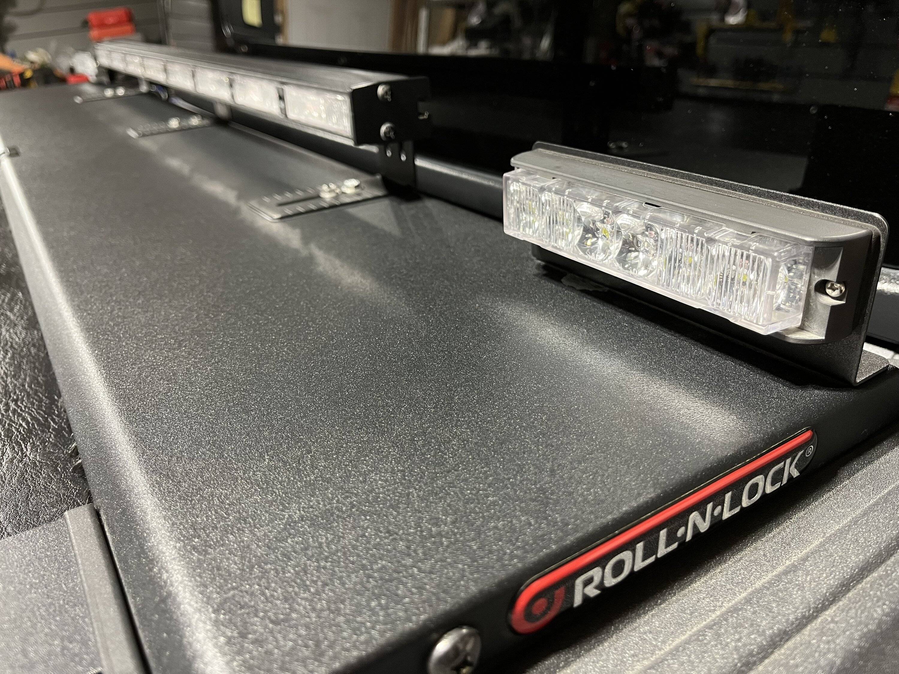

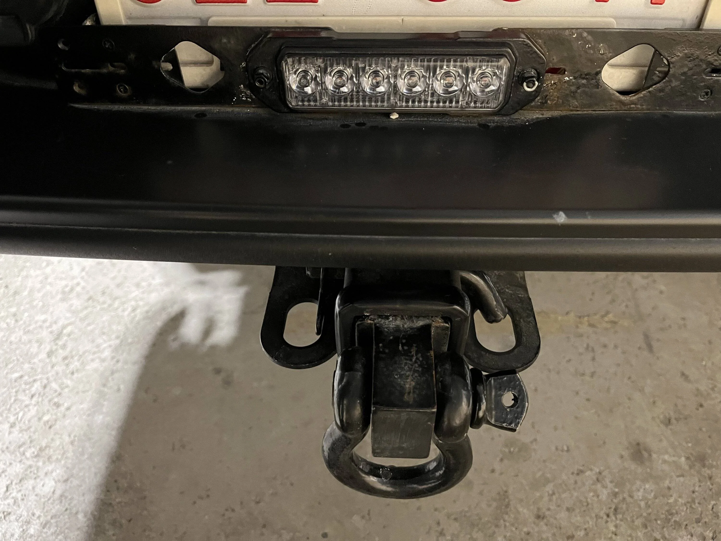

I wired these up to my trigger 6 unit. These three have duel purpose. When I active my rear emergency road side recovery strobes the two up top are solid red flood. The one at the bottom strobes amber/clear. I also have a strobe light bar up top between the two lights.
When I need more solid flood lighting for backing up, a different switch just has them as solid clear.
These are from https://www.strobesnmore.com/Strobes-N-More-E6-Dual-Color-LED-Lighthead_p_6256.html

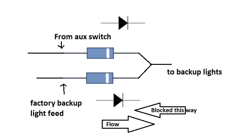

Did you explain somewhere how you wired them up to the switch?
It's here somewhere..........

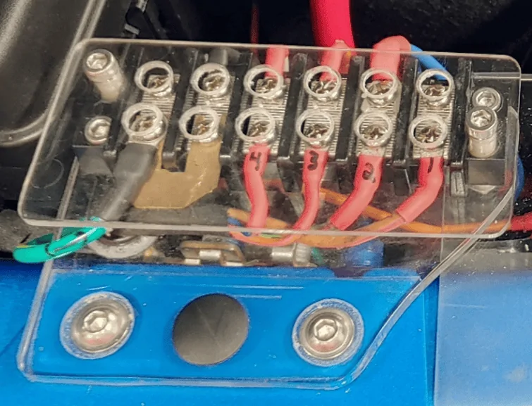

I ran a wire back from my aux switch terminal block next to the battery to a diode behind the right tail light.
I modified the Oracle plug and play harness so the power from that went to another leg on the diode array.
Then a wire from the "out" of the diode goes to the bumper backup lights.
This is how it would look "schematically speaking"

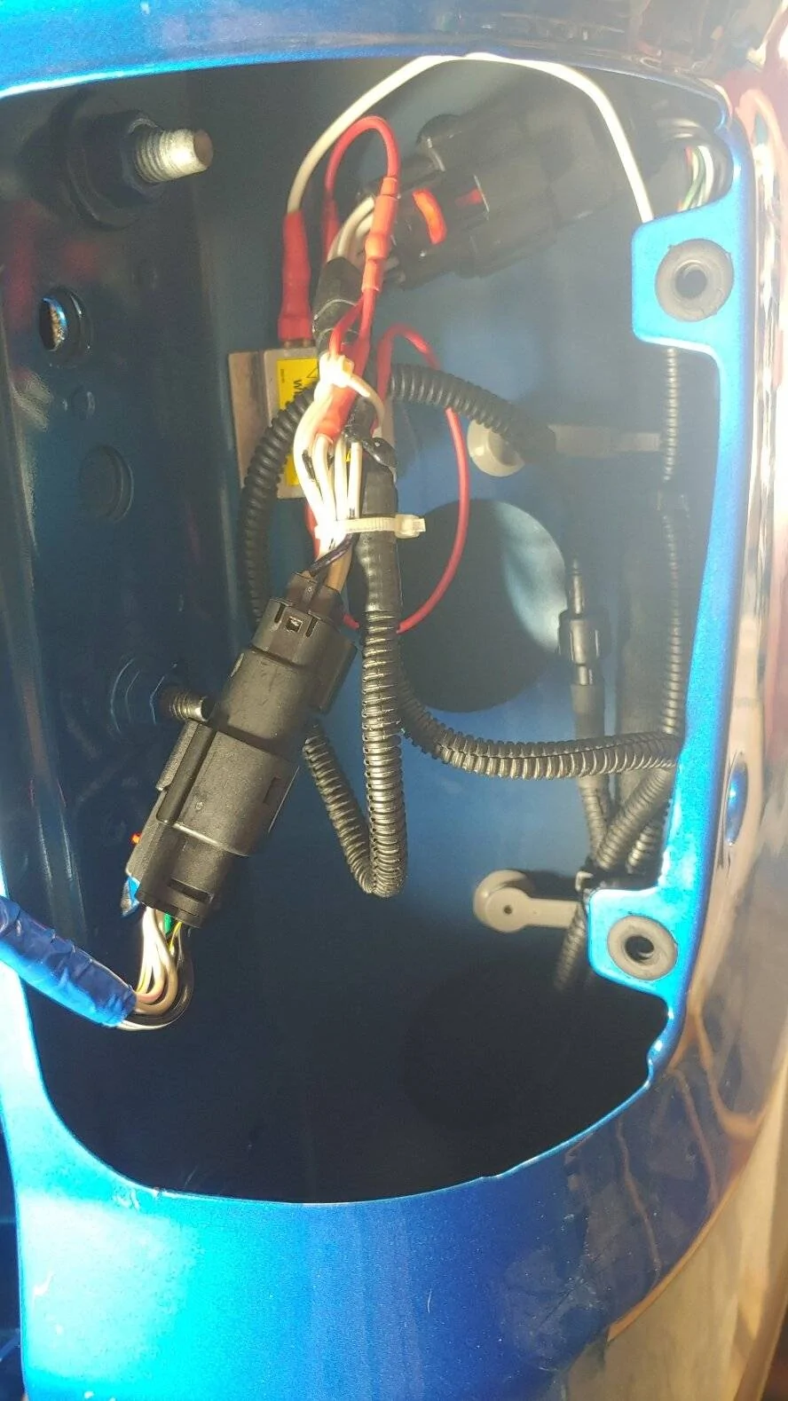

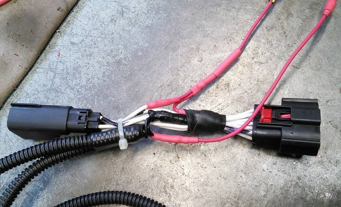

My mod to the harness - the single red wire on the right comes from the diode "out" and runs to the Oracle harness that goes to the lights.
The wire on the left going up goes from the Oracle plug and play harness to one of the diode "inputs".
I left the Oracle light ground lead in this pigtail alone.
Jeep Gladiator Brighter Backup Lights IMG_20220724_115758
I tidied it up a bit from this.............. the white wire is what comes from the aux switch wiring up by the battery (where I have a terminal block)

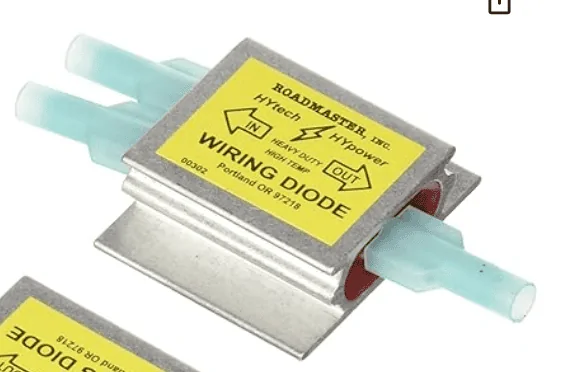

This is the diode I used (from Amazon) ->

White wire in pic going to diode comes from #4 here ->
Jeep Gladiator Brighter Backup Lights 1705290629655

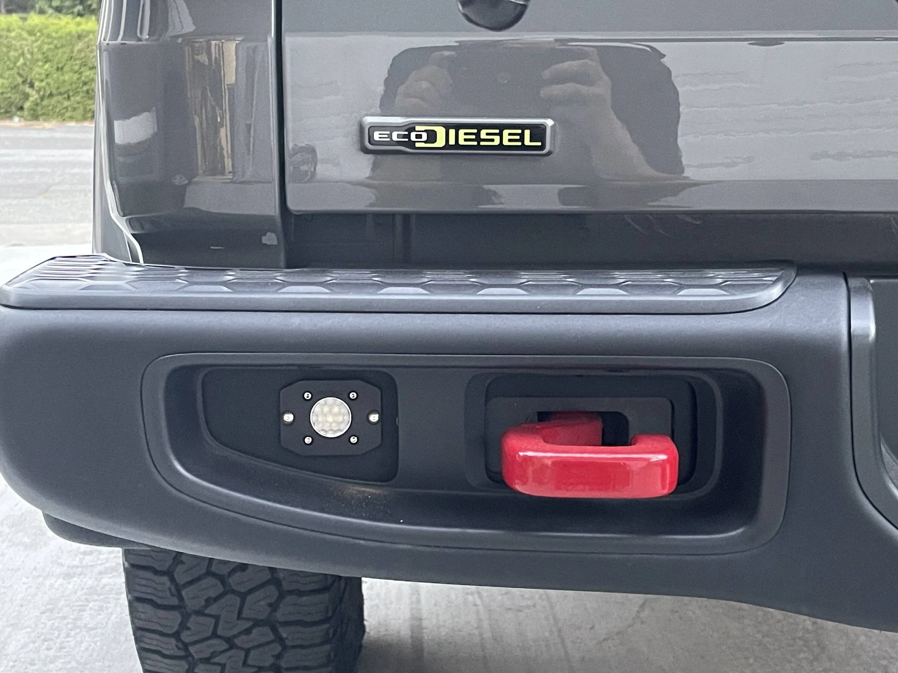

I wired mine in so they come on in reverse, and also to one of the auxiliary switches so I can run them any time I want, even with the truck off and in park. (that's why you don't see the factory tail and backup lights on in this pic)
They come on with the factory reverse lights, or when I use an aux switch to turn them on.
I've had these in two JTs now and would do it again.

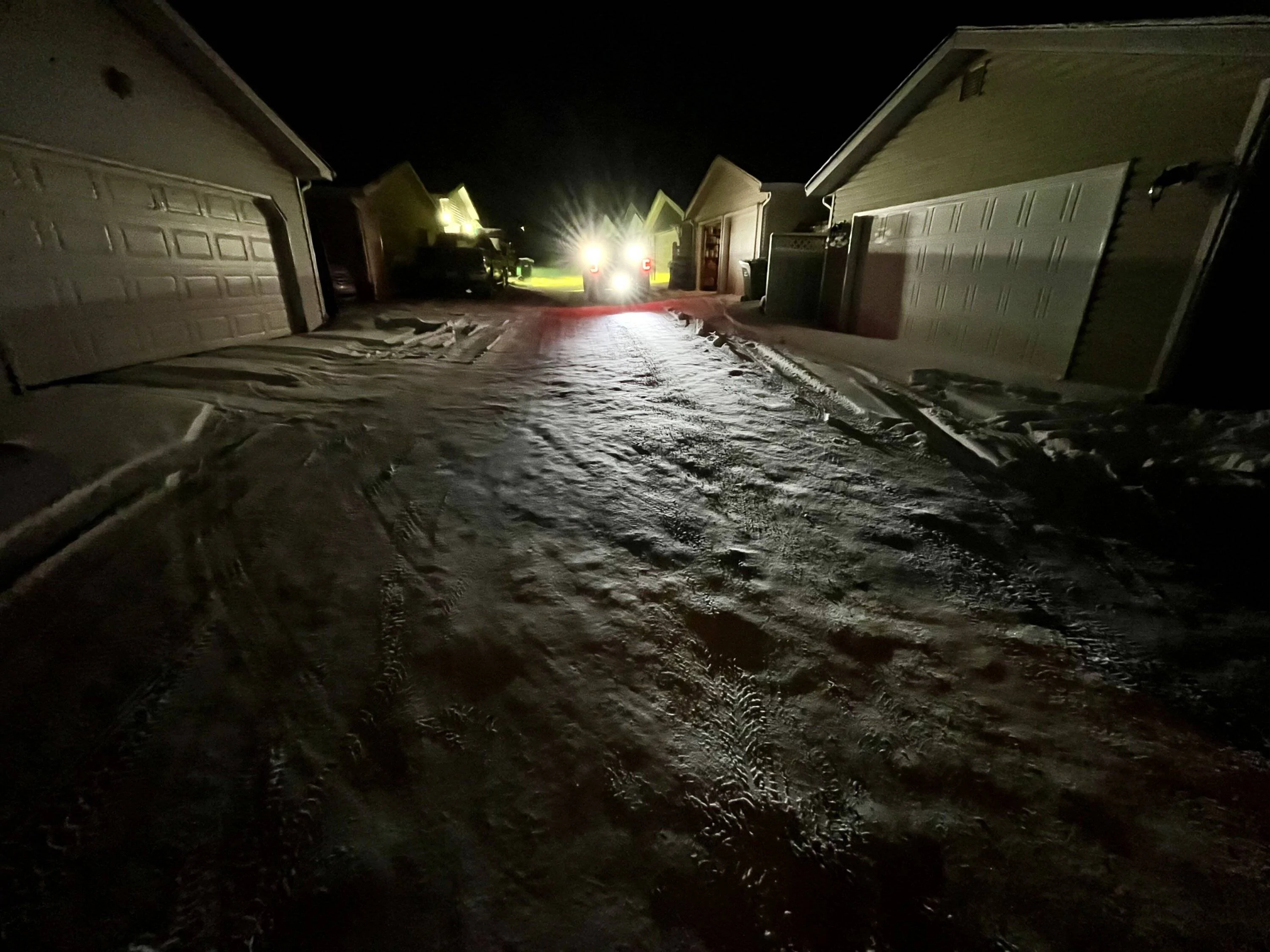

This picture was taken about mid-morning with the morning sun shining in that east window and the garage lights on. What you see is the white shadow cast by the Oracle backup lights in my JT's bumper sitting about 20 feet in front of the car.
