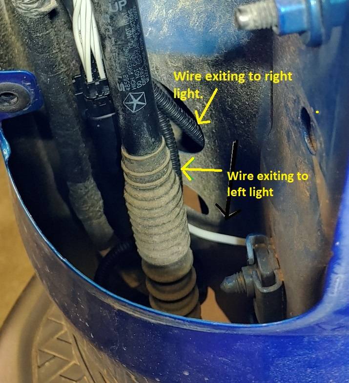

Is it necessary to remove the bumper to install the oracle lights?
Nope, like they said. And just remove a tail light (easy, 2 screws) to plug in their plug'n'play harness.
It's a pretty quick install.
This is what you see behind the tail light. The white wires are part of the Oracle harness if you go that route.
It all just plugs into the stock factory wiring this way. No splicing, no cutting, no taps unless you choose that method.

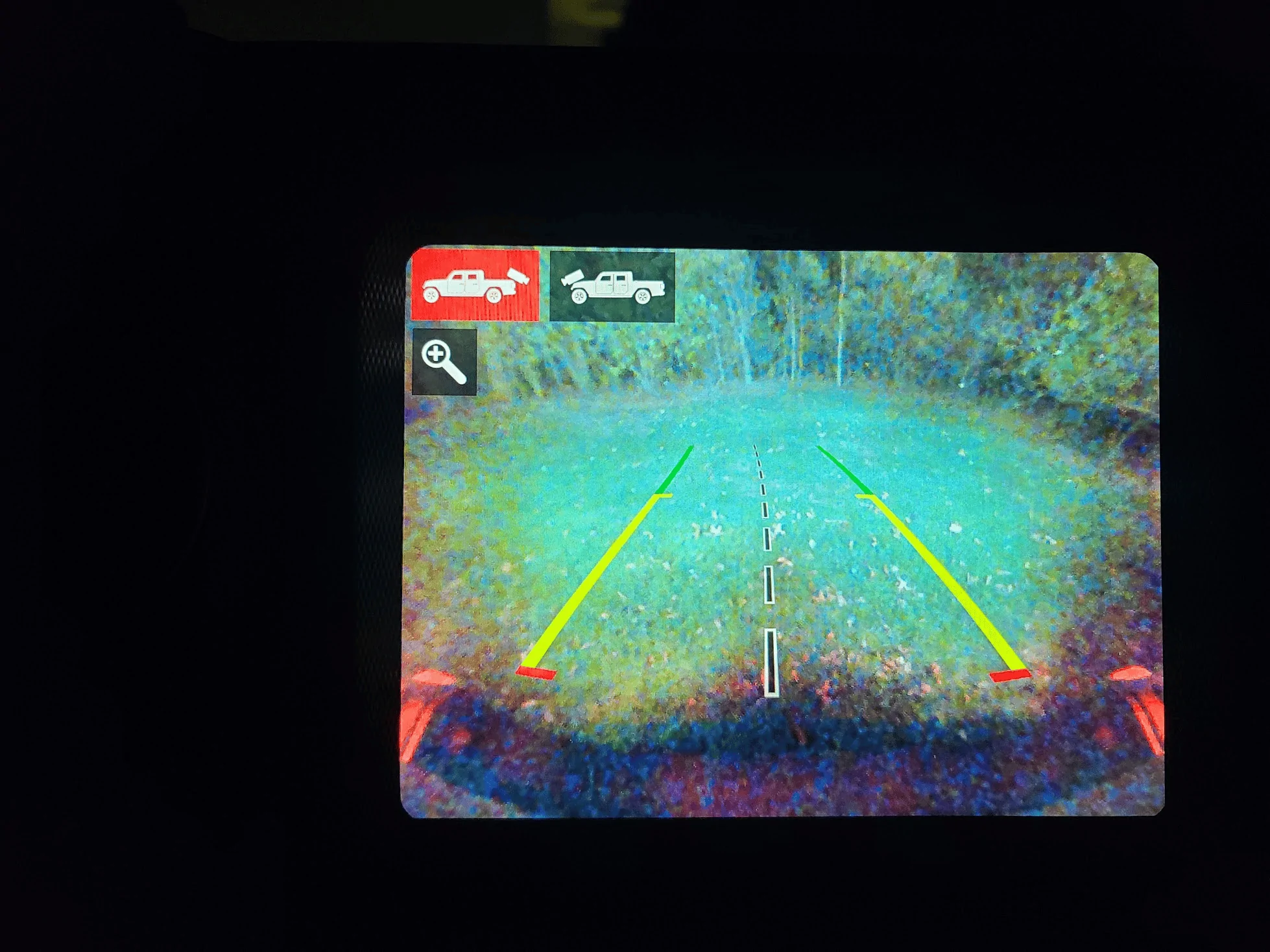

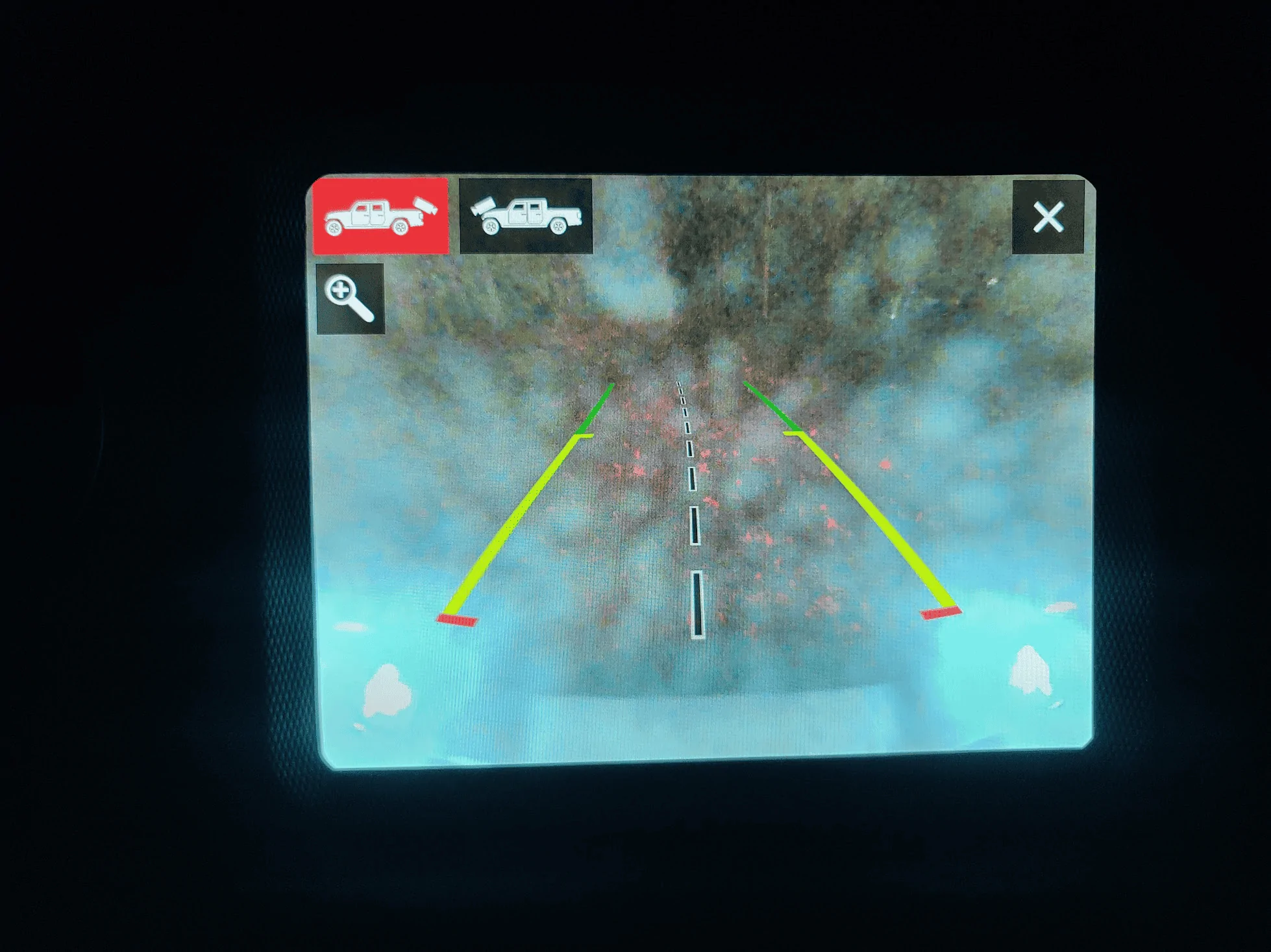

I just wired a bypass with a relay so that when the reverse lights come on, the license plate lights turn off. Makes a world of difference for about $15 in parts.
Yes, I still need to do a write up on it.
Another forum member was selling these pre-made, but I can't remember who..
Before:
Jeep Gladiator Brighter Backup Lights 1705259388401
After:
Jeep Gladiator Brighter Backup Lights 1705259409053
Before:
After:
Dang, dude - clean that camera off and it will also make a world of difference! ?

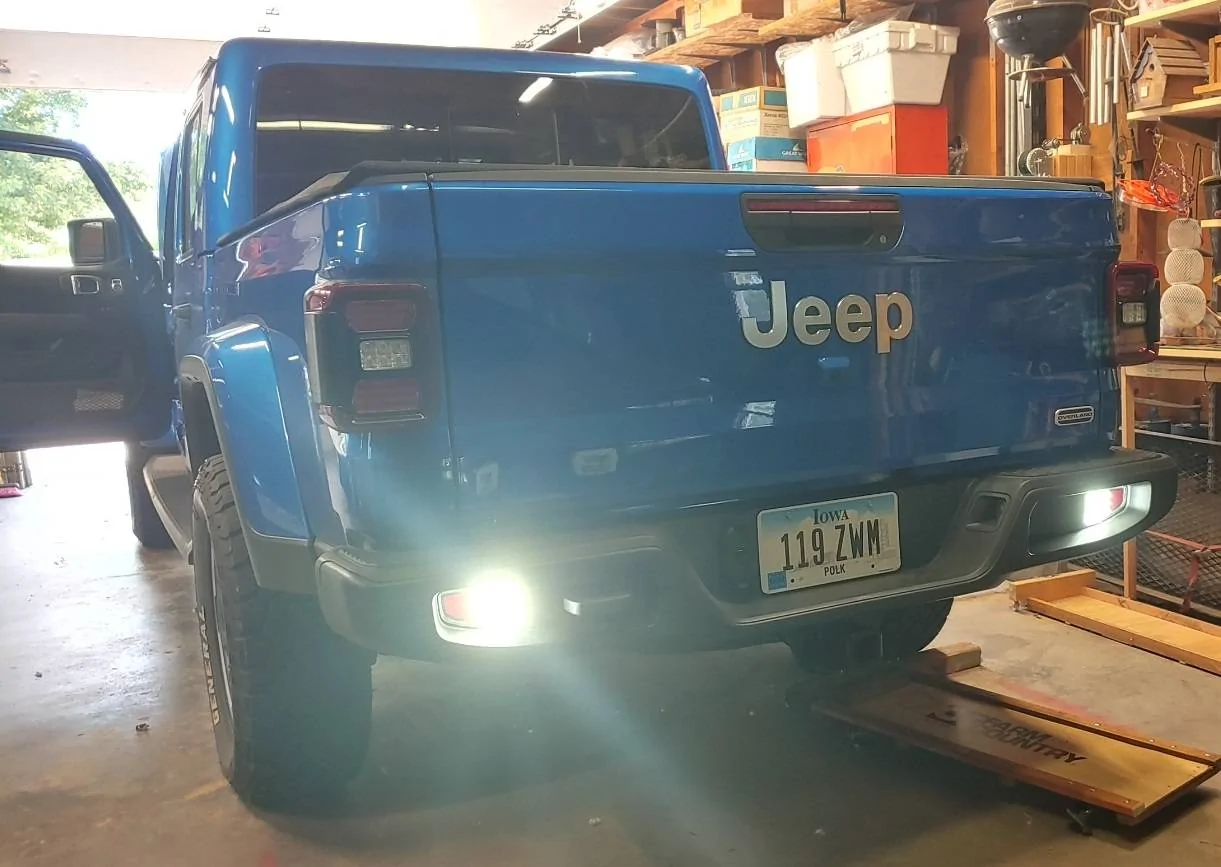

I wired mine in so they come on in reverse, and also to one of the auxiliary switches so I can run them any time I want, even with the truck off and in park. (that's why you don't see the factory tail and backup lights on in this pic)
They come on with the factory reverse lights, or when I use an aux switch to turn them on.
I've had these in two JTs now and would do it again.
This picture was taken about mid-morning with the morning sun shining in that east window and the garage lights on. What you see is the white shadow cast by the Oracle backup lights in my JT's bumper sitting about 20 feet in front of the car.
