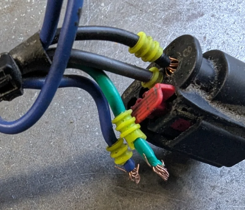

Too bad he doesn't use the right wire size for the pins or the right crimp tool.
He needs to cut the wire size down, or get a new crimp tool.

Too bad he doesn't use the right wire side for the pins or the right crimp tool.

That one literally fell apart after a few weeks.
One look at the wires and you can see what happened. The heavy copper strands are a mess.
Thus, me collecting the parts and putting my own together - might not finish the project since so far, my 25 hasn't had a problem.
With a much smaller relay and smaller wires since the license plate lights don't carry any real amperage, the wires could be a lot more flexible and fit in those little pins more easily.
The wires used could carry the full load of old-fashioned headlights.
I'd suggest 18 gauge tops, even 20, and silicone wire.
unless you take it apart - you'll not see what this one shows. Might hold, this one didn't. It literally fell apart with no help at all.
Sure it was the same seller? Guy sells other harnesses for doing the door proximity and electric door lock conversions that seem pretty well received also.
I did not go all American Tourister Gorilla on my harness when I received it but it seemed pretty well built. Sorry to hear yours did not pan out.
I used a link in the forum.............
I'd have to look at my eBay history. Swear to it? No, but do recall following a link in the forum.
I decided to let my own version sit and try something fast instead (parts for my version still sitting in a bag in my Jeep parts cabinet)
I had my 22 in the dealership for something - and they came to me and asked "did you know your license plate lights don't work"? (I guess some evidence they actually DO check things LOL)
Told them I'd take care of it (assuming maybe the relay failed?) and looked under the truck, and the wires were pulling out.
I've not seen anyone else with problems or complaints, so I just decided to move on and if I wanted one in my 25, I'd finish what I started a couple of years ago with the smaller relay, silicone wires, etc.
Not a priority.

.................and if I wanted one in my 25, I'd finish what I started a couple of years ago with the smaller relay, silicone wires, etc.
Not a priority.
Debating doing my own also mainly because I am cheap. If decide to do it myself, probably just going to hard splice it in rather deal with sourcing pass through connectors.
A whole lot easier - marine heat shrink and good joints it would be easy that way. (and cheap)
