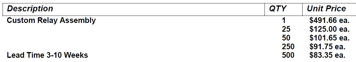

You may want to consider what goes into creating something like this before judging the selling price as too high.
1. the parts alone for each harness cost $32.39 not counting crimping pliers and other small tools
2. the hours spent trying out the idea and making corrections to it until it's as perfect as I'm capable of getting it.
3. the time to write the narrative and take photos for the 10 page color illustrated installation pages
4. the research time that went into determining the exact connector, terminal gauge/cavity sizes, appropriate plugs, seals, blanks to keep the water tight integrity of the connectors the same as the ones that the bypass-light cancel harness mates with.
5. the idea itself, you may be able to get the parts to make one but you'd be copying my idea and design
6. the labor to assemble one which is about 45-60 minutes
I put out request for quotes to 6 wiring harness assembly companies. The best quote I got back was this:
Jeep Gladiator Back up camera at night… 1642093045741
All things considered I think $60 is better than reasonable. I have a full time job but do these projects because I make them for myself and then, if it's good enough for me, try to share it with others without losing money and at the same time getting paid a small amount for my time.

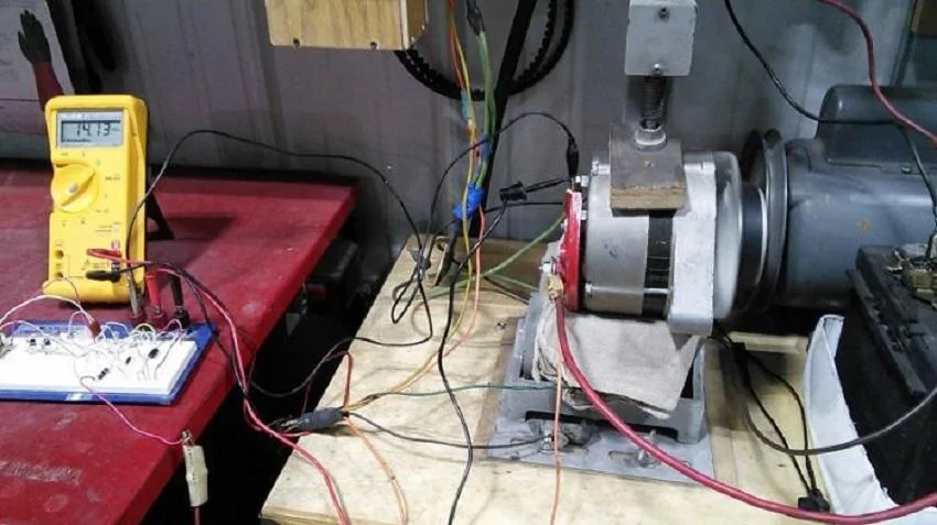

I'd absolutely want a diode-protected relay in these lighting systems otherwise dropping current through the coil can cause a reverse spike. I'd use no other type on my Jeep. Diode across coil connections 85 and 86.
Even my cruise circuit has a relay with the internal diode across the coil to protect the circuit it's in. I didn't want to cause issues with the PCM I'm using in that car.

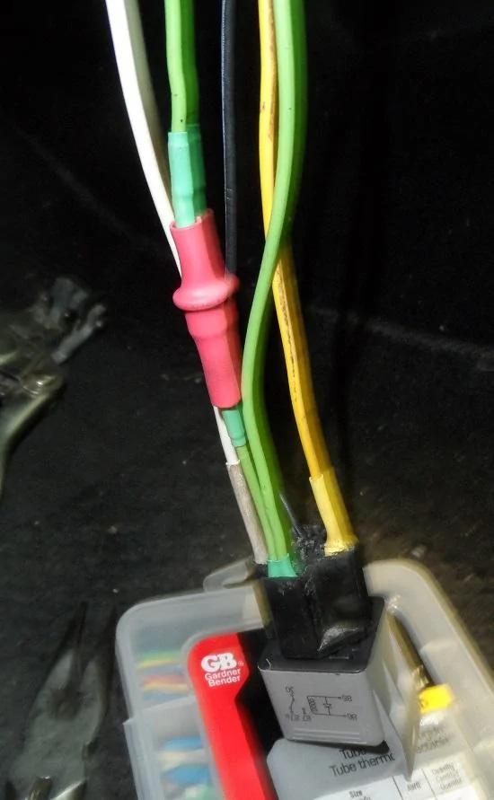

How about a switching transistor instead of a relay - these really have extremely low current going to the LED license plate lights, it's zero compared to the alternator rotor winding current that my regulator circuit controls. A more complex circuit to be sure but the current load is so crazy low, there's no contacts to go goofy.
Jeep Gladiator Back up camera at night… cruise-relay_2273
Jeep Gladiator Back up camera at night… reg-bread-board_1
