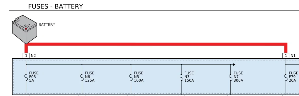

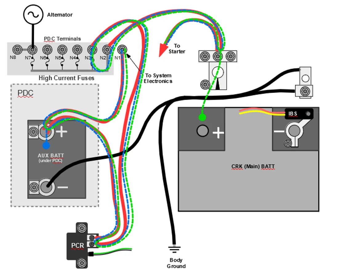

Here's the diagram - other than going through a fuse to the aux battery, the charging comes across the same bus, the same high current fuse for both batteries.
Jeep Gladiator What is really going on here? License plate lights wash out backup camera image while reversing at night 1758238532269-aj
40,514
54,044
This is an electrical schematic - this shows "battery" - they treat them as one electrically speaking.
One does go more directly to the high current feeds - (N2) radiator fan, EHPS, PCR, and the IBS is fed from the main, but everything else is going through N1 - EVERYTHING.
All of it. Every module, everything about that Jeep feeds through N1 save for what I listed above - 4 items.
This shows that they are treated as one parallel pair electrically.
Further proof is the fact that BOTH drop voltage at the exact same rate during a stop - they are connected together and all loads during a stop come from both batteries the whole time, until the starter is triggered.
Jeep Gladiator What is really going on here? License plate lights wash out backup camera image while reversing at night 1758239757184-dr
Mr._Bill
Jul 22, 2019
6,656
7,771
North Las Vegas, NV
So when the ignition is off and the Jeep is parked, the two batteries remain connected as one?
Yes, they are paralleled together all the time, except during a ESS restart. The computers (and some other circuits) are separated and run off the Aux Battery while the starter is cranking to keep them from becoming unstable due to low voltage.
