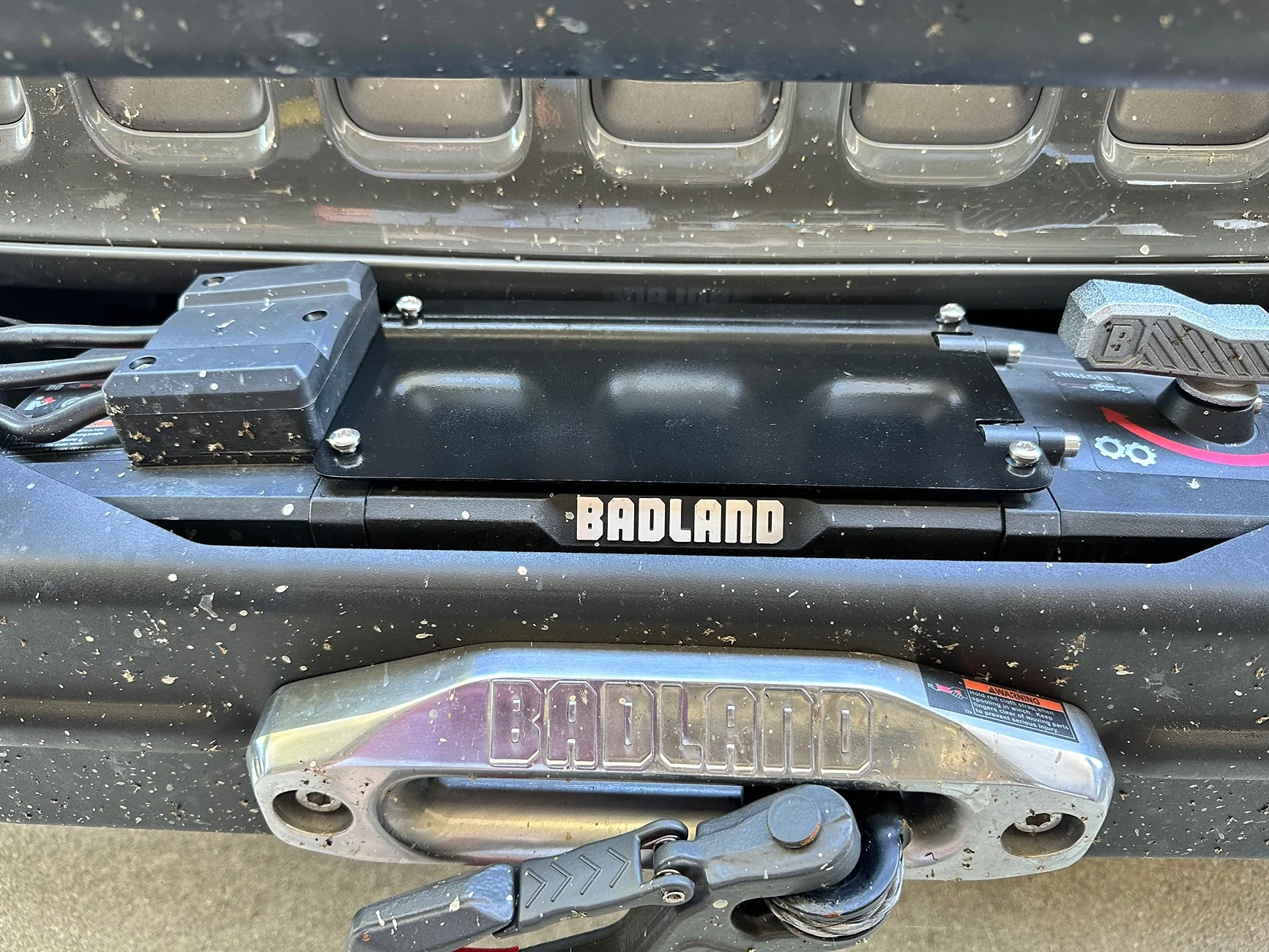

I contacted Tazer about these issues. I have a 2022 JTRD and had features seem like they were turning themselves off after a while. They said that if the truck sits for a while and the battery drops below a certain voltage, it can cause some of the features to reset. I also asked about winch mode. At the time (last year sometime) they said winch mode was not yet available for the diesel because they were still working on it. There have not been any updates released since I asked about it. I'm assuming they just gave up on it especially since the diesel has been discontinued.
Here is what it looks like now.
