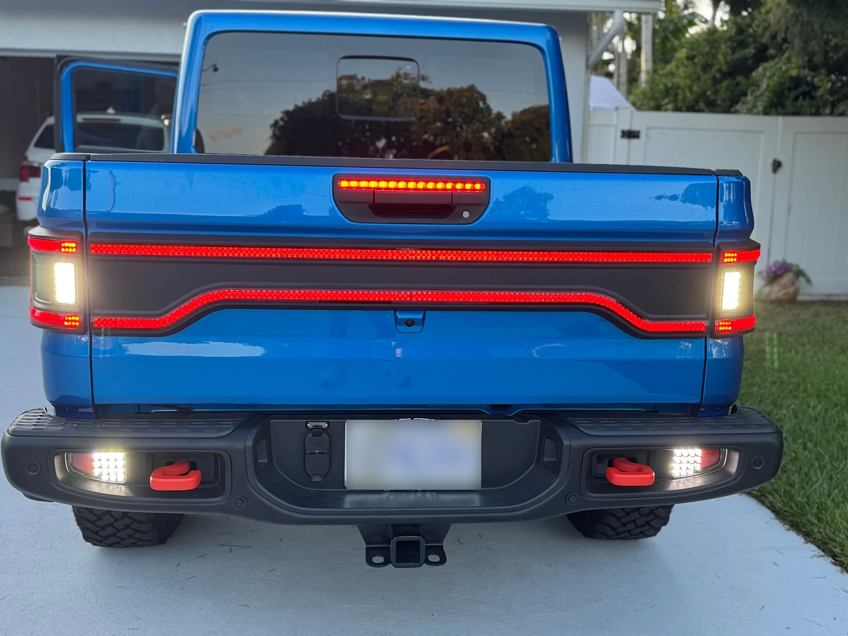

The Lights and Camera are not well thought out. But if you want to ensure you have light at night in Reverse, you may want to think about maybe adding some lights, I did all oracle on the back. Picture is during the day, but I am sure you can imagine what Nighttime, will look like
Jeep Gladiator What is really going on here? License plate lights wash out backup camera image while reversing at night IMG_4183
