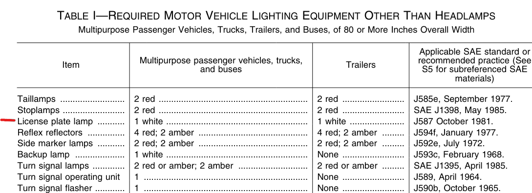

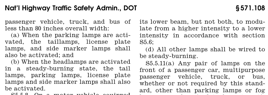

Just for clarification, states can add to it, or adjust it so to speak, but license plate lights are part of the FMVSS. 571.108 S7.7
40,442
53,860
Found it - and absolutely stand corrected -

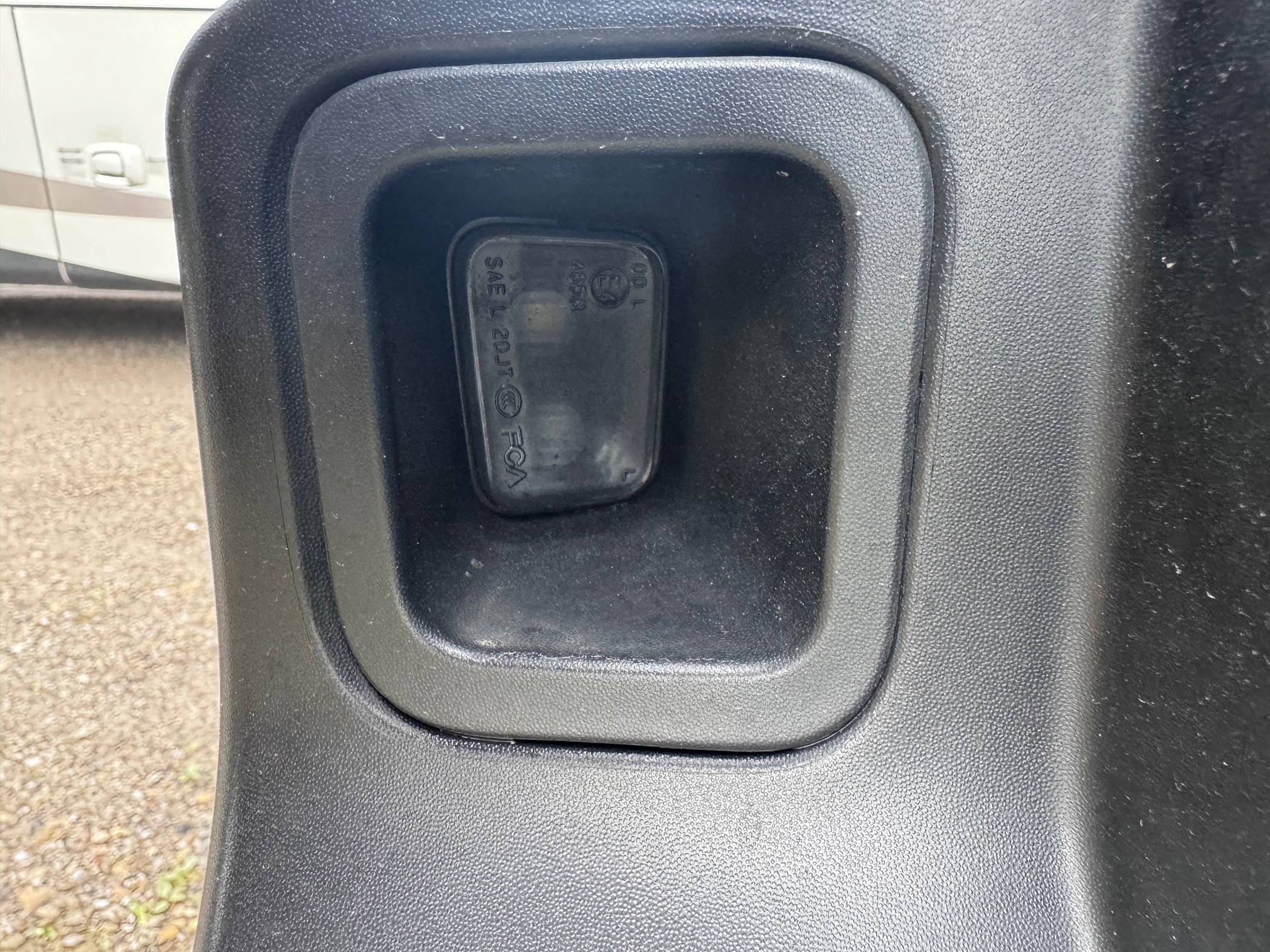

FWIW I taped off mine, sprayed VHT Niteshades tint paint on mine. Then wipe out the cone leaving tint on the light. It needs another coat to be where I want it. One coat made a noticeable difference.
Three coats would likely almost black them out.
