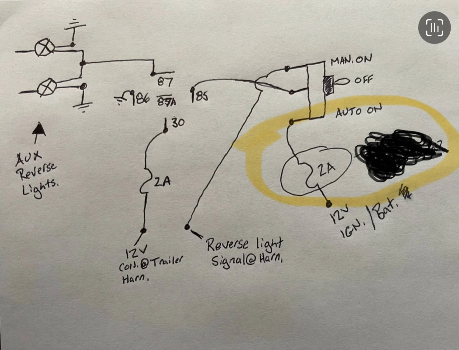

Thanks... Im not new to wiring or adding simple accessories... but when including relays and diodes... things start getting a little cloudy for me. Maybe that makes the Ebay harness worth it... unless I am over thinking and making it harder than it has to be (famous for this. Ha ha)
Could I not wire the Oracle leds with oracle harness following the instructions and then run a hot directly to the Aux ?
Not sure anyone has tried it without any diodes.
The idea of the diode is so that when you power the lights via the aux switch, you don't feed back into the truck's backup light circuit.
Does it matter?
Good question.
If you did it without diodes, you'd feed from the aux onto the power lead to the truck's backup lights and back into the BCM (I believe that's correct)
Does it matter?
Good question.
Will it matter?
That was my big question too. I guess a diode wouldn't be much harder to install. I'm guessing you could use one(1) diode for both oracle leds... both led hots into the diode and one(1) single hot out to the aux switch ??‍♂?
When you say "back into the BCM" Body Control Model... could you possibly explain ?
I thought when connecting an accessory to the AUX panel, I just needed to ground to the body and connect a hot to one of my aux switches 1-4 ?
What is the best way to determine the correct diode ?
Does it matter?
Good question.
Will it matter?
I’ll probably need to draw out what I am about to say…. (5 pin relay) So ? but with a relay- 12v in…. And then there are two signal in posts- totally separate, is the back feed/diode just a precaution or?
