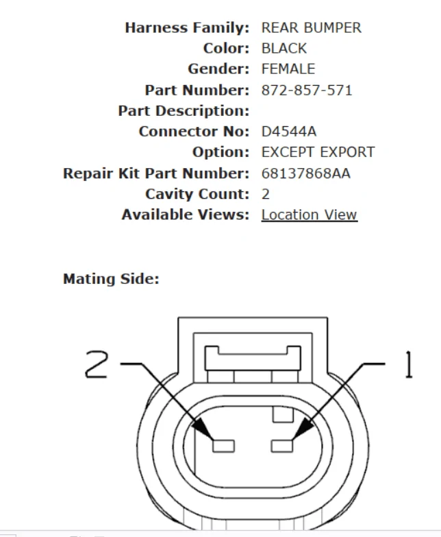

I think this is it..... It's the male and female connector on top of the left frame rail, next to the spare tire shield and handles the license plate lights.
