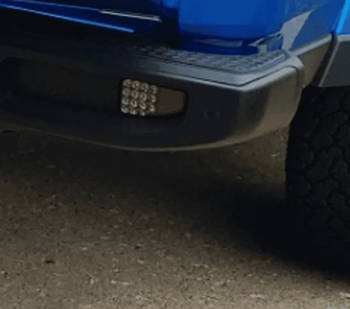

i used the oracles that go in place of the reflectors. Bought the wiring harness too. Was impressed w the set up even though some bash them (oracle). They are real bright, light up large area about 50 ft back

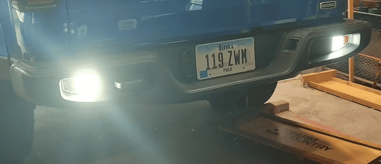

Oracle lights in action…..
Whoa!!! That's awesome. Those lights are super bright!!! Congrats.

+1 for the Oracle bumper backup lights combined with the flush mount tail lights. My backup lights are now bright AF. Don't even notice the license plate light glare anymore.
I've had both in for well over a year with no issues.

The LED is about half of the reflector space, the rest is reflector. Trust me, they are BRIGHT AS HECK. You don't look at them when on.

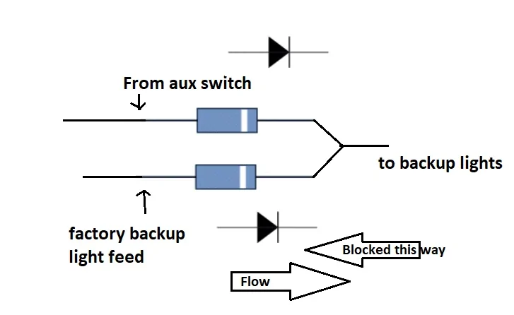

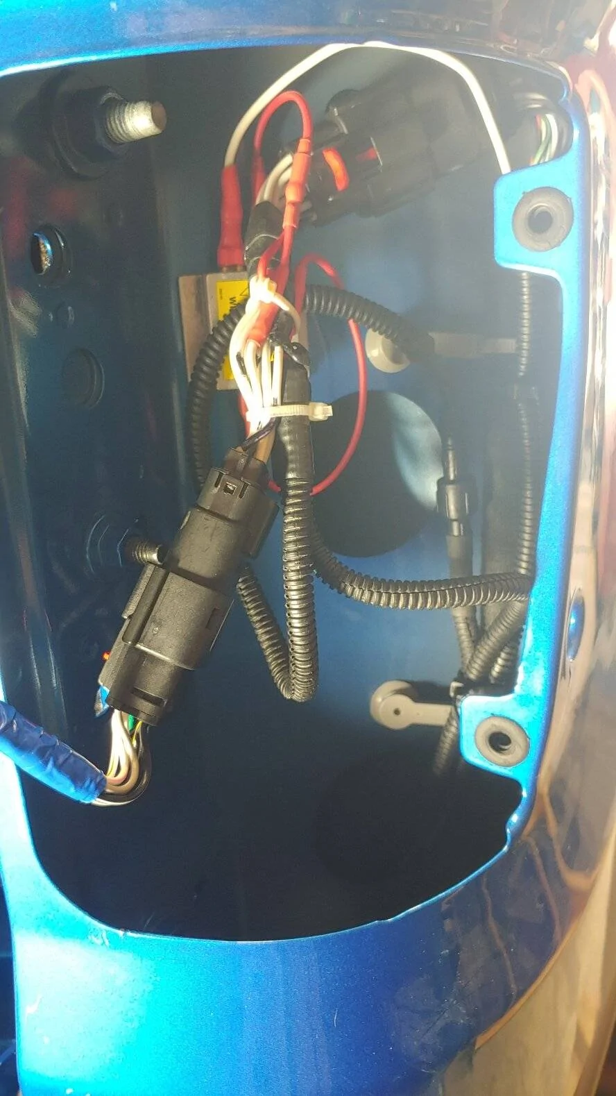

Can you explain the wiring to get it to trip in reverse and off the aux? I assume a 3 way toggle switch?

A diode pair -

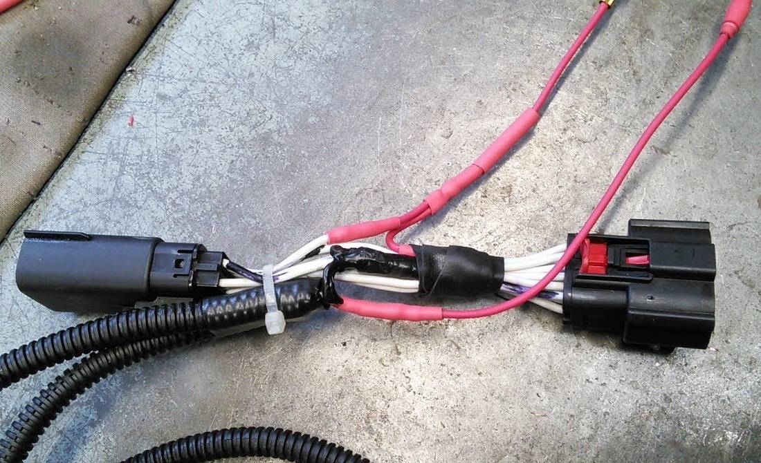

You need to slightly modify the Oracle plug and play harnesses, but very doable.
So the Oracle harness, below, I modified so the factory backup light feed goes out and to the input side of the diode, the aux switch white wire to the other side of the diode, and the output of the diode then goes to both of the Oracle backup lights.
Jeep Gladiator Brighter Backup Lights IMG_20220724_115758

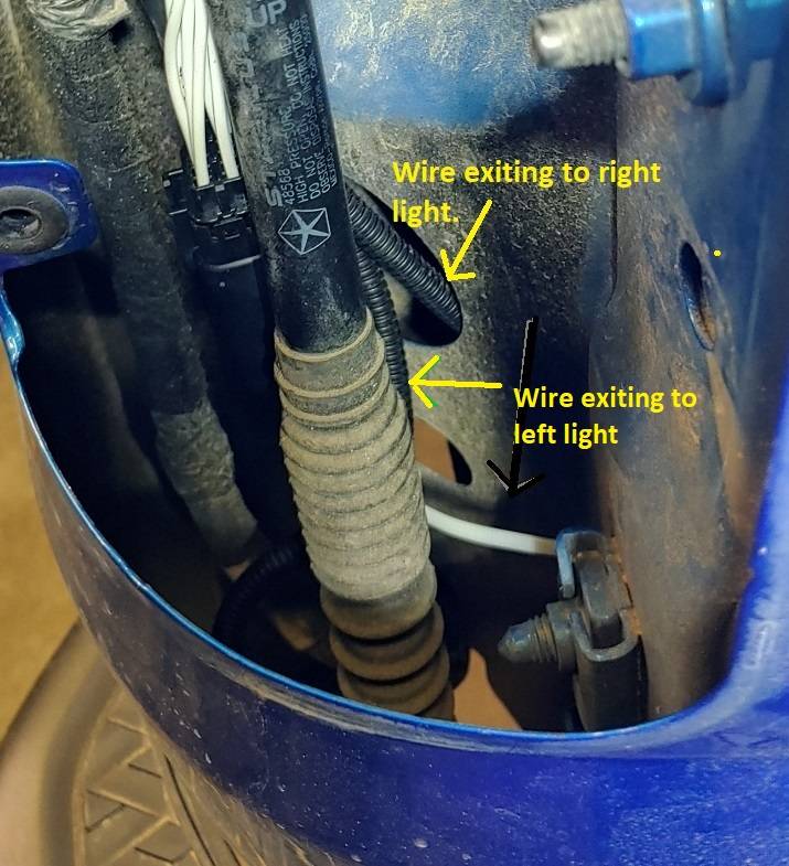

The white wire seen here comes from my aux switch back to one of the diode inputs - I put the Oracle harness in the RIGHT side to make it easier, shorter run for the aux switch wire going straight back from the connection under the hood.
Jeep Gladiator Brighter Backup Lights 20220728_152905

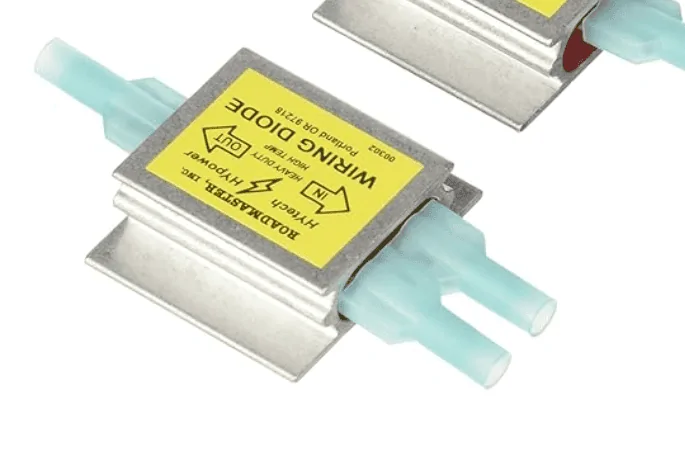

The diode I used, you can just see in the pic above -
https://www.amazon.com/gp/product/B0002UHVHI

A diode pair -
Ahhh okay that makes sense. Appreciate you typing that out. Looking to get something similar set up, it’s nice to have dual functions for the same lights.
