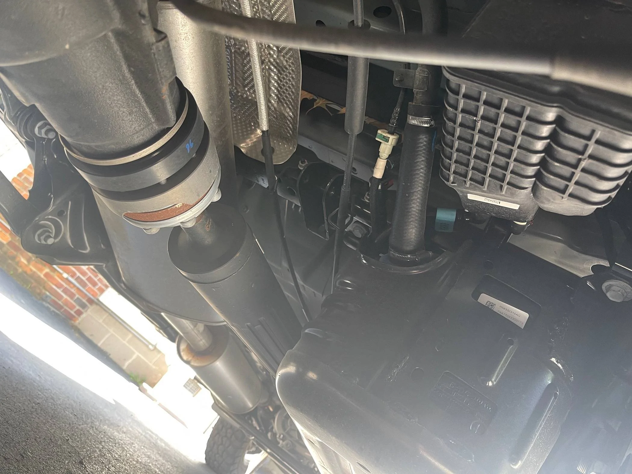

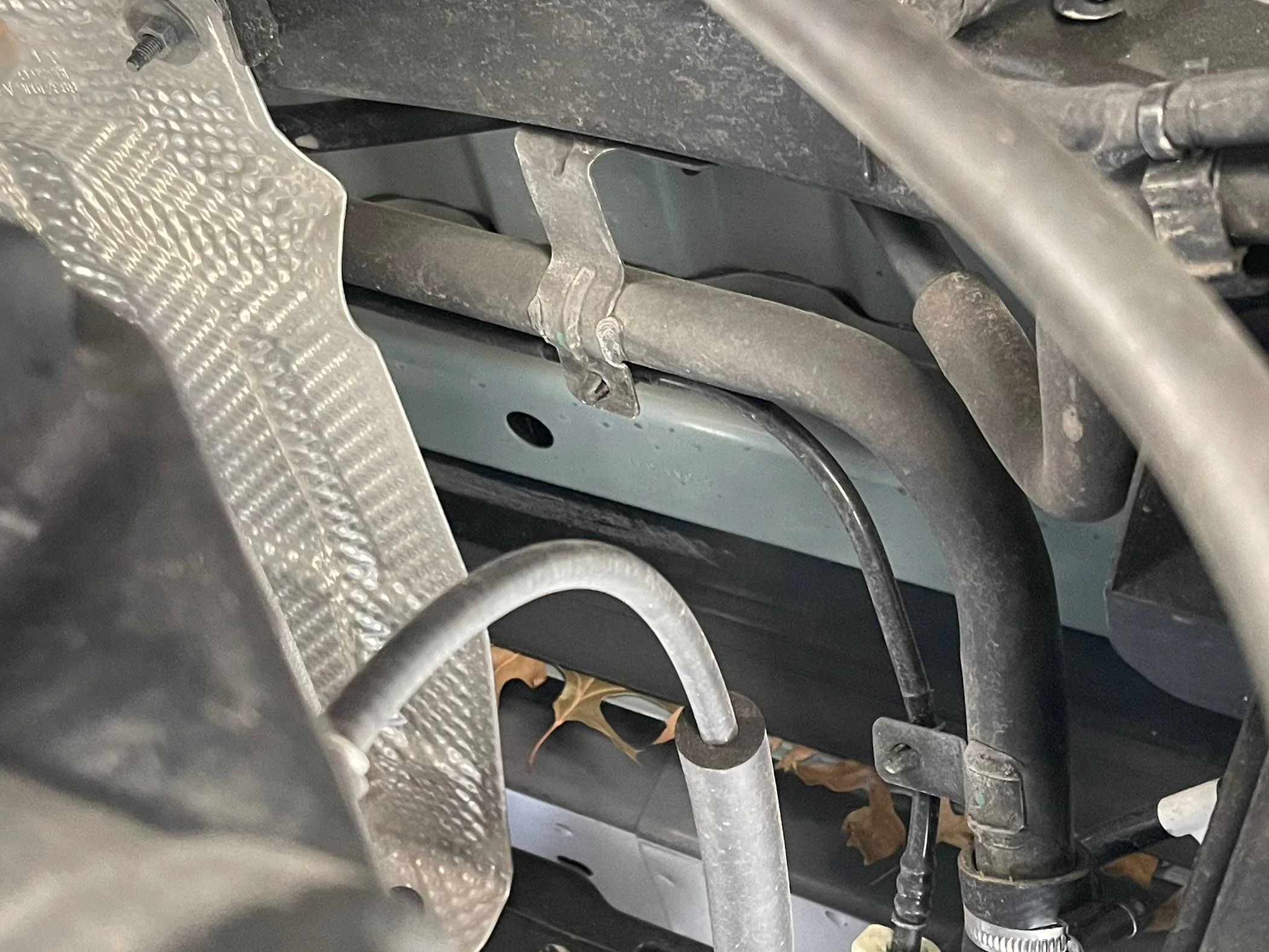

Also, crawled under there to inspect the work and no wonder these things are prone to overflow, the filler neck is a 1” tube! For anyone out of warranty it looks like a straight forward repair that wouldn’t even require dropping the tank. For reference the part that was replaced was 68334985-AE which is the actual part up in the bedside behind the fuel door. Couldn’t get a good pic but here’s the downstream line (which wasn’t replaced)
