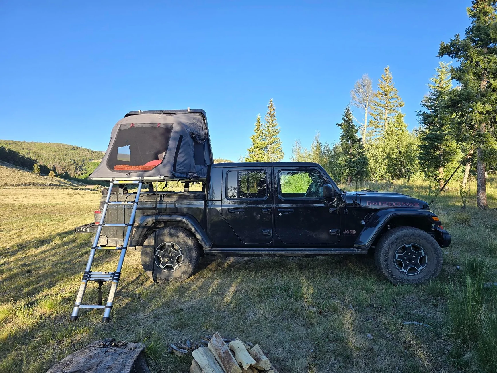

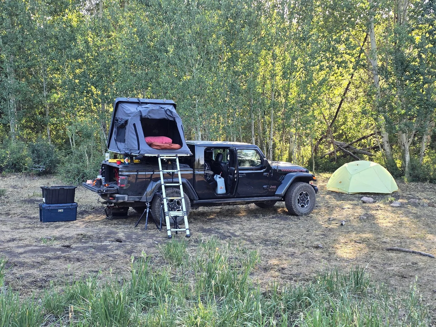

I know this questions probably gets asked alot but I have over researched the topic to the point that my brain is fried. I currently have a 2021 Jeep Mojave with 35s, steel bumpers (well it will have a steel back bumper, just haven't put it on yet), diamond back bed cover and ikamper dlx mini. The bed is usually carrying camera gear, camping gear, recovery gear, etc. The jeep is about to reach 90k miles on it and I have pretty much worn out the suspension so its time for a lift. I have attached two photos to show my current configuration. Once I am done with the 35s I will probably swap to the 37s.
I do not want a spacer lift so I have looked at Rock Krawler, Metal Cloak and and Clayton. The issue that is causing my confusion is the added weight of the over landing gear.

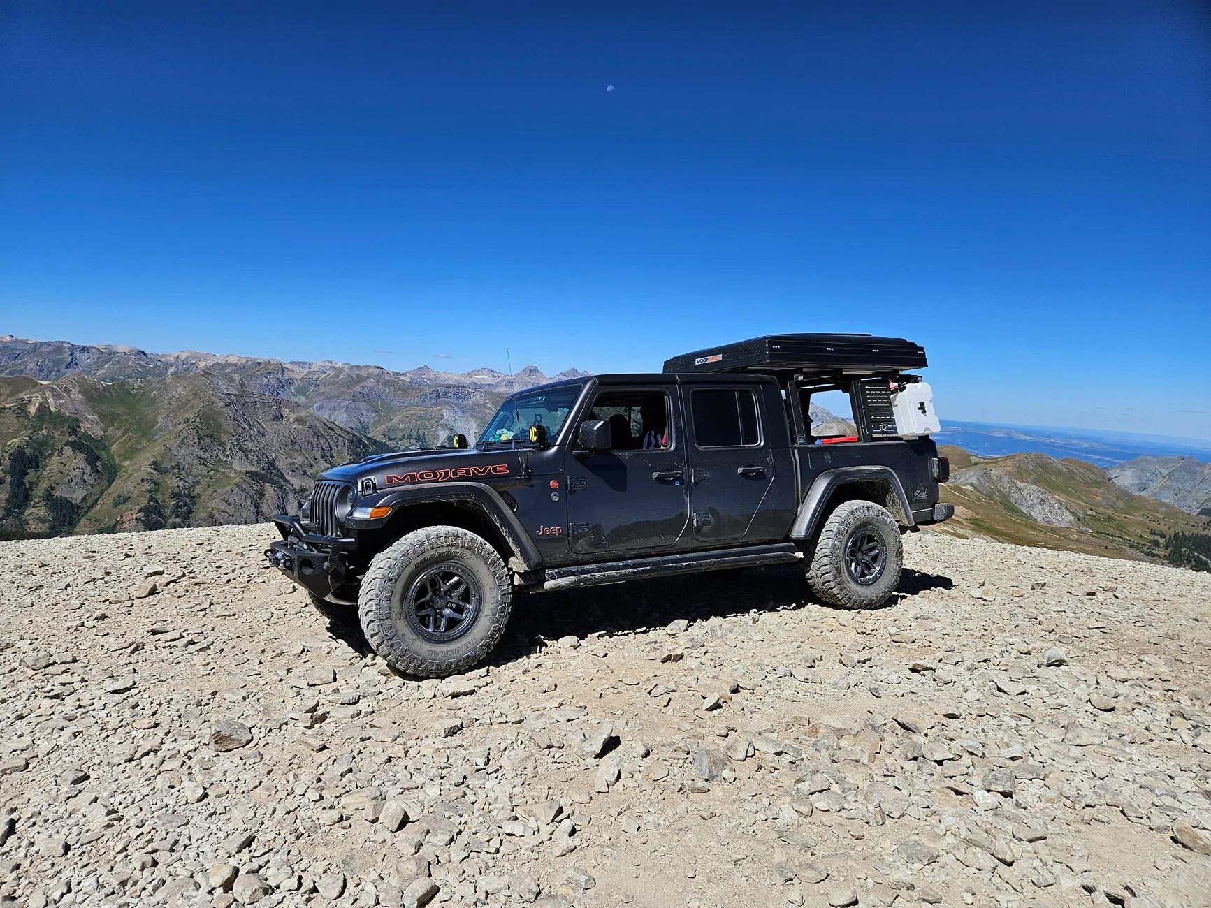

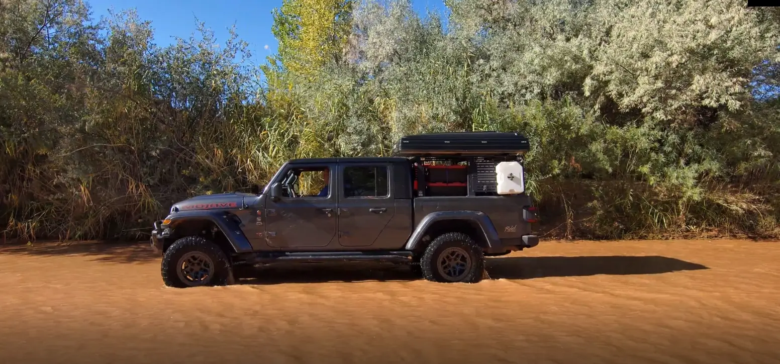

I have a '21 Mojave w/ 35's. I went stock until after my first trip. Just didn't have enough suspension travel left with all the stuff we are 'required' to travel with. I ended up going with a Clayton 2.5" Overland+ lift and Falcon SP2 3.3 Adjustable shocks. This works well for me and I'm pleased with it.

After
