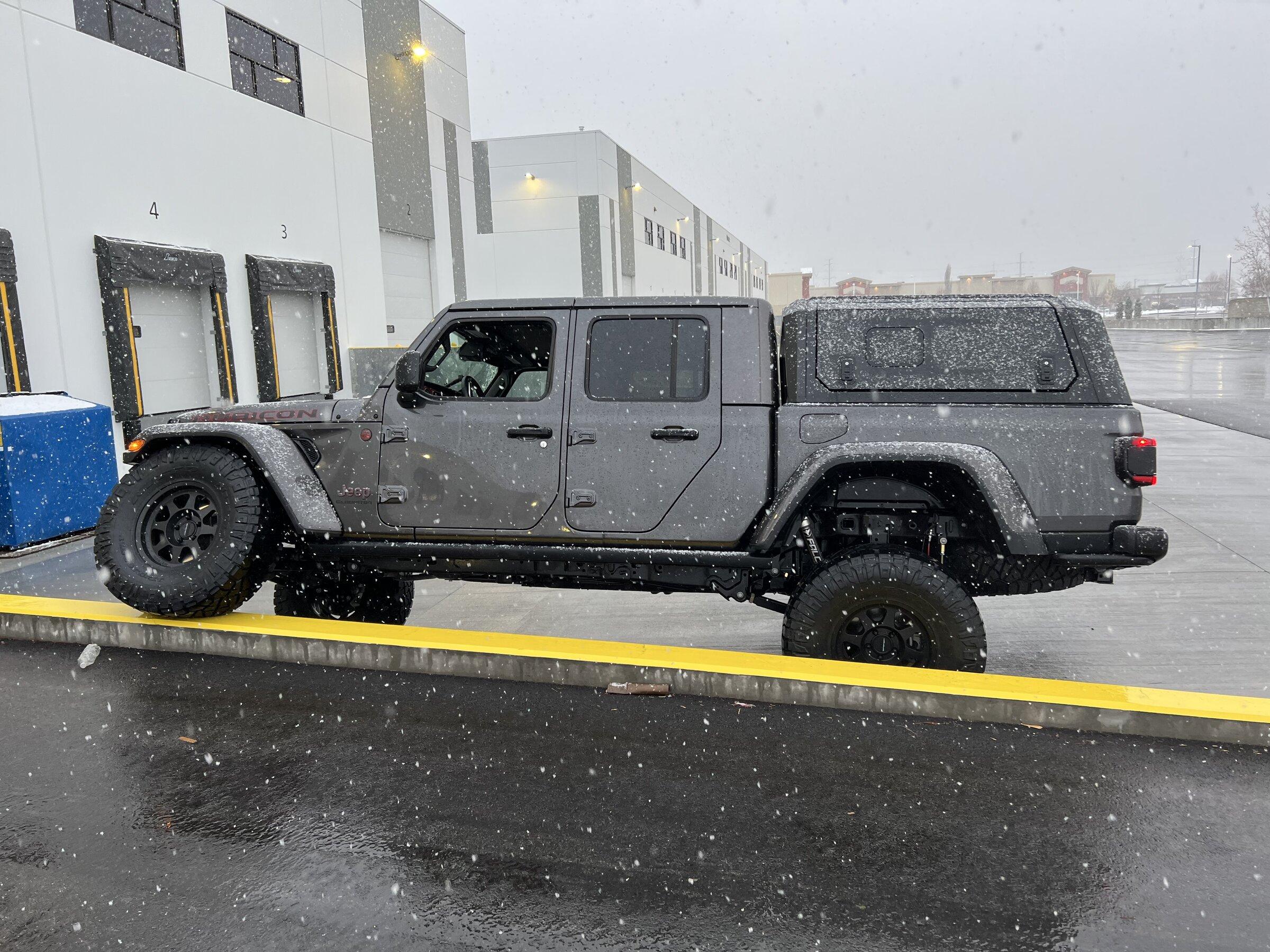

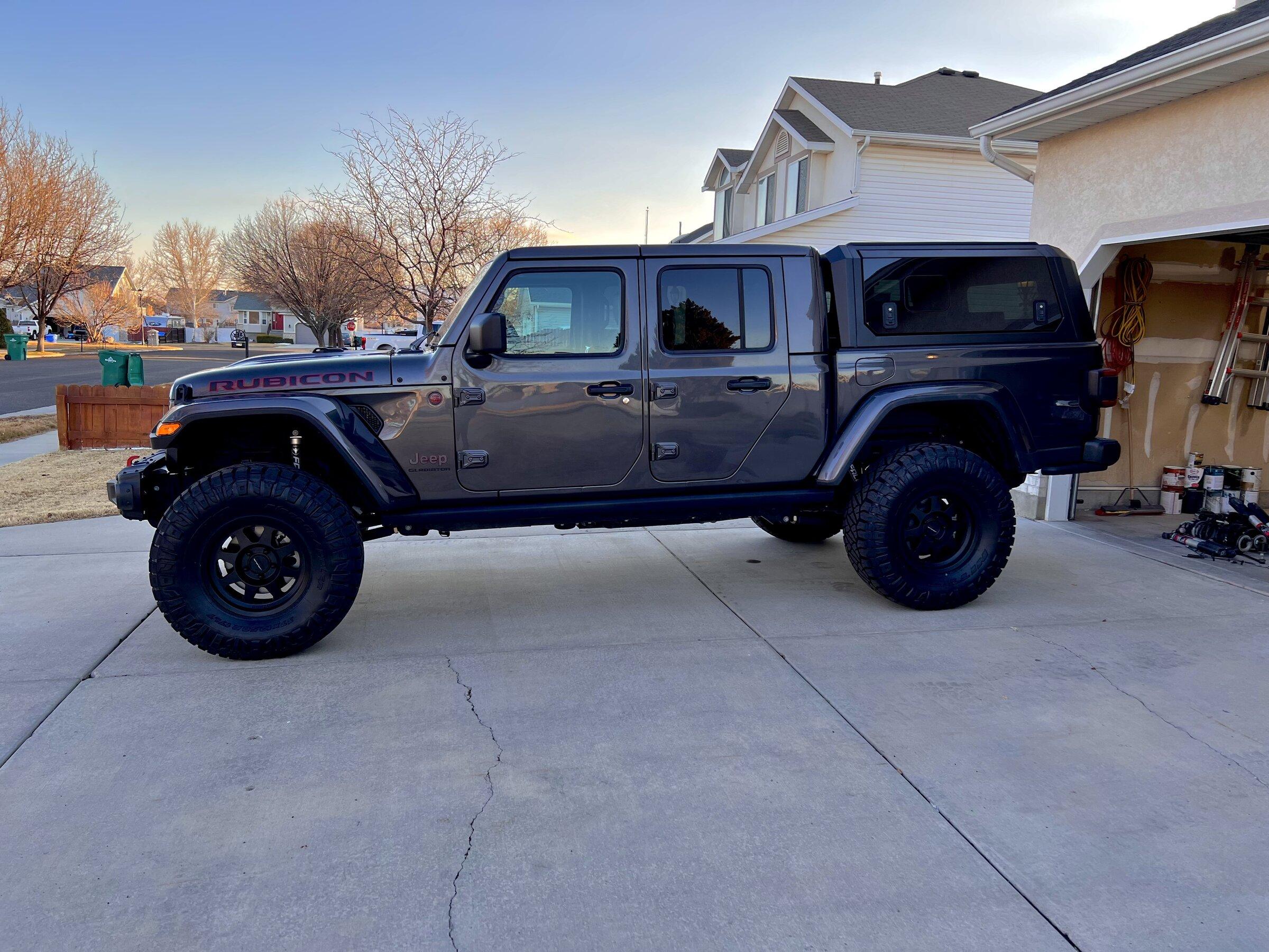

I am running the Clayton off-road 3.5” overland plus kit on my 21 JTRD. At the time of purchase they did not have diesel specific springs but they do now. I got the kit during holiday pricing and it was bundled with falcon monotube shocks and a Currie currentlync tierod and drag link. So far I only have great things to say. It’s slightly stiffer than stock but I like the feel and it does great off road.
Jeep Gladiator DIESEL 2-2.5" lift kit suggestions 22510FC4-5CC5-4EEA-BACF-A5B7D458A898
Jeep Gladiator DIESEL 2-2.5" lift kit suggestions 0E070ECD-32B2-4852-880A-A8A0A30B2FCA

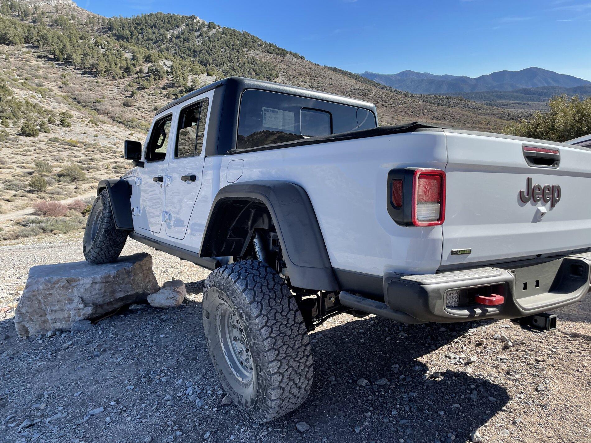

My JTRD rides pretty good on the Mopar lift and 37's. It flexes good and it goes as fast as I'm willing to push it, albeit, I am a bit of a chickenshit.
Jeep Gladiator DIESEL 2-2.5" lift kit suggestions c1c6197a-0796-406d-8367-bef36bf35842-jpe
