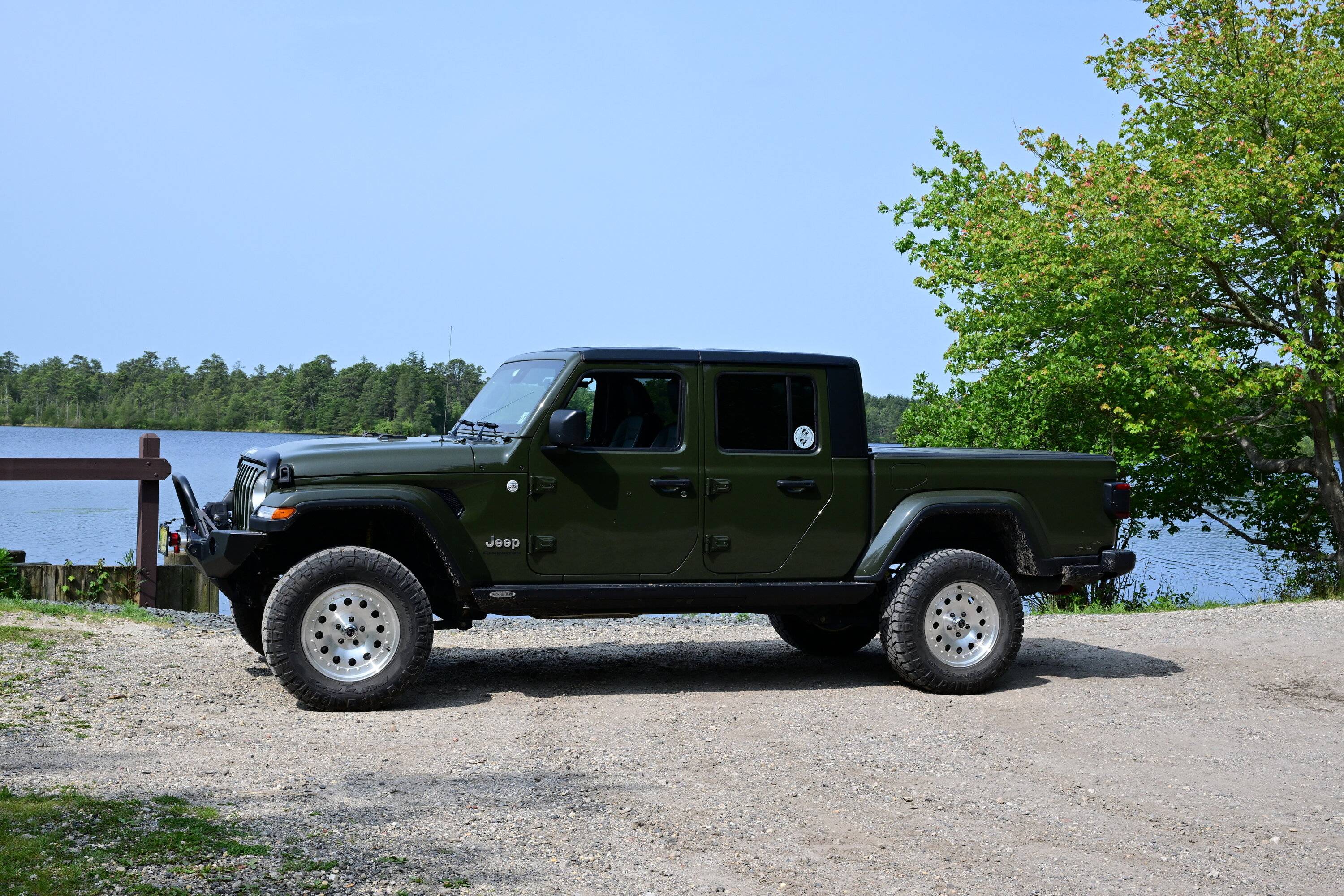

I went fairly conservative with my Overland; 285/70r18 (34") tires with 18 x 8" (+30) wheels and later went with the AEV suspension and an inch and a half Teraflex spacer. I recently regeared to 4.56, and surprisingly, get 20+mpg on trips.

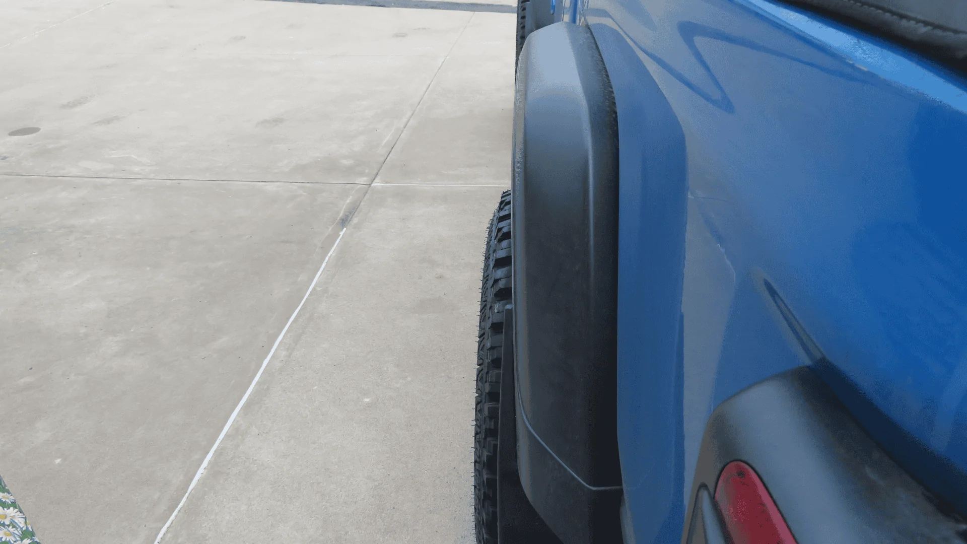

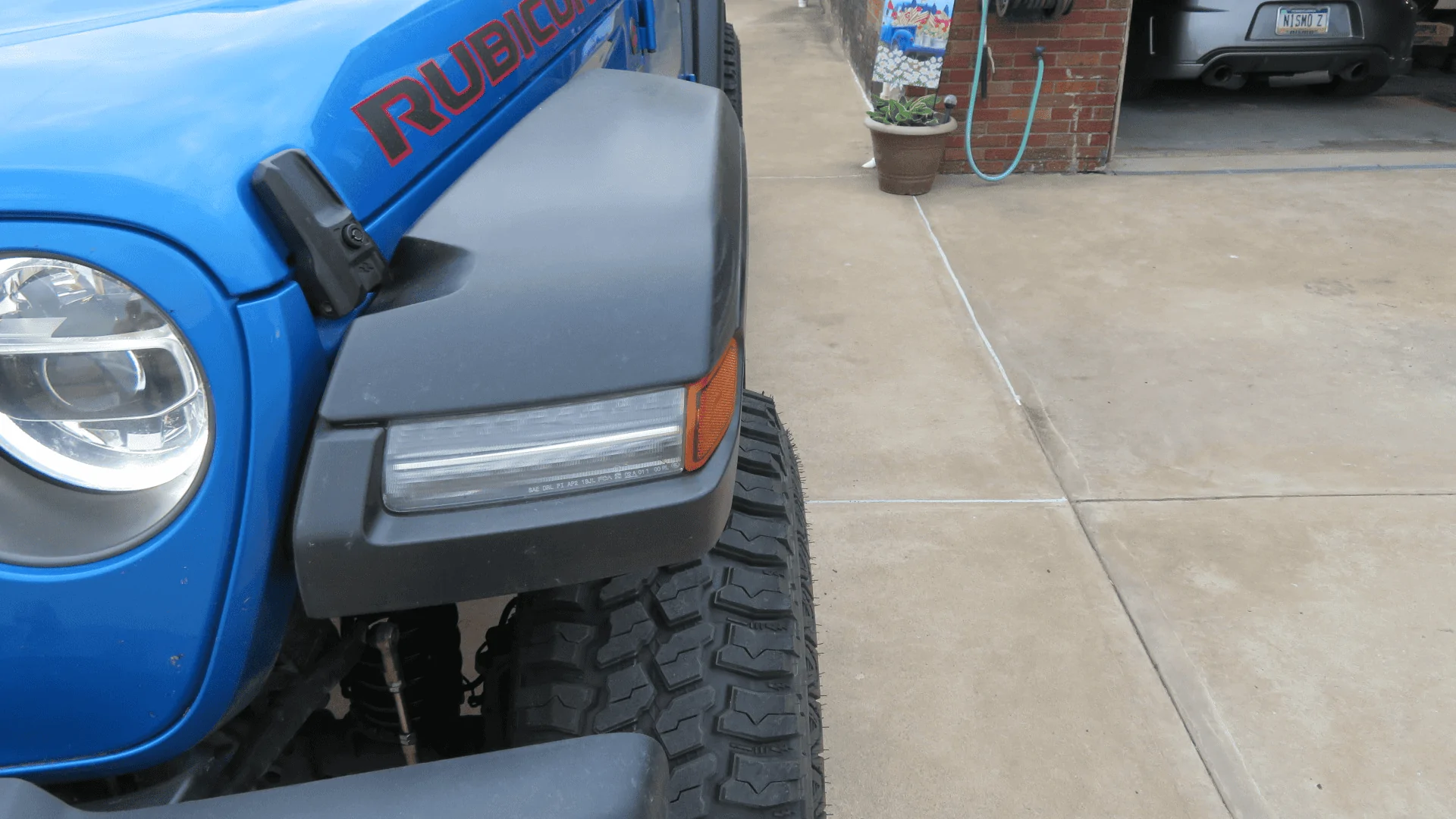

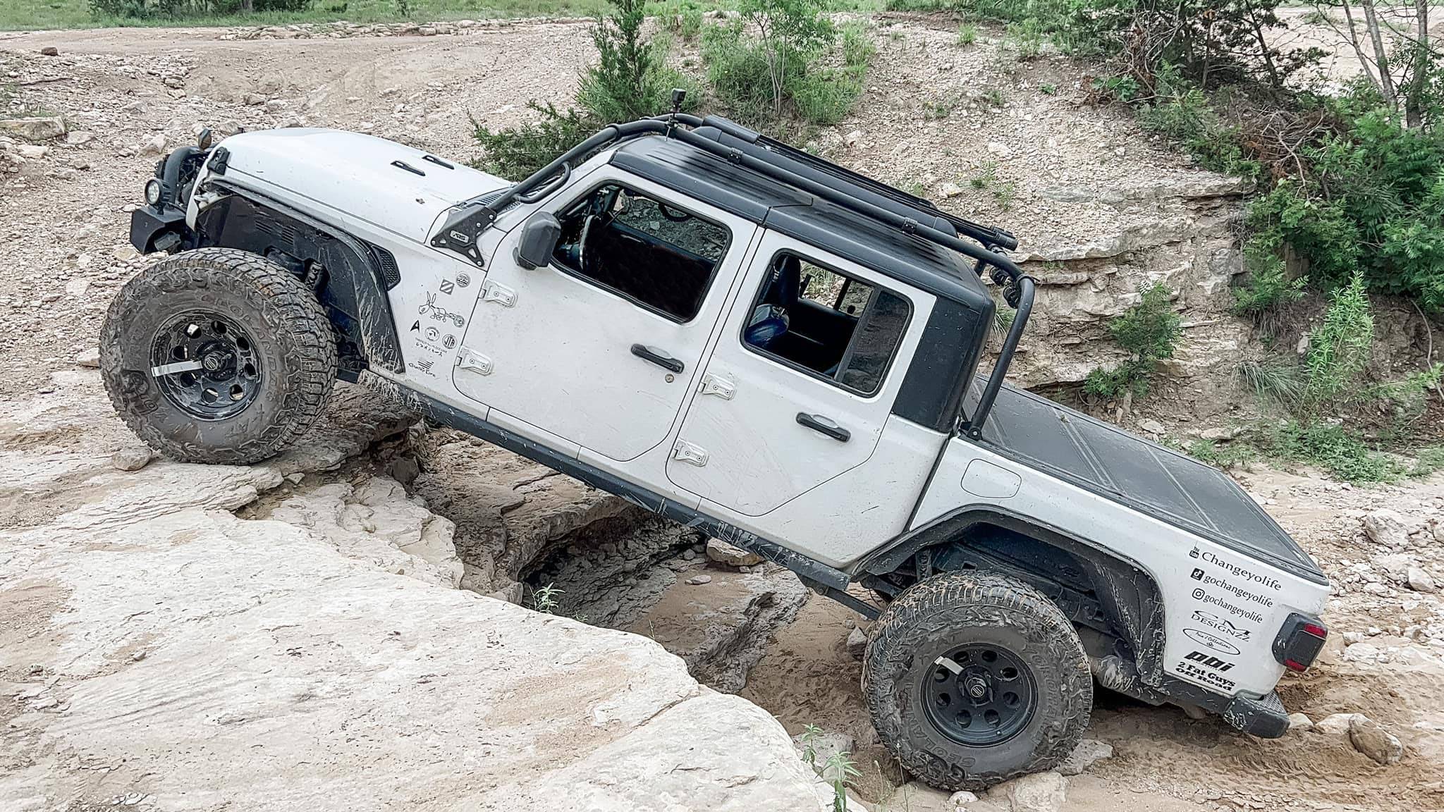

4" Frankenstein lift with 37's on Rubi rims. Using Teraflex 1.75" spacers.

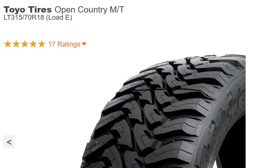

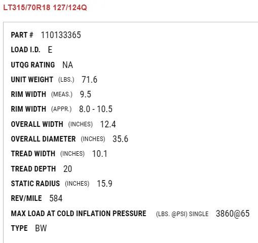

Can you? Yes
Should you? Your call.

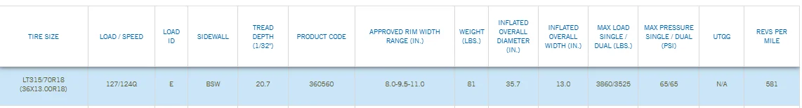

Pull up the tires you're contemplating on the manufacturer web sights and you'll find the recommended wheel width's.
What I've found...
Jeep Gladiator Overland Tires 1692754003801
Jeep Gladiator Overland Tires 1692754292664

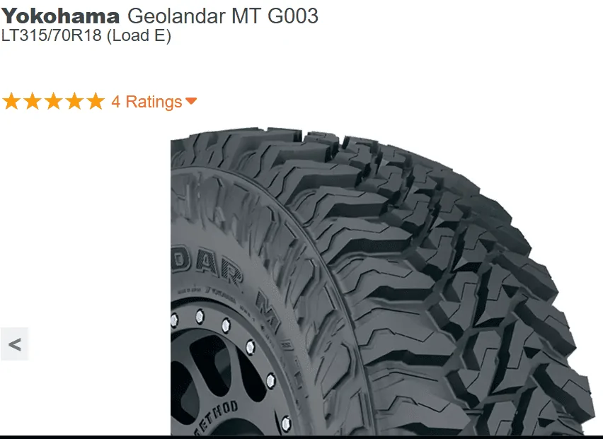

Problem 1. It's an E rated or 10 ply tire, which are meant for 3/4 or 1-ton trucks...not a jeep. Problem 2, The minimum approved rim width is 8 inches making the factory wheel too narrow.
Jeep Gladiator Overland Tires 1692755007750
Jeep Gladiator Overland Tires 1692755029682
Again...an E Rated tire with a minimum 8 inch wheel width.
Another issue is the 18" wheel. Think Ford superduty. Most of the 18" tires you're seeking are in the load range E rating.
Now, if you change over to a 17 in wheel, there are tons of 8.5 width wheels, you'll have better floatation when aired down, you'll have a much larger selection of tires in D and even C load ranges and they'll be a little less expensive.

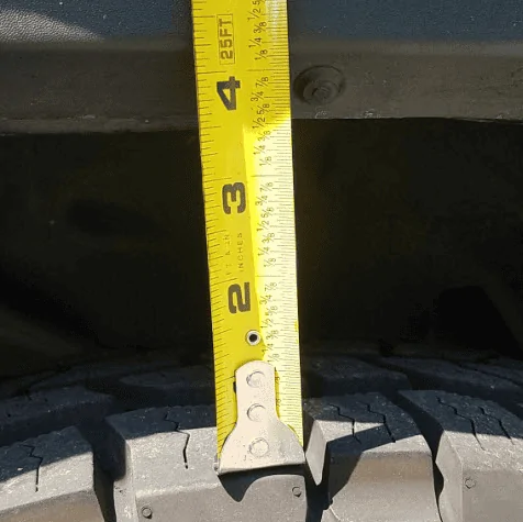

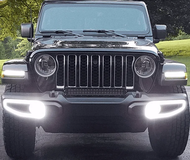

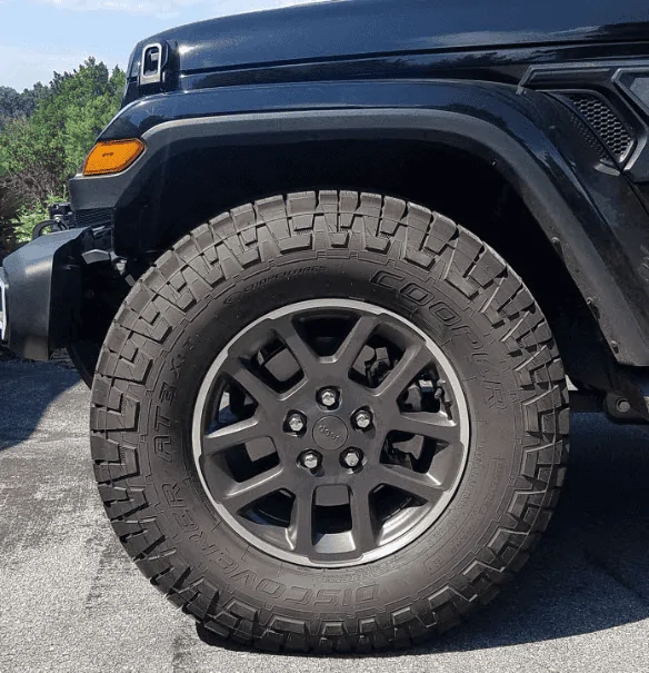

Have a 2022 Overland. Also, have a Mopar Lift still in the box. But I already put 35s on my stock rims. Cooper Discoverer AT3 XLT 285-75-18. Specs below. Liked these for sidewall strength for towing, lighter weight for better starting, stopping and mileage. And I like the narrow stance. Prefer the Pizza Cutter style as opposed to the wide balloon monster tires. Anyway, no rubbing any where. Stock fenders and front bumper. Installing the Mopar Lift will only increase my clearances. NOTE: This is a daily driver. No Rock Climbing or forcing the suspension into outrageous contortions.
