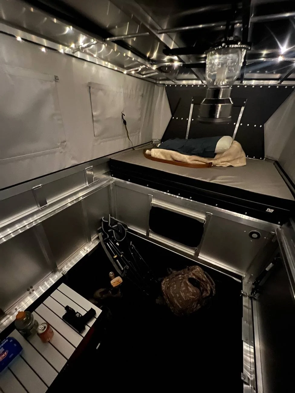

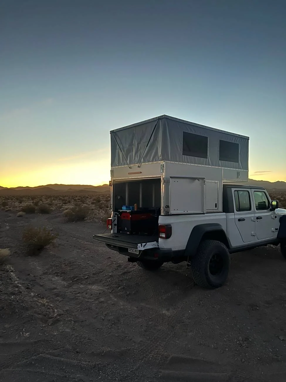

First post. Wanted to share some pics of the OVRLND camper build and some Jeep pics. The camper build is working great, love it!
Give specifics please. Looking at the bed. Is your kitchen at the front of the bed directly behind the cab? Are you using the bed slide or does it lift up somehow? Also love the asymmetric barn doors! How long gave you had it?
brdogin
Nov 13, 2024
Ogden Utah
Jeep JT
Yes the kitchen is directly behind the cab to keep the weight as forward as possible. The bed slide functions as normal with a gap of about an inch to the countertop. I slide it out at bed time, the rest of the time it is slid forward and I simply fold the Exped mattress over out of the way providing access to the kitchen.
The camper was installed in July and I completed the build by September. The build includes 18 gals of water with a sink and 12v water pump. The 10 lb propane tank feeds the 2 burner stove top and Propex heater. A 275 AH lithium battery supplies the 12v system which includes Victron DCDC changing from the alternator, Victron DCAC inverter and Victron solar charger (no panels yet).
The barn doors are a must have for my usage profile. Love them.

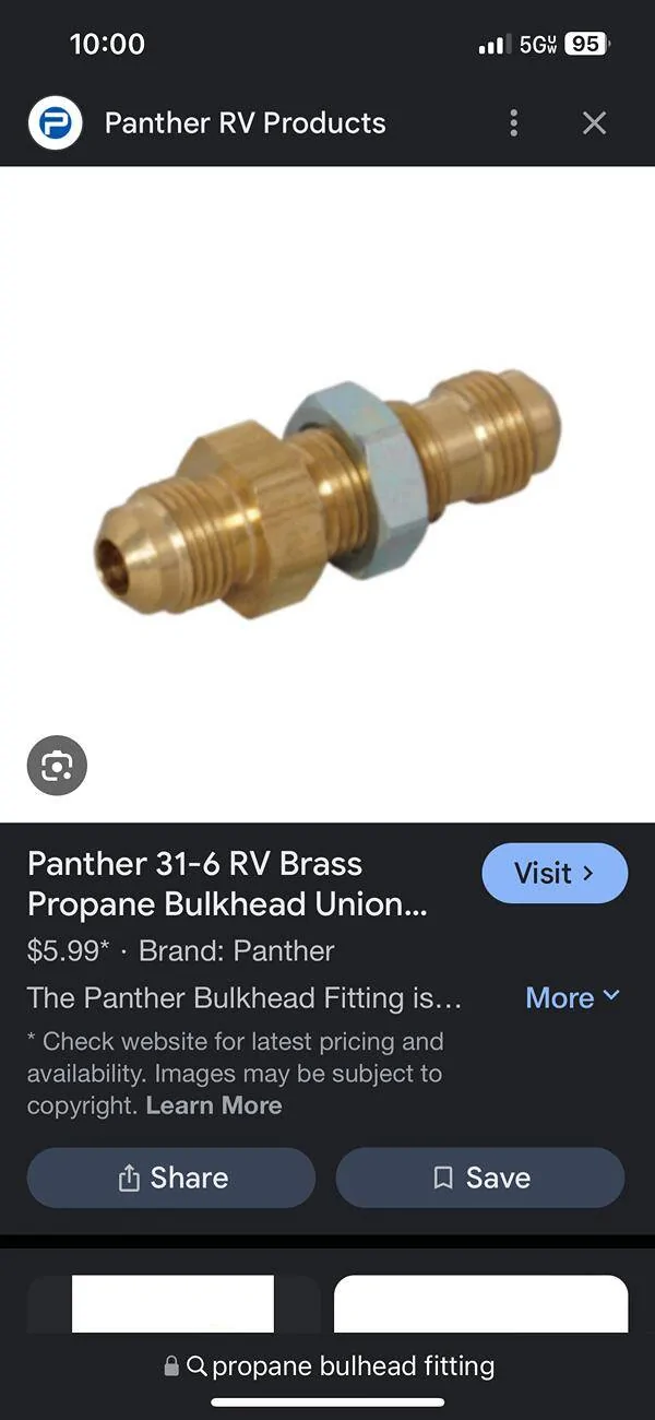

Wouldn't mind some specifics on how you plumbed that propane through the door.
It was simple enough. Just drilled a hole and installed a propane bulkhead fitting. I sealed up the surfaces also to avoid water leaks.
