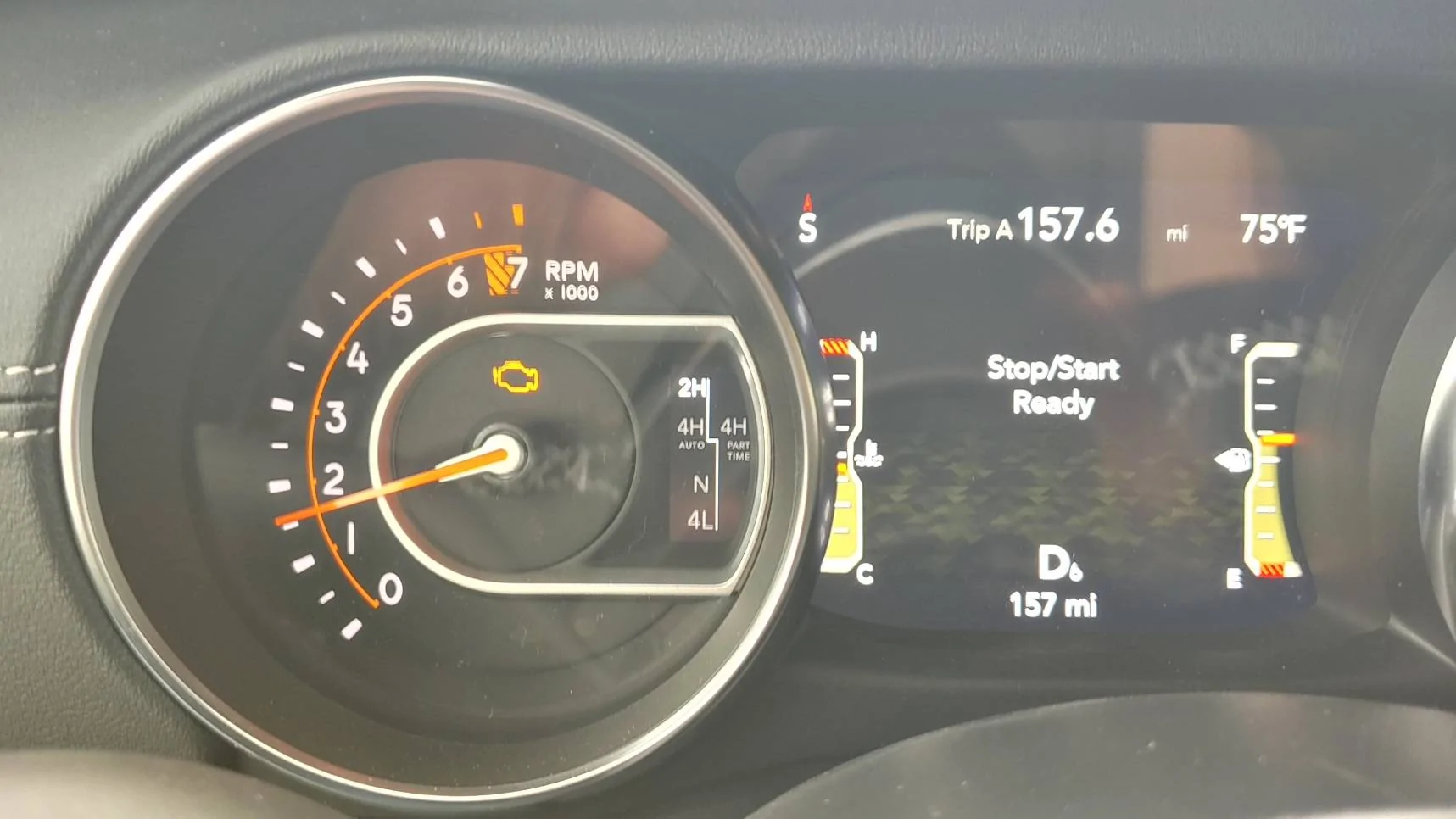

Any enging code will prevent ESS from working.
Fix the misfire!
Mine said ready - until I came to a stop then said it wasn't ready. Once the misfire MIL went away after a restart or two, it worked fine again. But it was a transient misfire - weird circumstances (easily fixed later)

Must be logic waiting for a gate to be triggered. If you restarted and the fault was still there, maybe it wouldn't have said ready. If you restart and the fault was gone then I can see it saying ready.
Mil and ESS ready at the same time ? Random misfire p0300 that cleared itself?
Freaky, eh? Yeah. It cleared. It started at that mileage - 2 days after getting it.
It would set the MIL, then after stopping at another store and restarting, the MiL was gone and ESS worked fine.
That was the hot-restart issue. It was fine on cold starts, only happened after thoroughly warmed up, shut off, then restarted about 20-40 minutes later. A misfire that was either so mild you could hardly tell, or so wiled it bucked like a bronco with a burr under the saddle, then it came out of it. Sometimes the MIL was set, sometimes it wasn't set.
CCDIFF was never "learned". Dealer forced a relearn of CCDIFF and the issue went away completely. Then a few days later, a TSB came out about it.
Mine was one where Jeep's STAR team requested detailed information about the issue.
It's had no misfires, no codes, no MIL since. ESS has worked perfectly - at least according to that chart I've posted a few times as to what criteria must be met.
