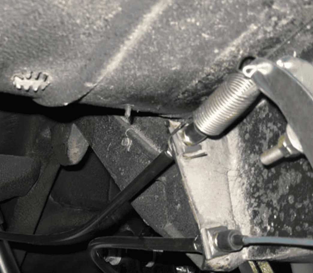

Poor design - some have a clip or pin that goes over the yoke so a cable can't "jump out".
This is the other end under the car, but even in the 1960s and 70s, there's a pin to prevent the cable from jumping out in the case of slack -
