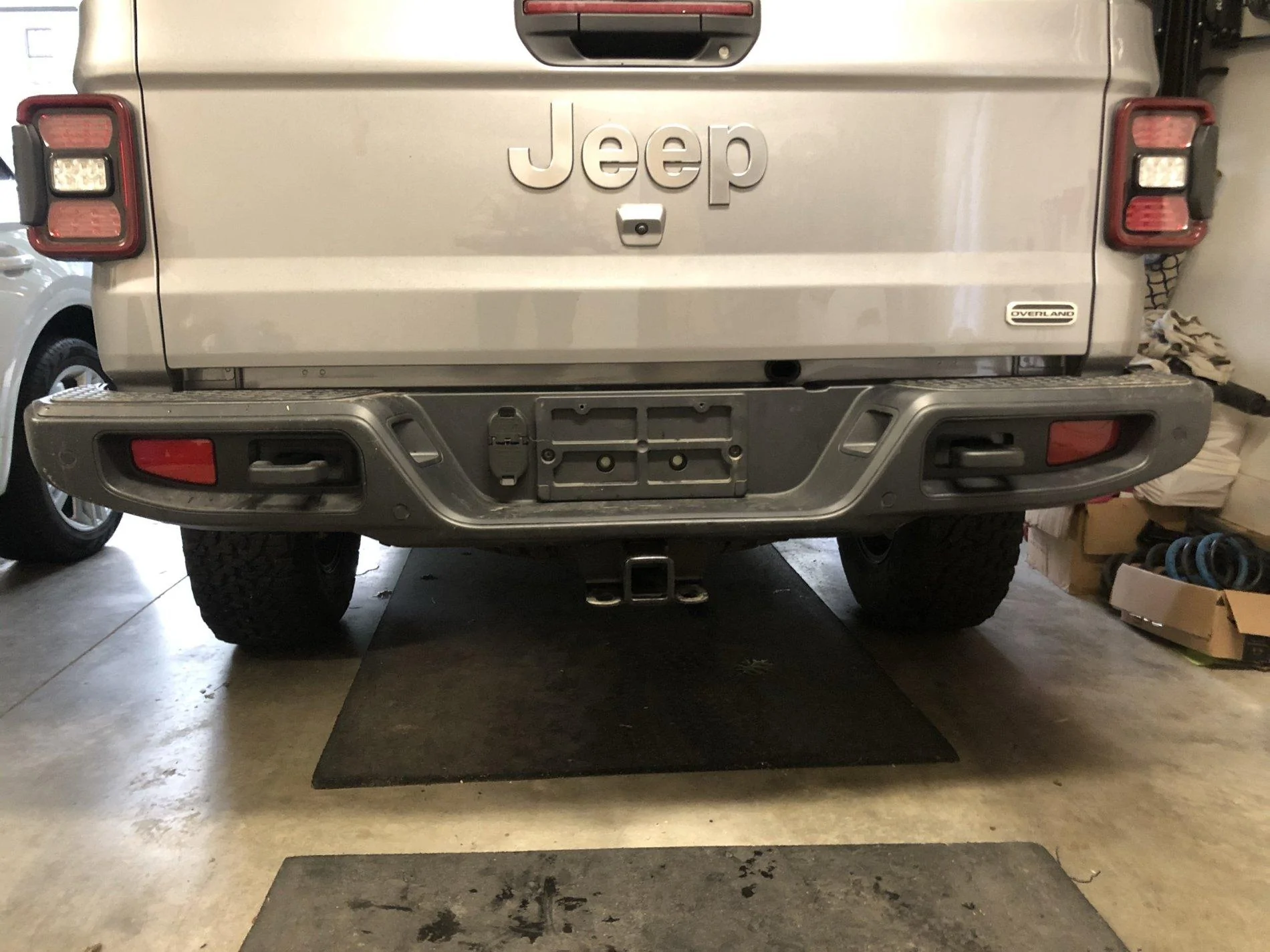

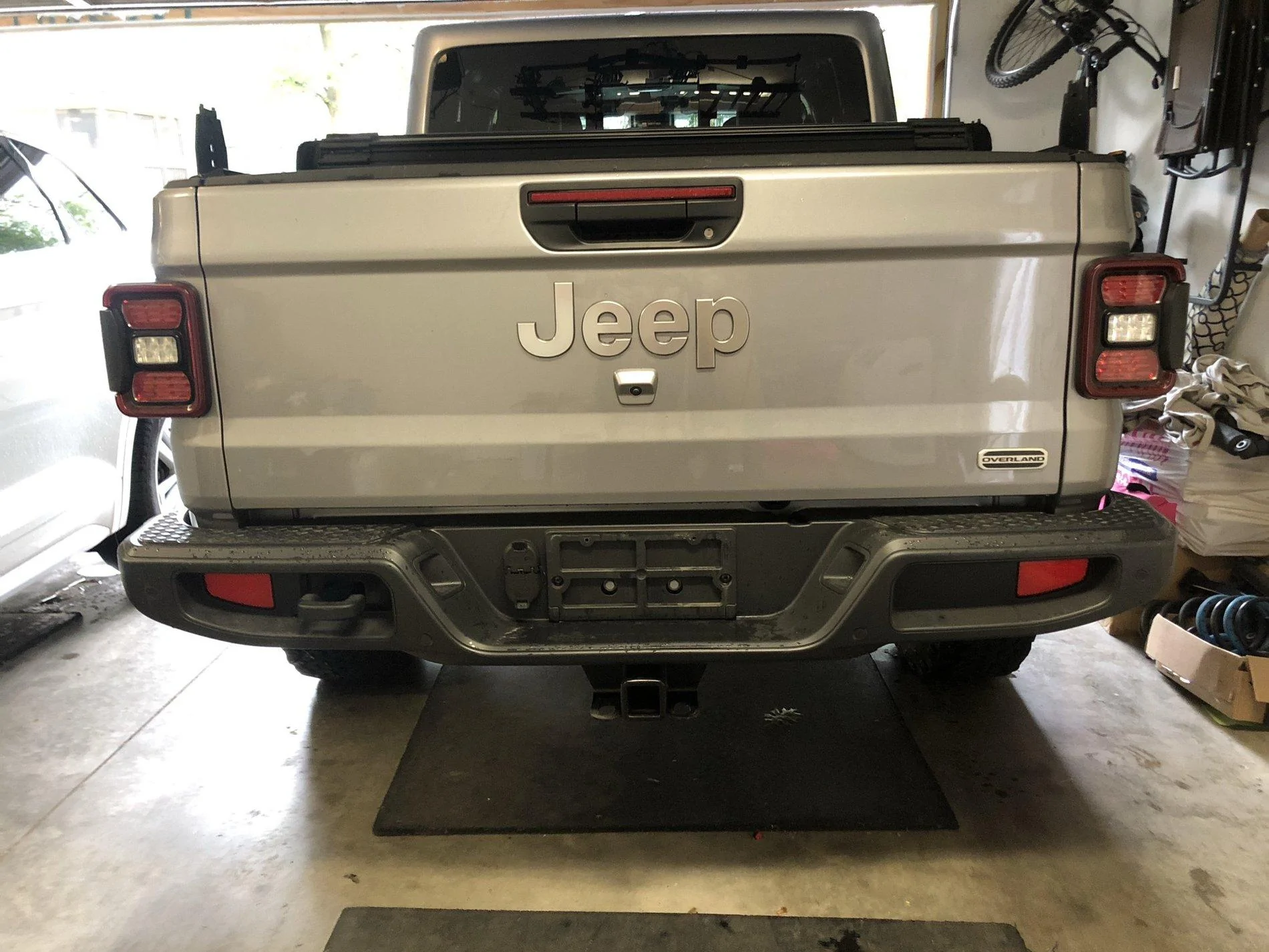

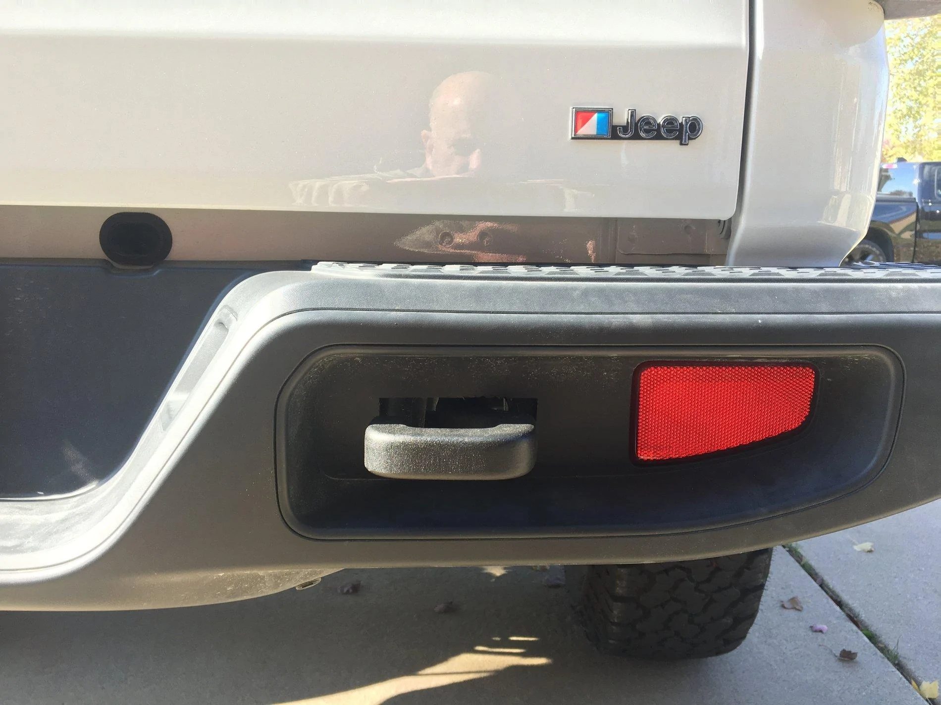

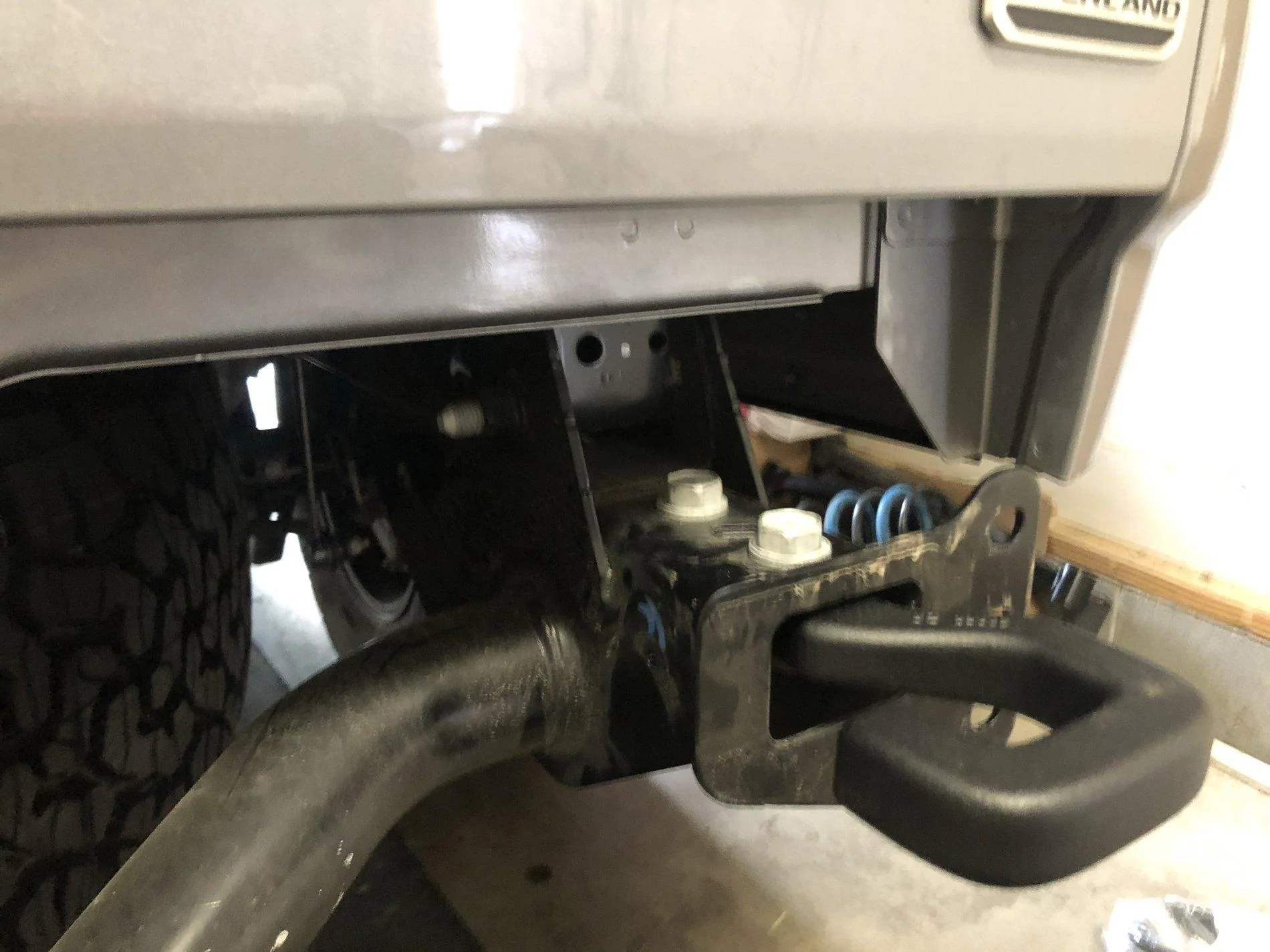

New rear bumper bezel has arrived...and it’s the correct part! It has the cutout. If anyone else wants to do this, below are the part numbers that I ordered. Gonna watch the video that @Jimmy- posted and put this on tomorrow.
68351561AA - Tow Hook - Black (advised that 68334733AA is the red rubicon hook)
6508668AA - (2) Hex Head Bolt and Washer
68342090AA - Rear Bumper Bezel (with cutout)

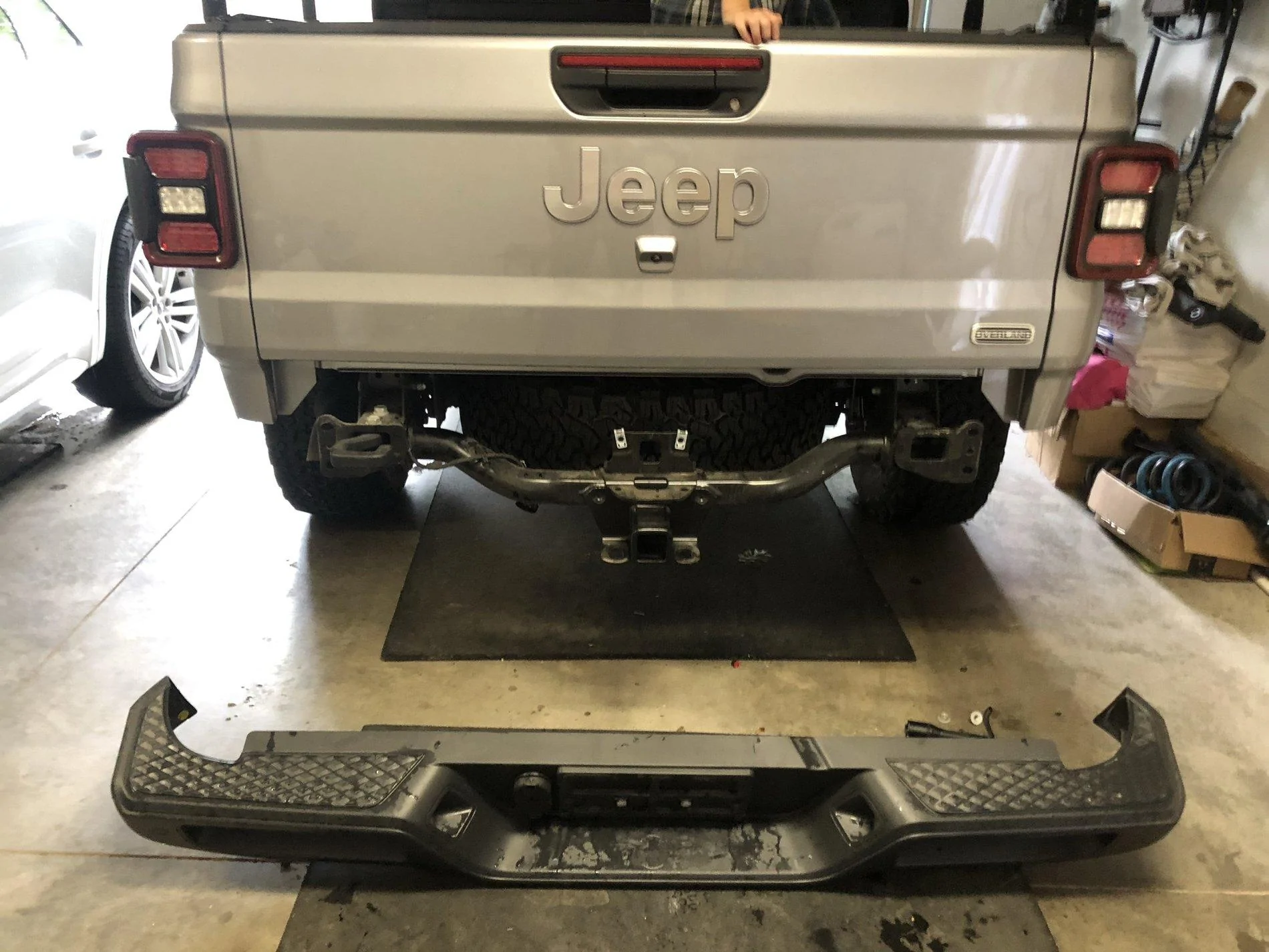

Well, this was a failure. All these part numbers are correct as an FYI. But that plastic bumper is a complex maze of body clips and other fasteners to get to this bezel that I gave up and used my drill and a dremel tool on the original panel. I was afraid the bumper wouldn’t fit back together if I took it apart enough to get to this piece. If someone has a video on disassembling the rear bumper after removing it, that would be much appreciated.

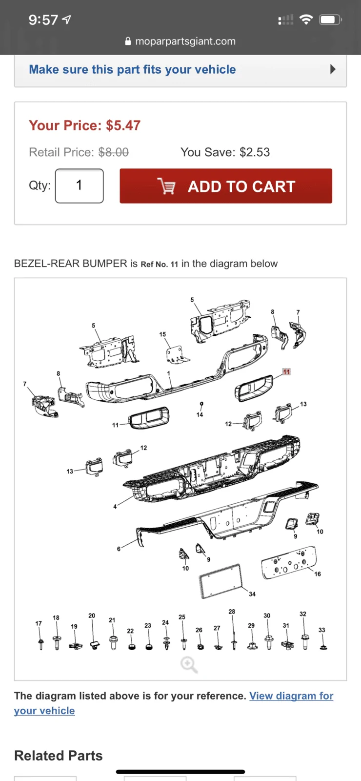

Does anyone know the part number for the passenger side rear plastic bumper tow hook panel? I want to add an additional black tow hook on the passenger side but I want the plastic panel to match the driver's side. Meaning that it’s already cut out.
I've found this part number, 68341764AA. It’s named Rear Bumper Bezel, Right. However I have no idea if right means passenger side or if this one is already cutout for an additional tow hook on the passenger side. Anyone have any insight on this? Search doesn’t seem to be working at all on the site today.

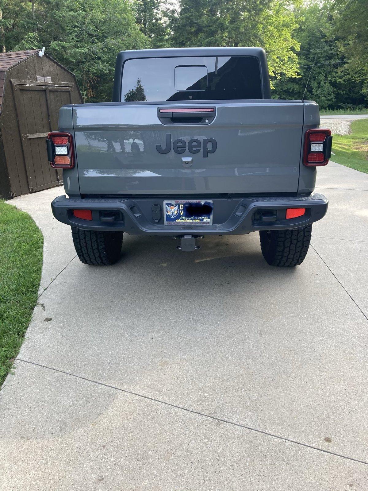

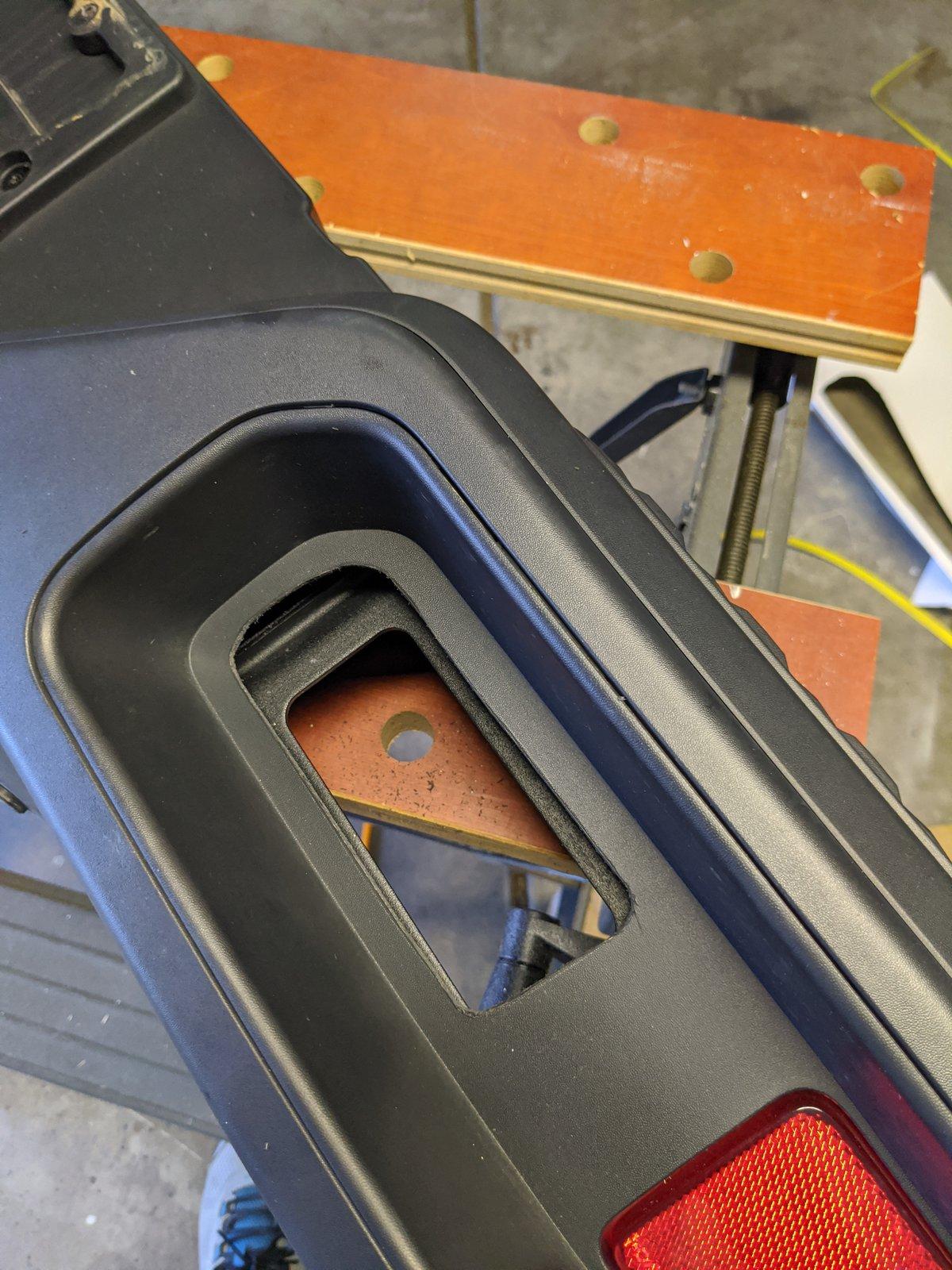

Made my own hole. Turned out pretty good.
Jeep Gladiator Part Number of Rear Bumper passenger Side Tow Hook Panel? IMG_20200906_165616
Jeep Gladiator Part Number of Rear Bumper passenger Side Tow Hook Panel? IMG_20200907_192824

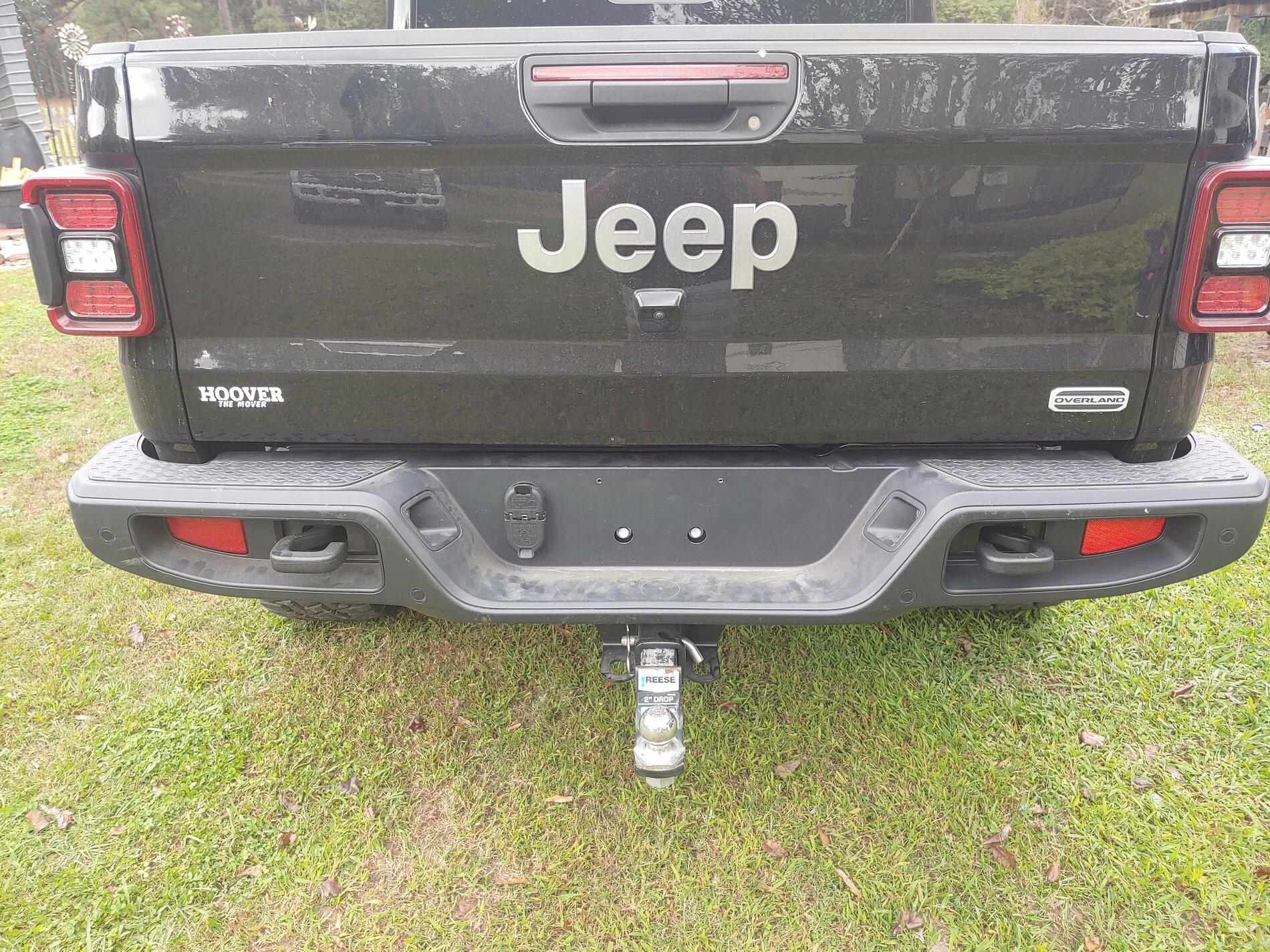

Yup I ordered the cutout trim piece too and it was a disaster. So I just cut out the plastic. No way was I gonna spend time tearing that whole bumper assembly apart
Jeep Gladiator Part Number of Rear Bumper passenger Side Tow Hook Panel? Passenger side rear tow hook_2
That bumper is a disaster to take apart!

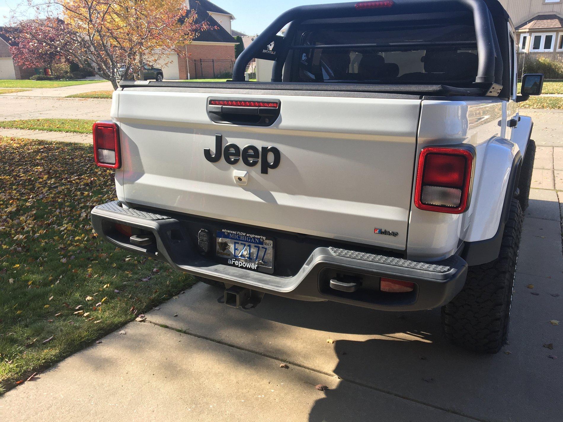

Just for the people that wanna use the plastic. Bumper and the other tow hook it can be done. It's a pain but takes about a hour. The parts listed are the correct parts except the bolts. Somewhere or another they changed the part number.

Just for the people that wanna use the plastic. Bumper and the other tow hook it can be done. It's a pain but takes about a hour. The parts listed are the correct parts except the bolts. Somewhere or another the changed the part number. F
Wow, do you have the new part number so I can update the thread? The part number I listed definitely was correct at that time

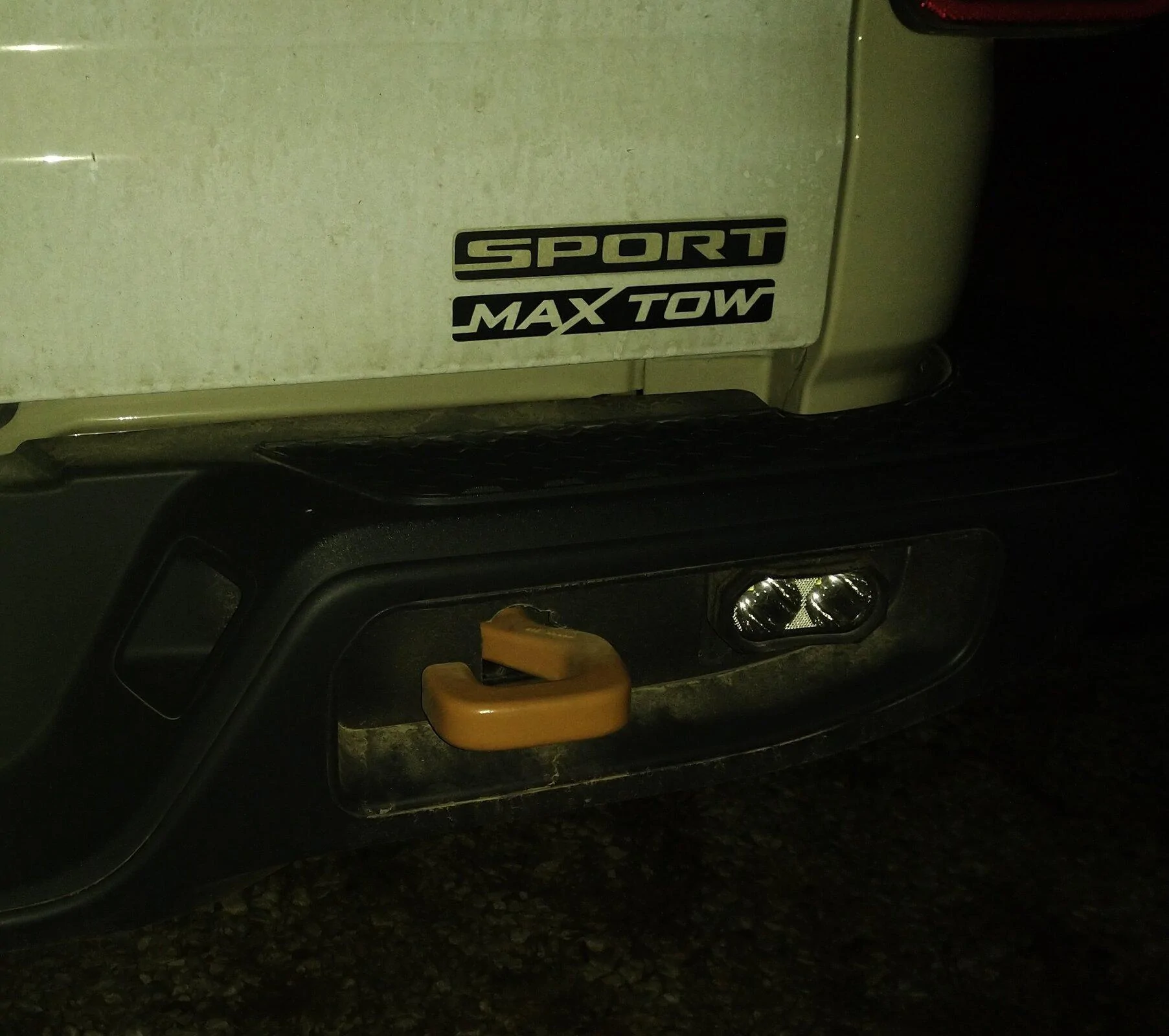

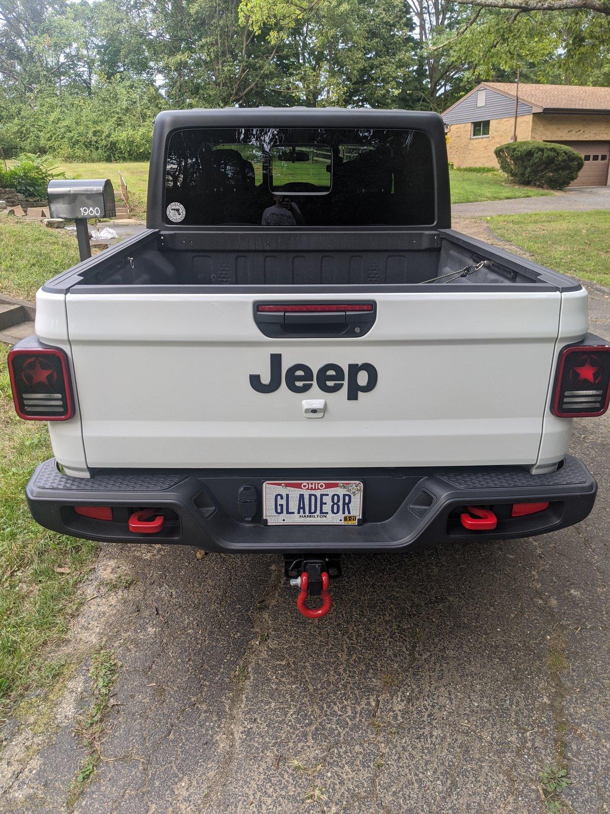

I just went with the "screw it and grabbed a hole saw bit then trimmed it out some with a box cutter. ;) after fighting them dang two bolts, I was done with it.
Jeep Gladiator Part Number of Rear Bumper passenger Side Tow Hook Panel? IMG_20201026_191923~2
But I decided to not follow the crowd with Sport /Overland black, Rubicon red or Mojave orange. So carmel brown.... :like:
