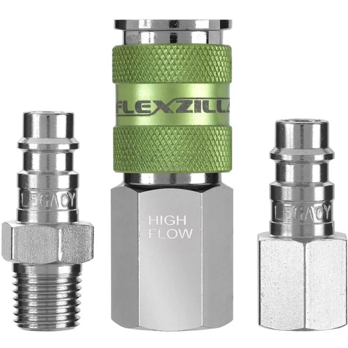

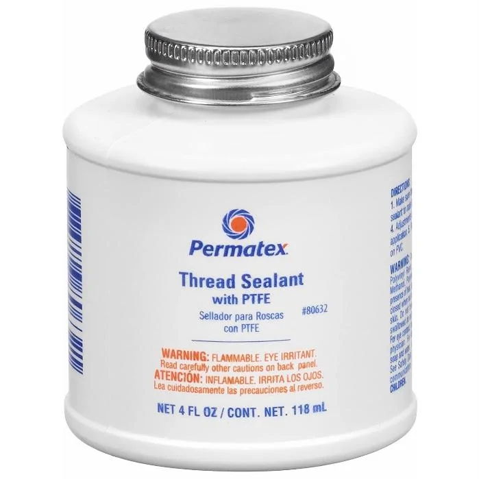

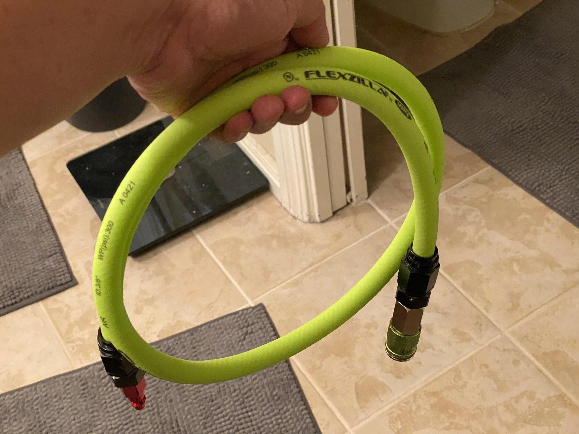

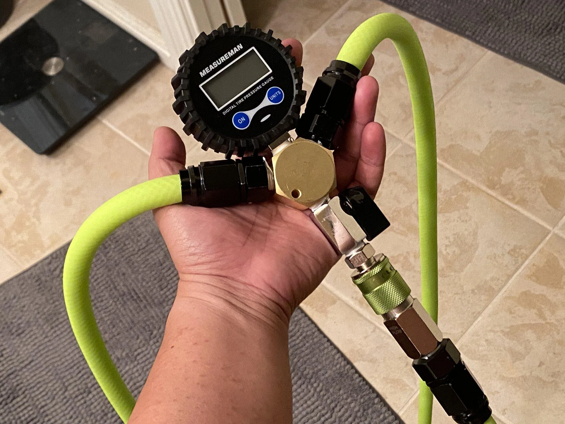

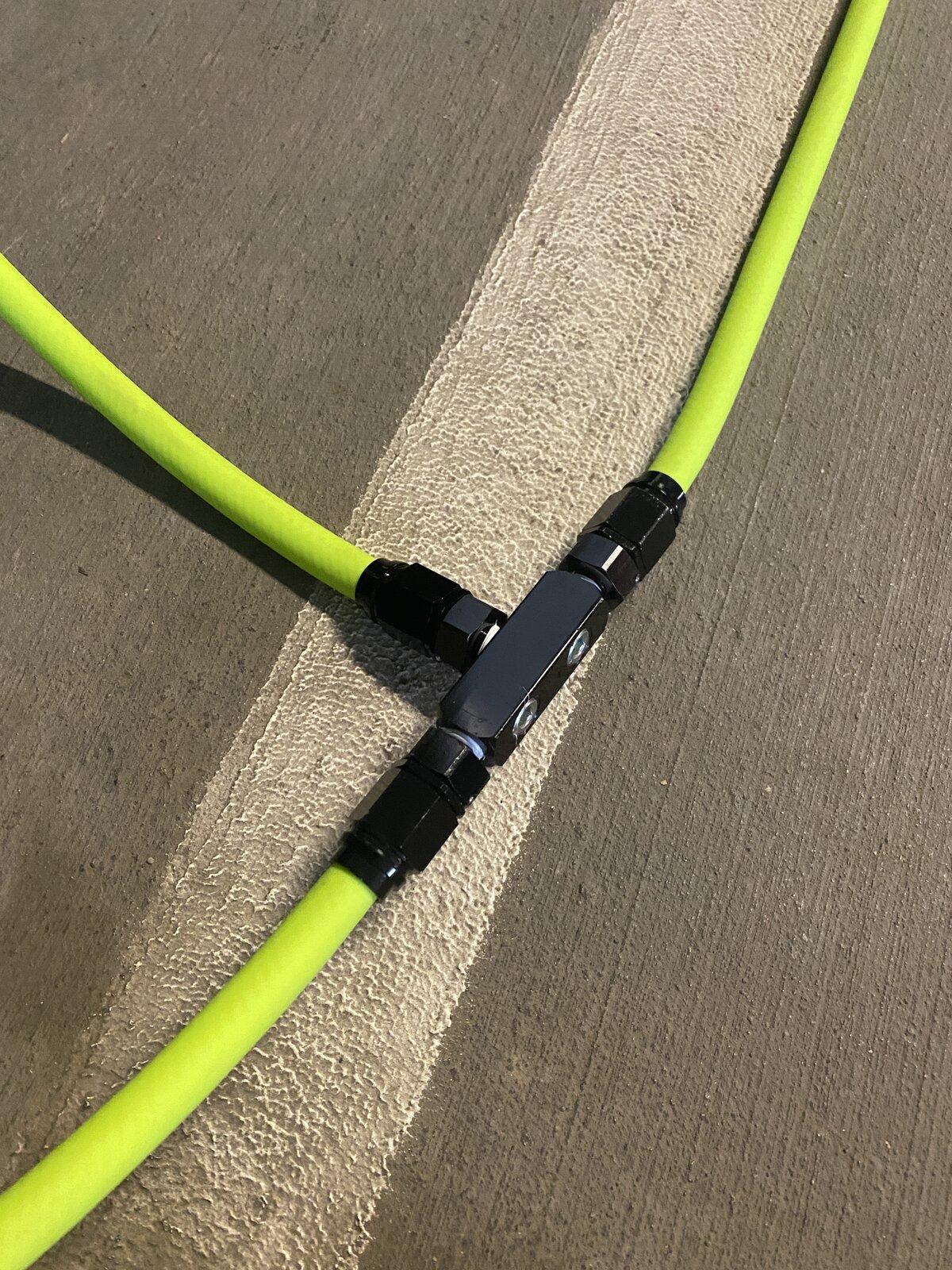

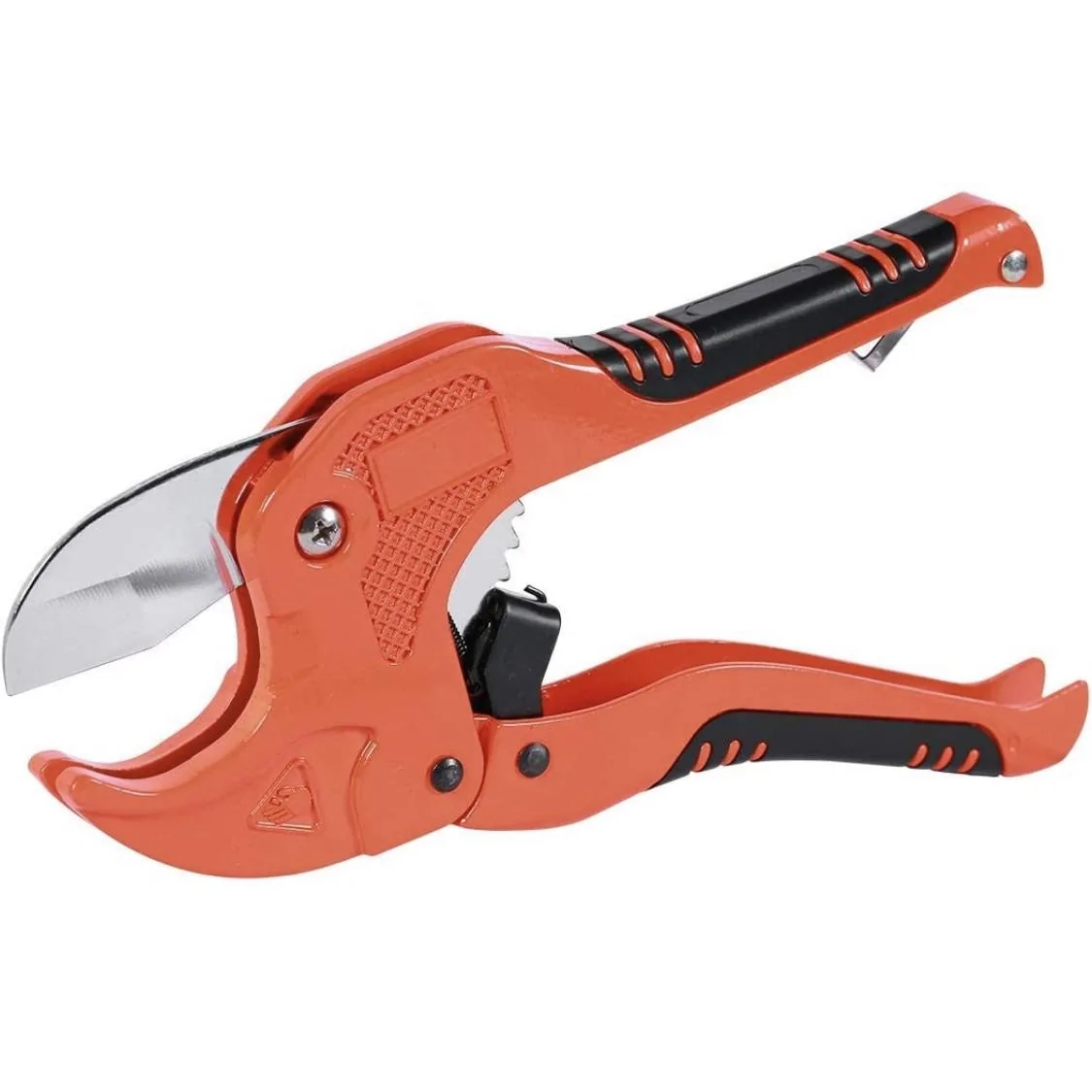

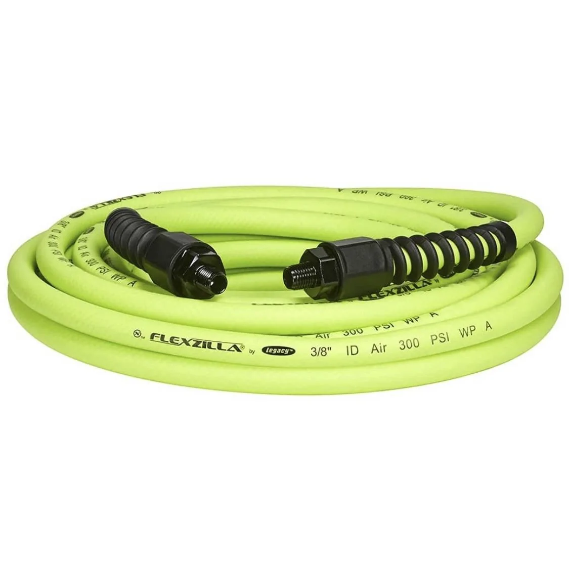

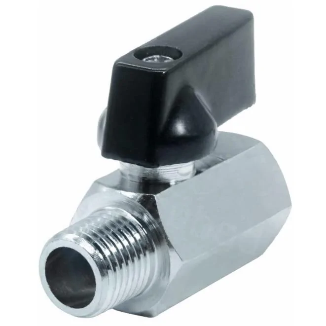

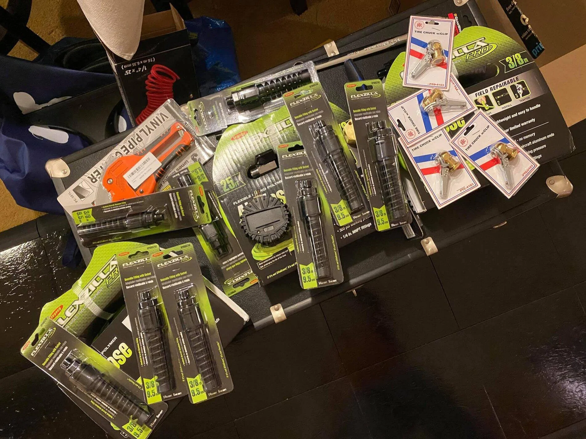

Parts ordered to make a 4 Tire Inflation system

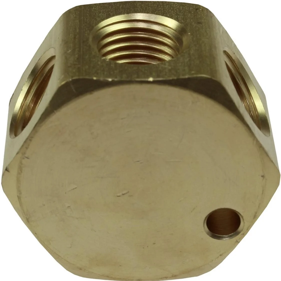

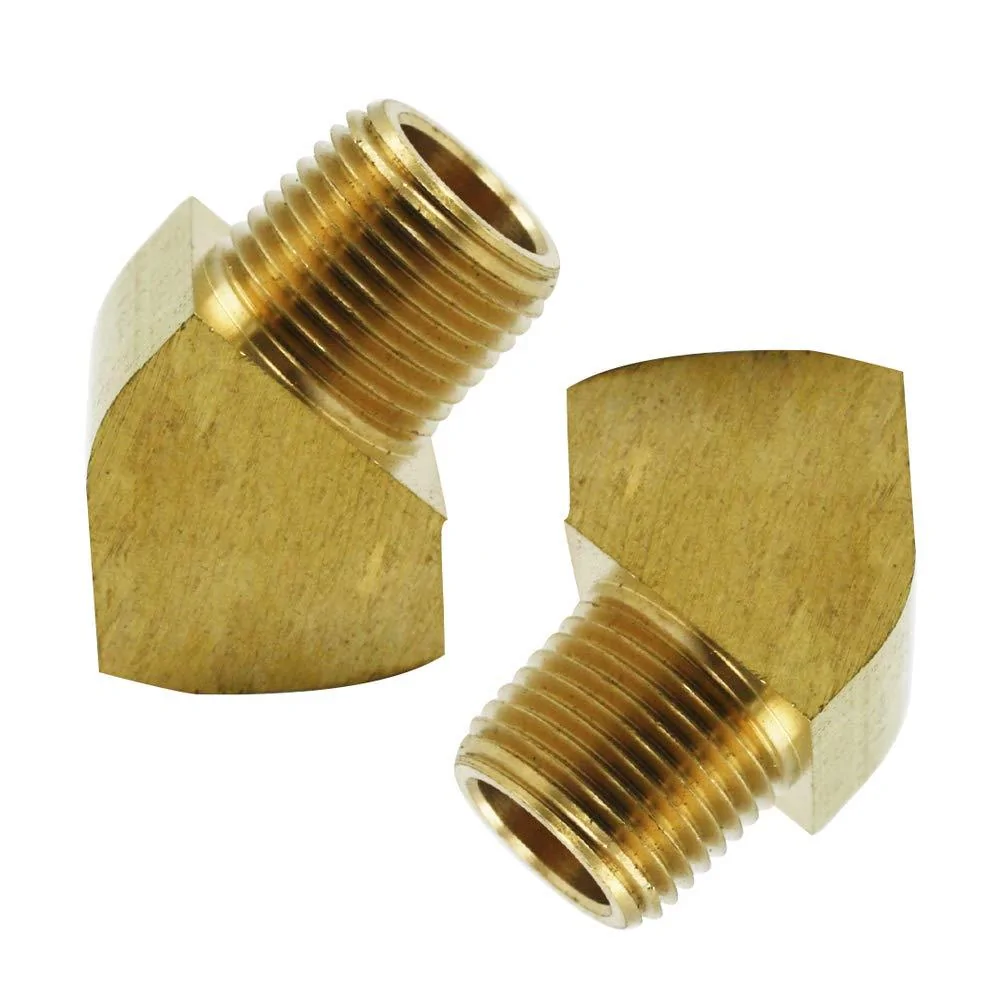

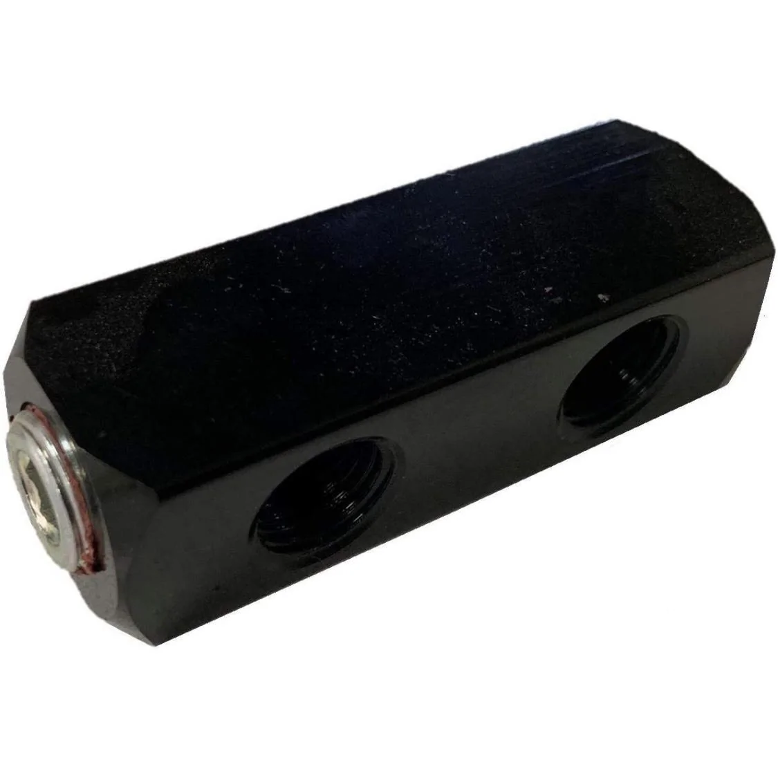

All parts sourced from Amazon
Jeep Gladiator Parts ordered to make a 4 Tire Inflation system IMG_0125
Jeep Gladiator Parts ordered to make a 4 Tire Inflation system IMG_0126
Jeep Gladiator Parts ordered to make a 4 Tire Inflation system IMG_0128
Jeep Gladiator Parts ordered to make a 4 Tire Inflation system IMG_0130
Jeep Gladiator Parts ordered to make a 4 Tire Inflation system IMG_0131
Jeep Gladiator Parts ordered to make a 4 Tire Inflation system IMG_0136
Jeep Gladiator Parts ordered to make a 4 Tire Inflation system IMG_0133
Jeep Gladiator Parts ordered to make a 4 Tire Inflation system IMG_0134
Jeep Gladiator Parts ordered to make a 4 Tire Inflation system IMG_0135

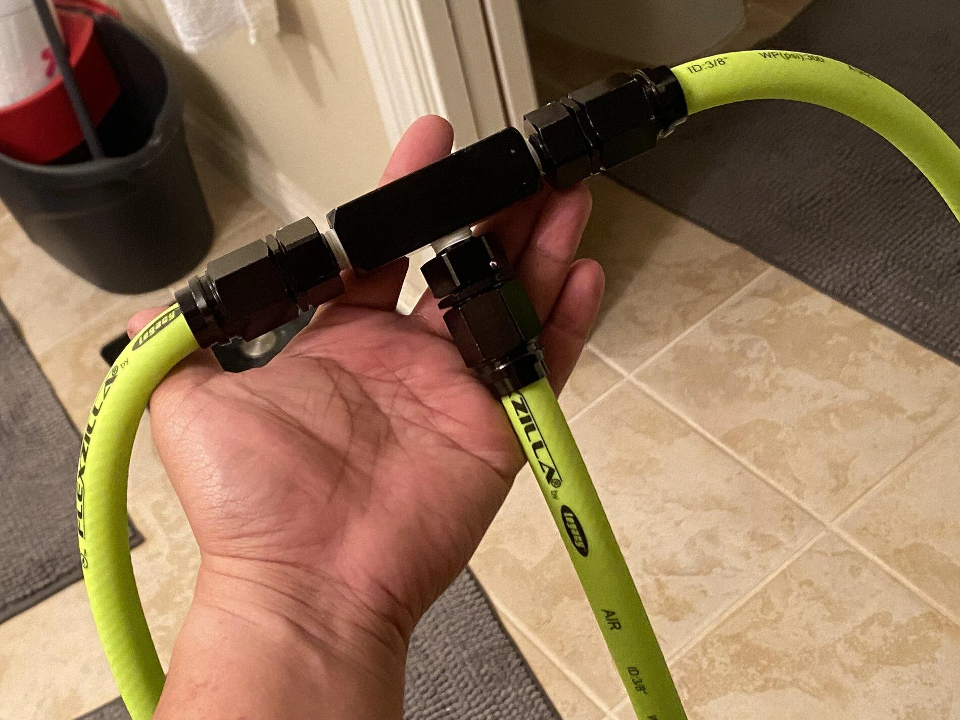

Snap.. you went fancy.. I went with hybrid line too, but I went cheap with it. Still ended up spending a pretty penny on mine. Heres the thread I did. https://www.jeepgladiatorforum.com/forum/threads/my-take-on-a-4-tire-air-up-down-system.46982/
of note.. I have not been out at all without people commenting on the setup. The air down process is stupid fast & airing up I end up being well over twice as fast as most other folks with the set it once & walk away nature & the extra fitting to connect the 2nd compressor.

Yeah
I could have bought two Speedflates with how much I spent. But I enjoy the journey not the destination.

Yeah
The speedflate nor any other pre done system served what I wanted. I was already using 2 compressors to fill up. So I wanted to be able to keep doing just that. The only real thing I dont like is that I made all the lines too long. That will be fixed whenever I get around to it though. Just gotta take the leads off the T's running front & back & then take a few feet, re-attach & then add new heat shrink to keep it looking pretty.

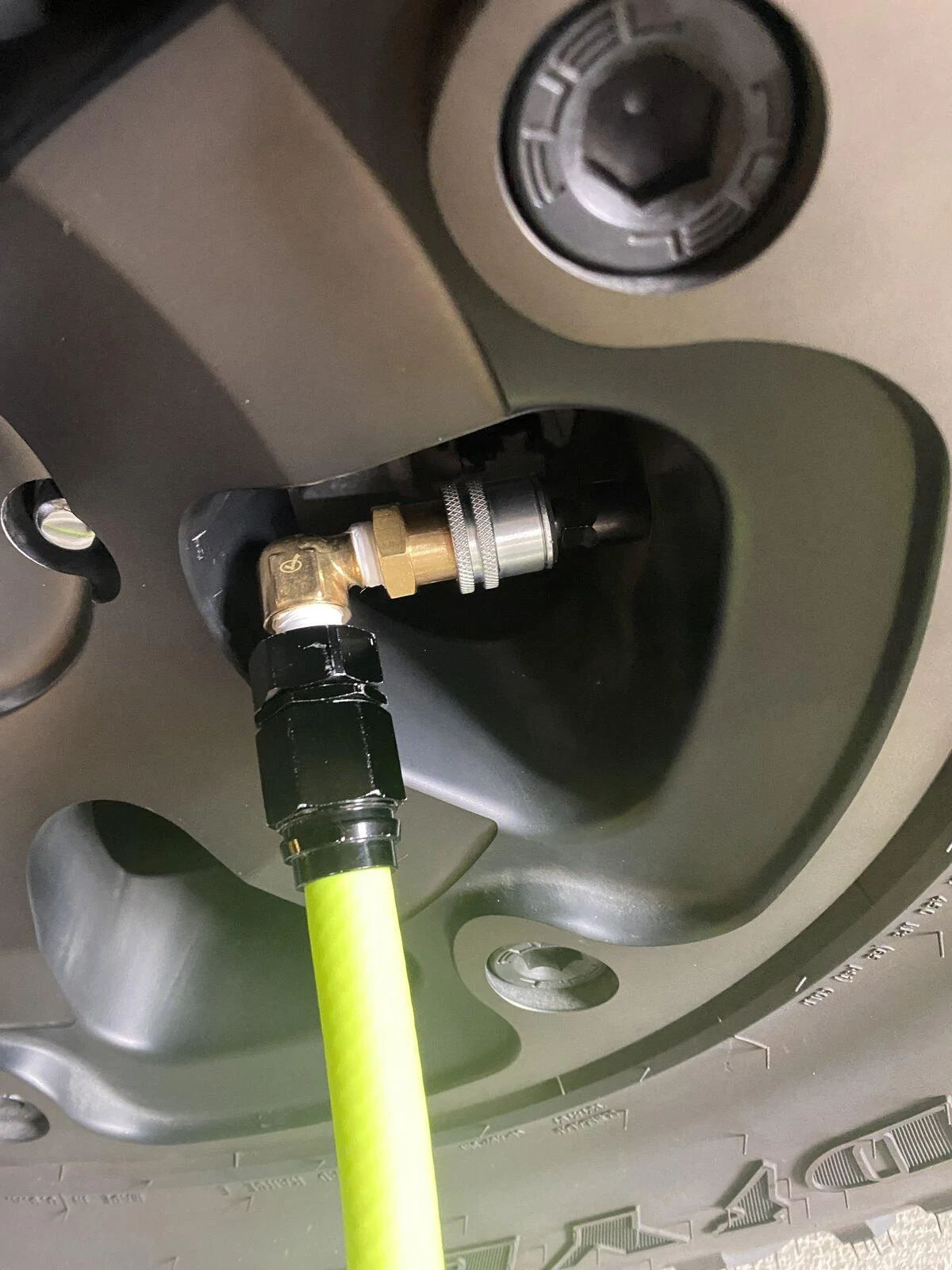

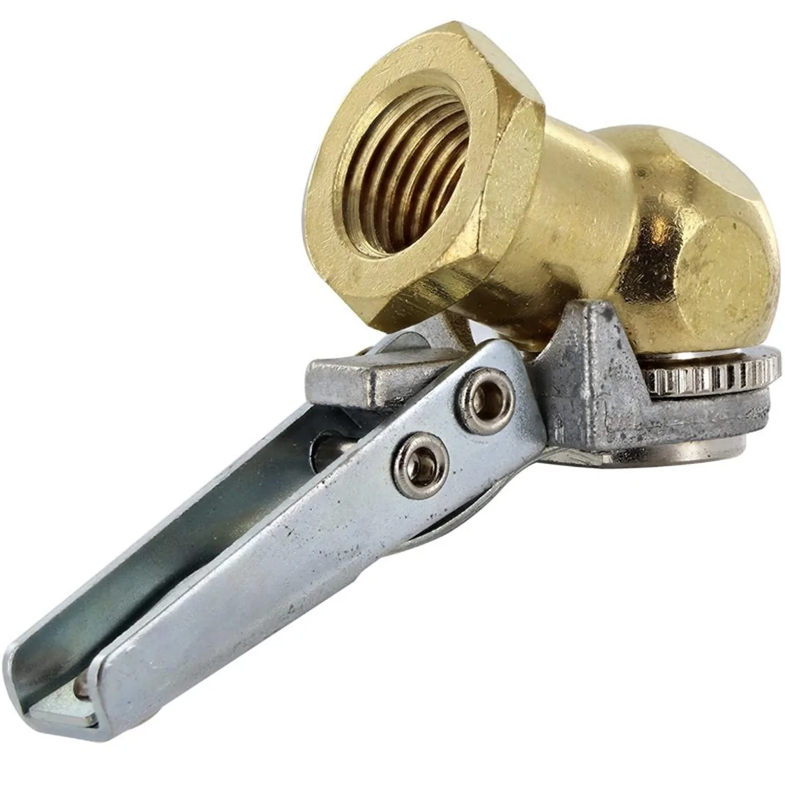

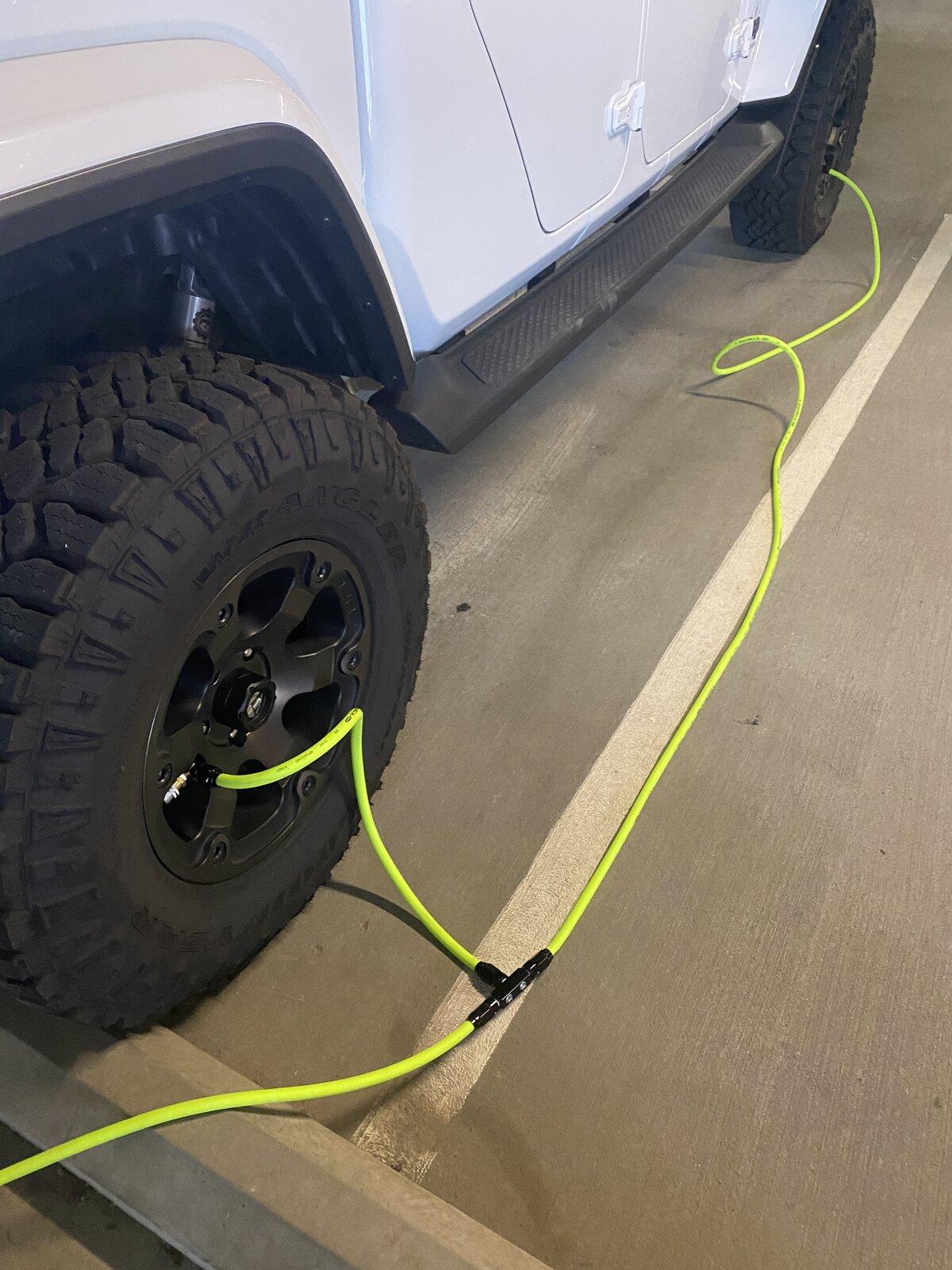

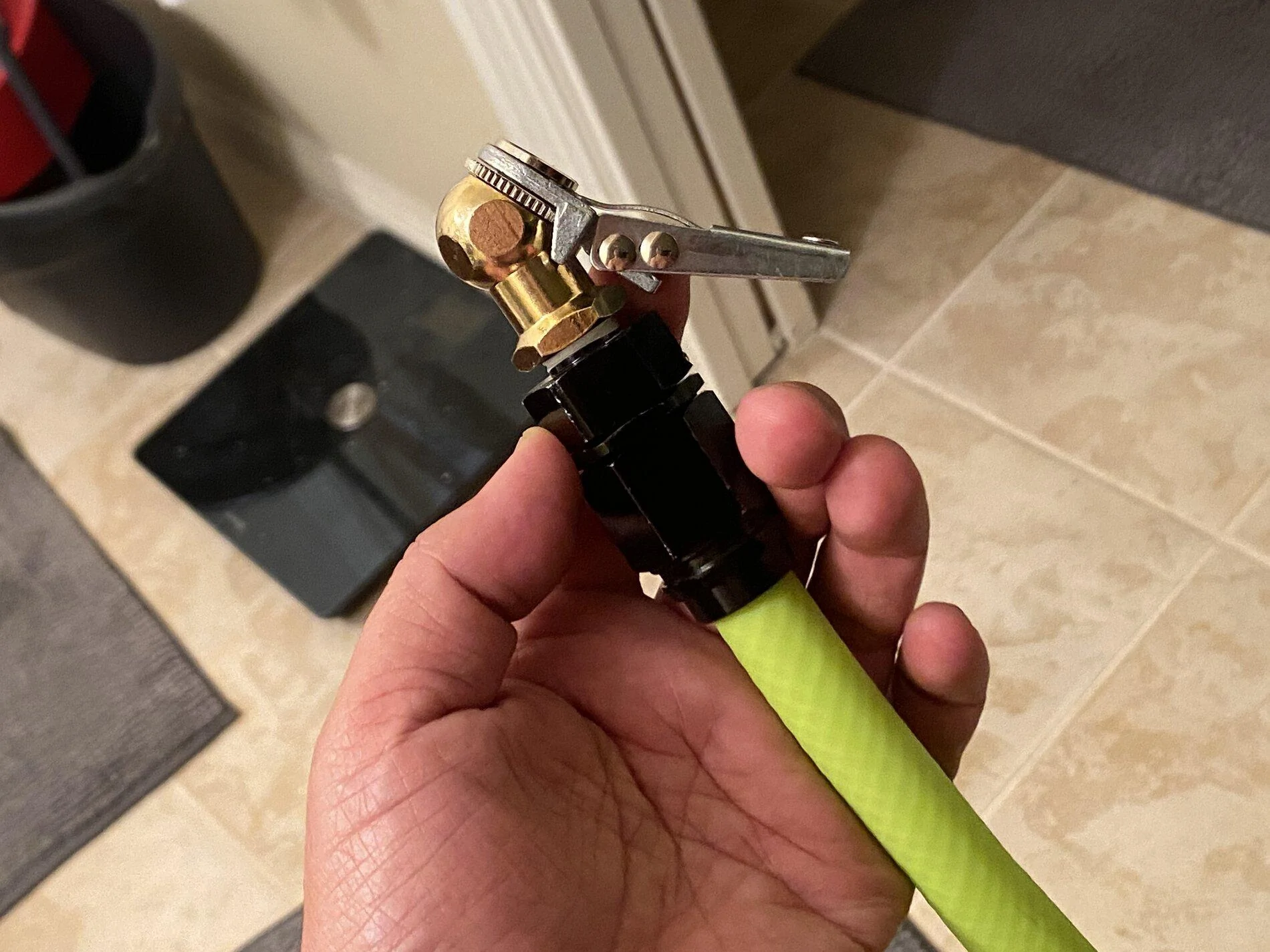

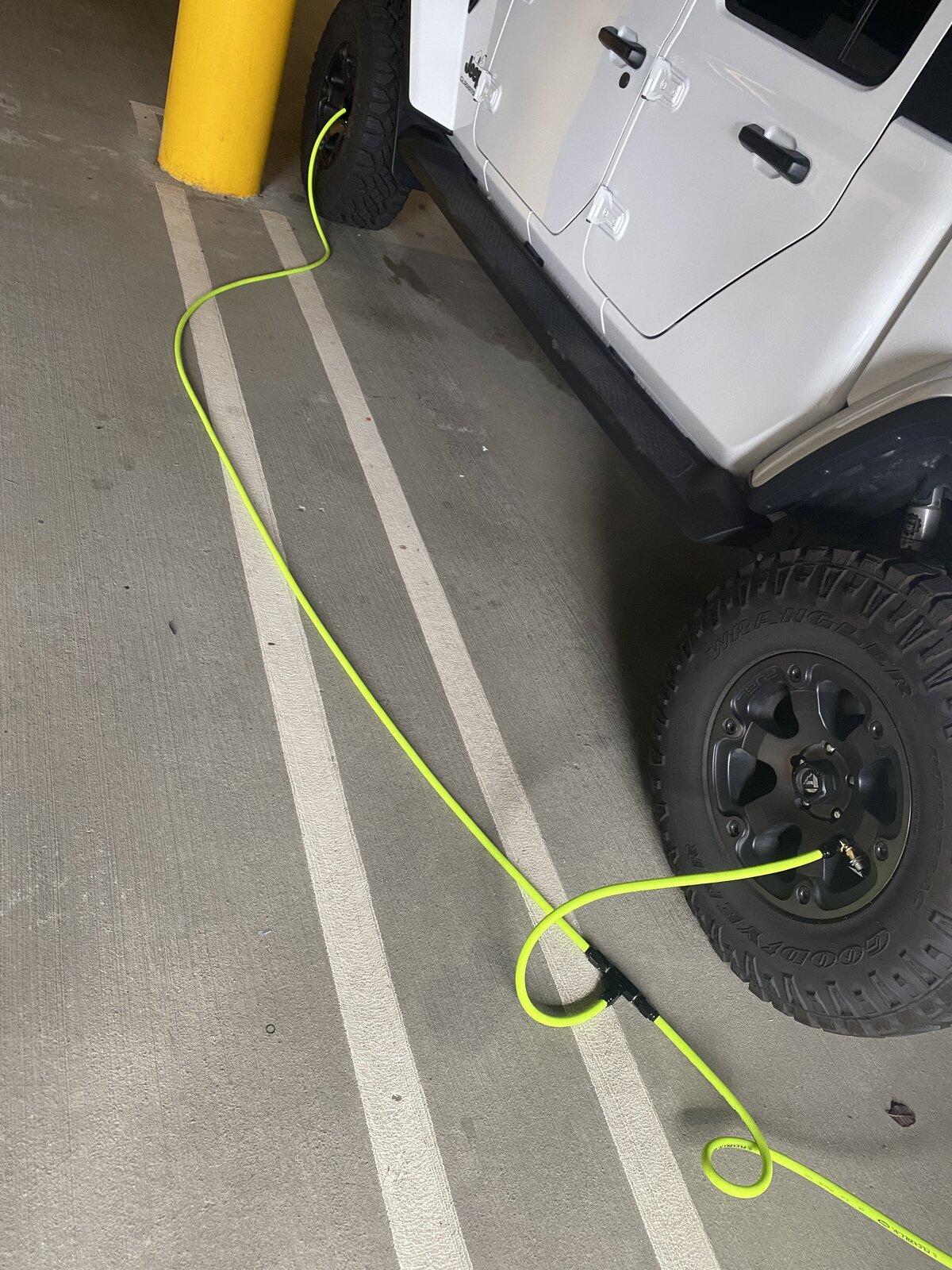

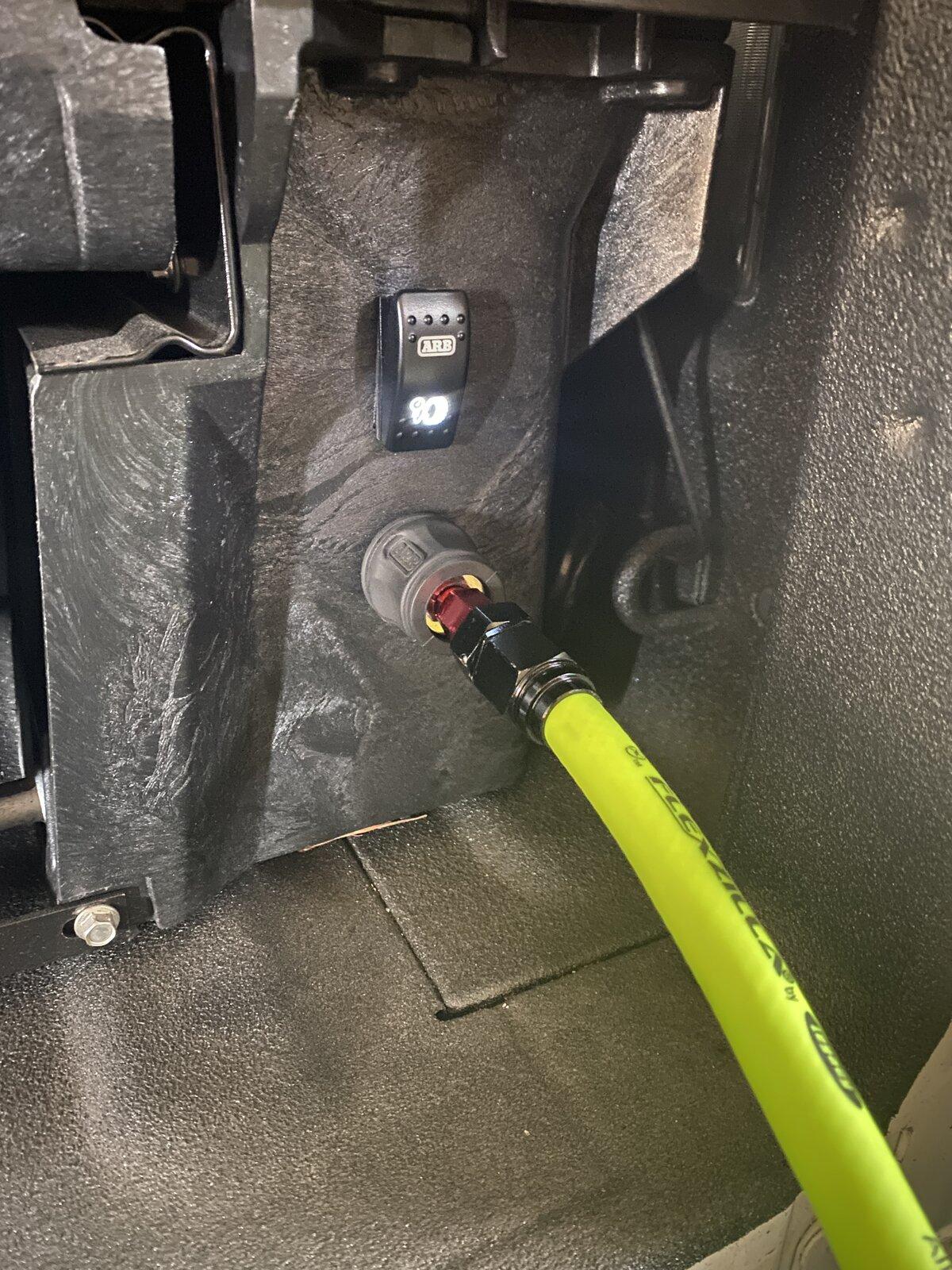

Works but with one problem, actually 4. The valve stems on my wheels point inward towards the hub. Valves stems are protected from being snapped off but are nearly impossible to get a straight locking air chuck on them, so I had to use 45° angle air chuck. These chucks don't hold a seal very well so I'm working on a fix.
Jeep Gladiator Parts ordered to make a 4 Tire Inflation system IMG_0205
Jeep Gladiator Parts ordered to make a 4 Tire Inflation system IMG_0204
Jeep Gladiator Parts ordered to make a 4 Tire Inflation system IMG_0203
Jeep Gladiator Parts ordered to make a 4 Tire Inflation system IMG_0202
bastage
Apr 8, 2020
1,371
1,260
Idaho
Those air chicks are far better then normal ones. I don’t think you will want or need the 45’s with those and the hybrid hose. Pretty much you just point and push and with 45’s you will need to pay attention to the hose angle and turn it the right direction.
edit: I just looked at your vehicle showcase. Only one pic can I spot what looks like the valve in your wheels and it looks to be in a very stupid place. So if I’m seeing it right I totally get the 45’s now.

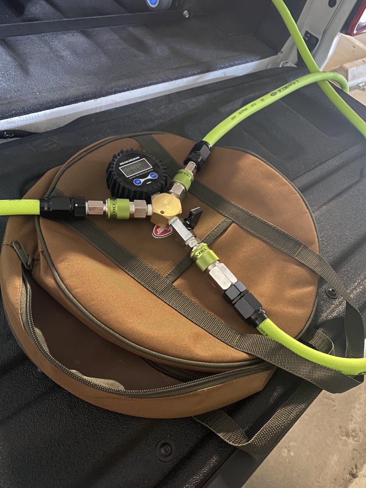

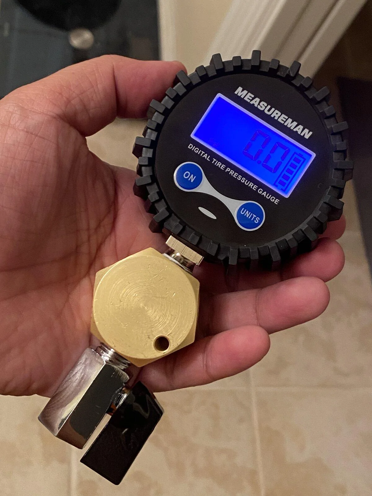

Final revision works a treat now with the right chucks.
Jeep Gladiator Parts ordered to make a 4 Tire Inflation system IMG_0235
