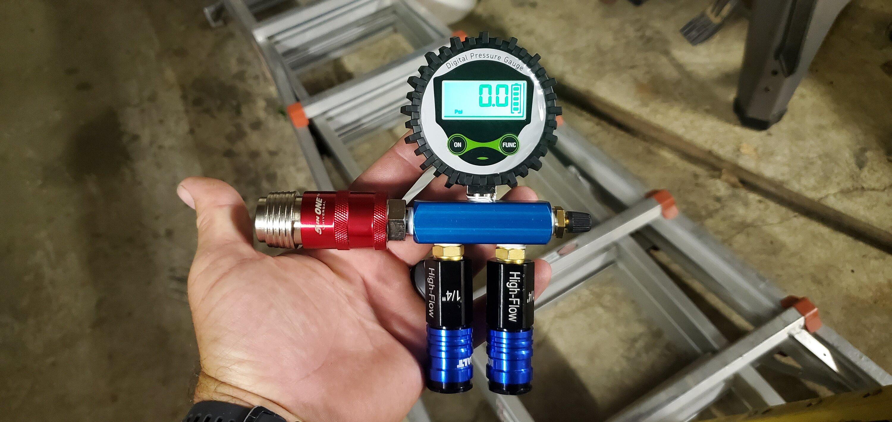

Got all the parts and put it together. It works exactly how I thought it would, so far.
Jeep Gladiator DIY 4 tire air up/down system question...use a safety exhuast coupler?? 20220616_205305
Piss poor video, especially since I had it connected to my shop compressor and no tires or tire air leads. But it does show how I can exhaust the compressor air, instead of putting it into the manifold/tires. Then I could get an accurate pressure read, if more pressure is needed just slide/divert the pressure back I to the manifold/tires.
