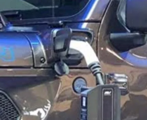

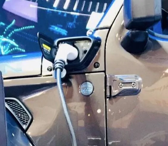

Since creating this post on May 10th, I've been brainstorming this with my custom body shop in Oklahoma City: https://tricitycustoms.com/ (Call and speak to Rob; owner and owns a Jeep Gladiator too). Reference me (Kent Mitchell) and it will save you alot of time as I have been discussing this website with them too.
After discussing with them and the Jeep Dealership in our area, I am researching something out of the box, but will look cool.
My plan is to use the new 4XE Charging Plate on the new Jeeps, see attached pic. Opening up the outside cover, there is a charging port that we would be replacing.
I have the part on order. ($80 unpainted) When it gets here, the body shop is going to drill 2 holes in the plastic area. Having the Hard Black Plastic Cover, it would just look like the new Jeep Hybrid models, so not a eyesore either.
Once I get the part and confirm it is the correct piece, I will paste the pic and info here.
Jeep Gladiator Fabrication - Air Compressor Coupler - Thinking Outside the Box 4xe Cover
That certainly seems the way to go. It looks like there will be tons of room to work with, and the covered door is great from both a practical (protection) and appearance value.
Jeep Gladiator Fabrication - Air Compressor Coupler - Thinking Outside the Box e1
Jeep Gladiator Fabrication - Air Compressor Coupler - Thinking Outside the Box e2
Jeep Gladiator Fabrication - Air Compressor Coupler - Thinking Outside the Box e3

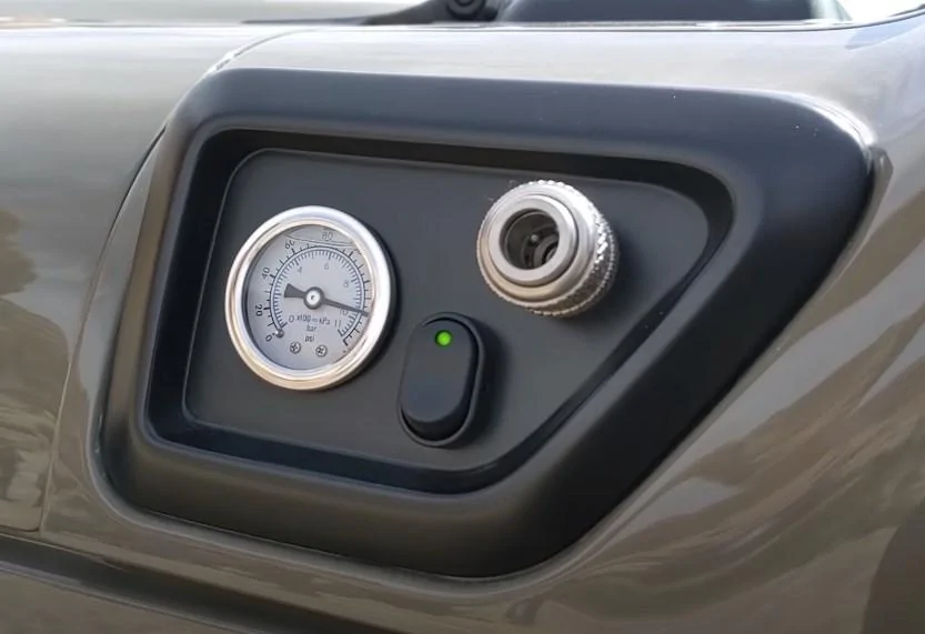

I'd probably be sitting next to the tire with my inflator which has a gauge on it. I think a quick coupler and a switch is all I'd need to put under that cover plate. With that said, if rugged ridge would sell just the cowl for the snorkel, it looks like most of the work would already be done.
Don't see why this setup wouldn't work just as good on the passenger side.

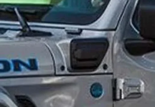

My JK is a 2020 Gladiator Sport.
I had the Snorkel initially (Thumbnail pic); however I have given that away to a friend. The dealership ordered and repainted the plate for me.
I believe the Snorkel option was only on the passenger side and the 4XE Charging panel is on the Driver Side; so 2 different plates. I don't think Jeep makes a 4XE plate for the passenger side, but I could be wrong.
I am still waiting on the Jeep Dealership to find the part that I need; Once identified, I will post here. If someone finds it, please add it too.

I have also been trying to find this part. I spent about an hour at a dealership last week with the parts guys looking and calling everyone they could. They could not find a valid part to order yet. We found the electric harness but not the cowl piece.

A very clear photo of the Wayout's panel.
Jeep Gladiator Fabrication - Air Compressor Coupler - Thinking Outside the Box wayout
