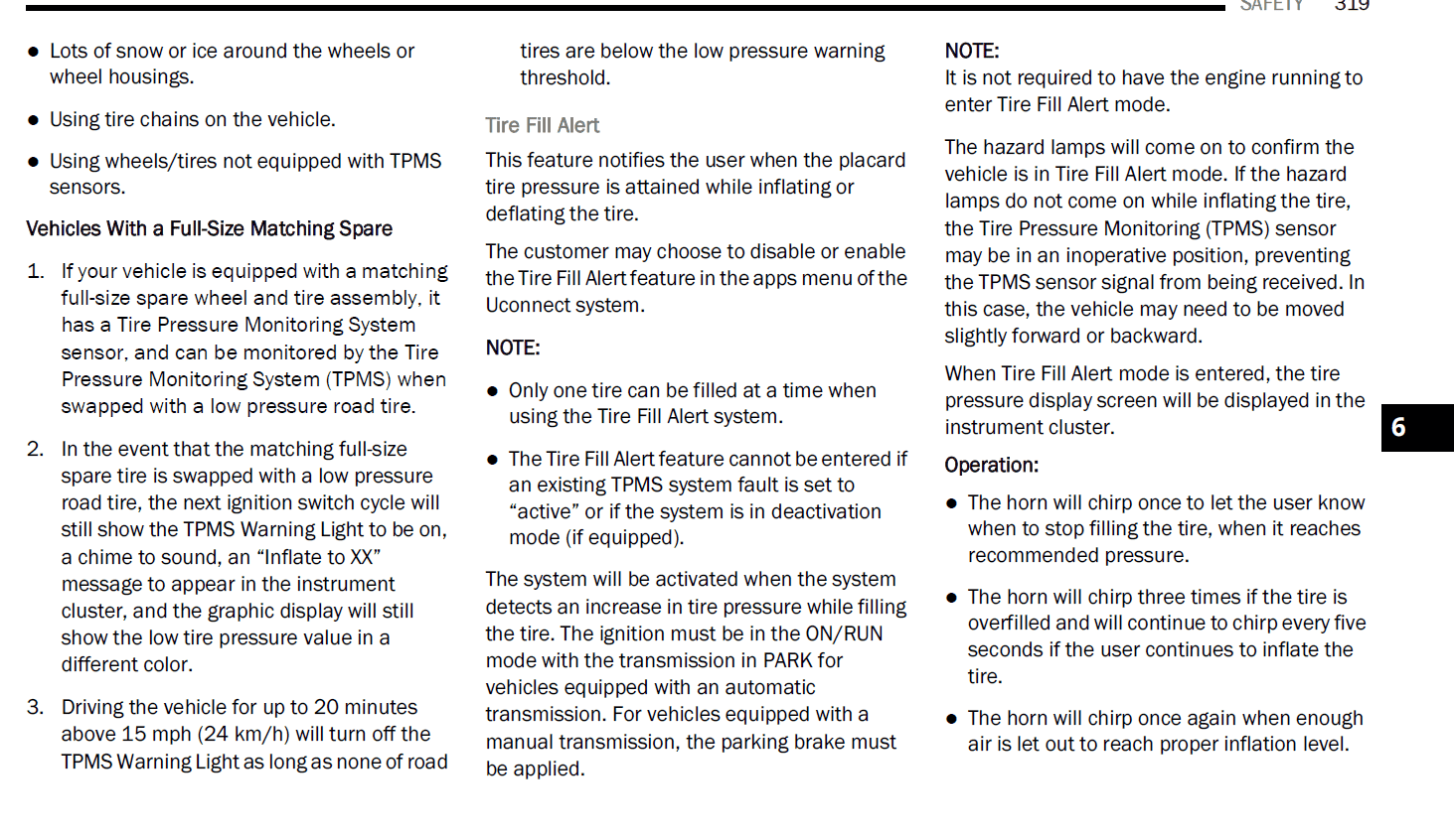

Wait what? the tire fill smart alert isn't on yours? One thing I do have to turn it on in 'settings' every time but I'm in a later '21 Mojave. I thought everyone had this. Honestly one of my favorite features, no guessing games, don't need expensive deflators, only have to turn the compressor on once for each tire....
I'll double check, but I swear I couldn't find it last time I looked.
And I have to drive a few hundred yards for the pressures to update.

If you have the old TMPS sensors it updates live, I have the tire fill assist with mine and is surprisingly accurate.

My '22 does not have tire fill alert/assist. I even fought with the dealership to turn it on since it was on my sticker, but the new TPMS sensors and switching to the RF hub instead of dedicated TPMS "hub" removed this feature, sadly.
I even tried with AlfaOBD and JScan and no love with either one. I was super disappointed not to have this, but I've learned to live without.
My TPMS reading on the cluster -does- update live, even when sitting still, though. About a 1-second delay.

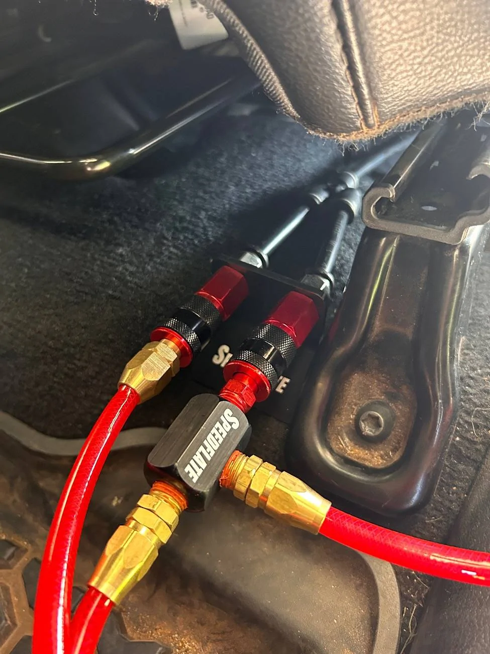

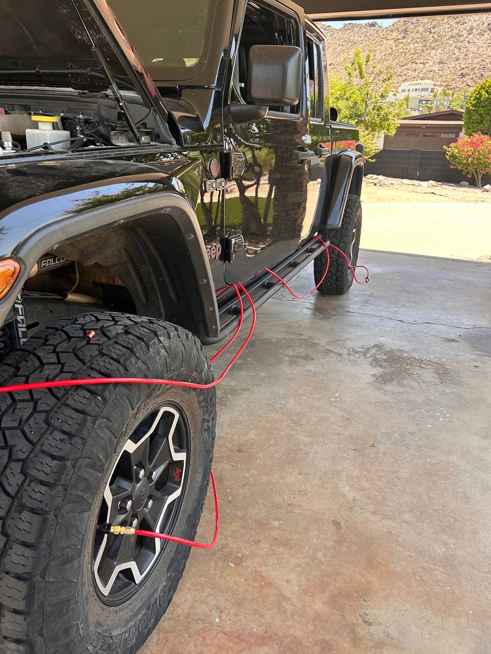

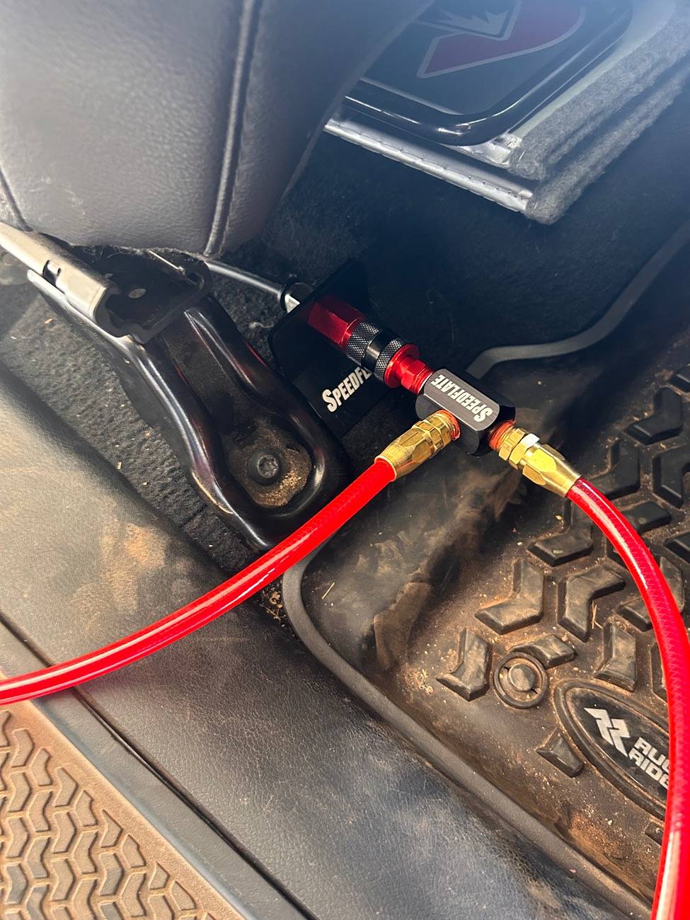

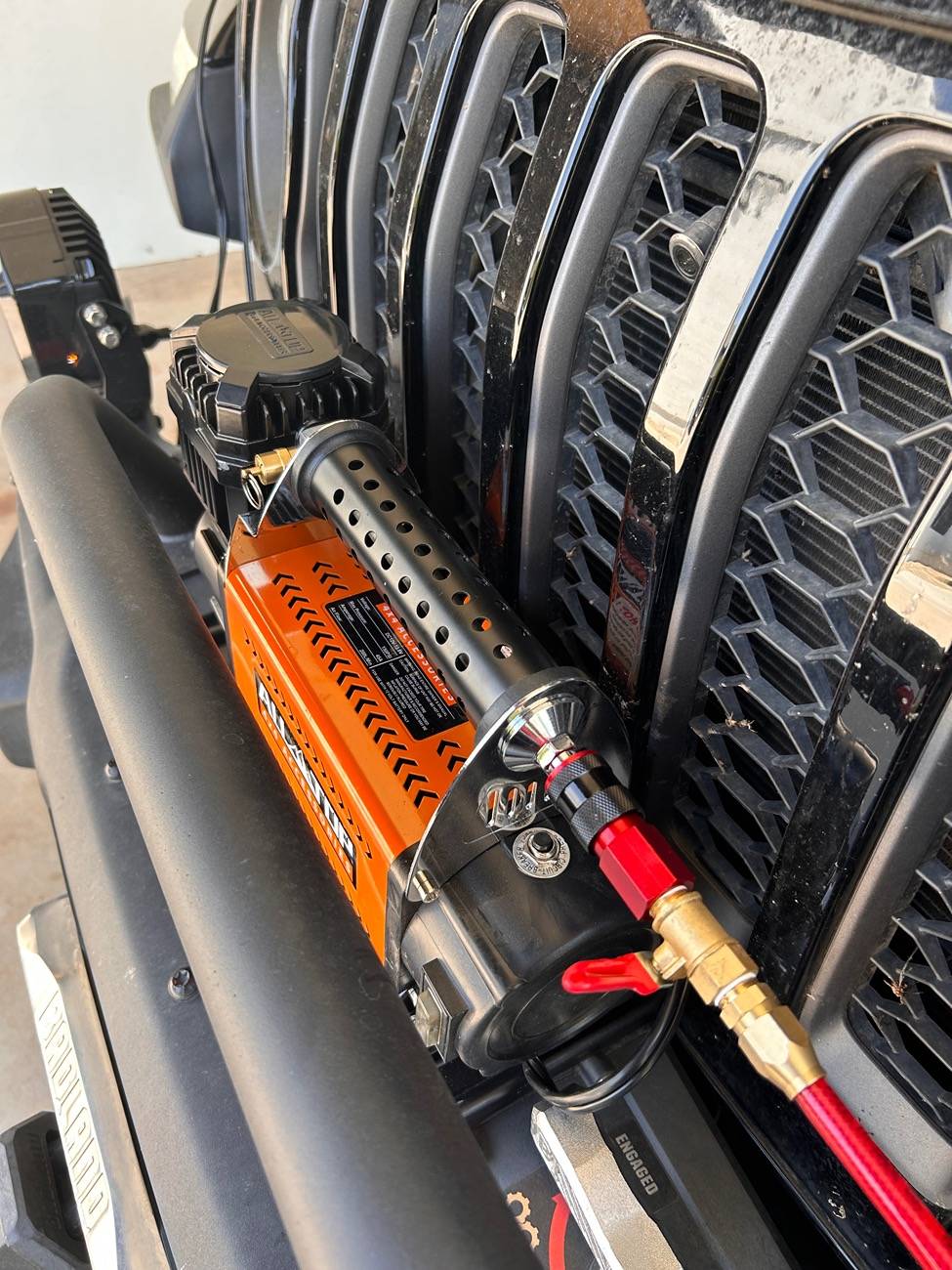

I installed this Speedflate VSUS 4X system today. Parts are quality and the setup was easy. TJ, the company owner, was great to work with and he modified the fill hose to be longer for my needs, so I very much appreciate that.
I’m running Toyo ATIII 35x11.50x17
I’m using an All Top 200L/min portable compressor with this system.
Took me 2:05 to air down from 30 to 15 PSI
Took me 3:50 to air up from 15 to 30 PSI and 4:20 total to get up to 32 PSI.
For me, the air down is definitely quicker than using tire deflator valves I have been using. The air up isn’t significantly quicker but is much more convenient.
Perhaps most importantly this caters to my OCD and I can get all the pressures exactly the same!
