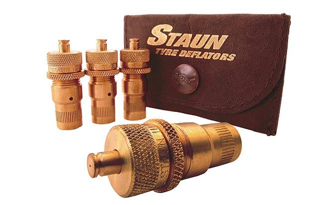

Just ordered a set of Staun standard duty tire deflaters. Hitting the beach in a few weeks!

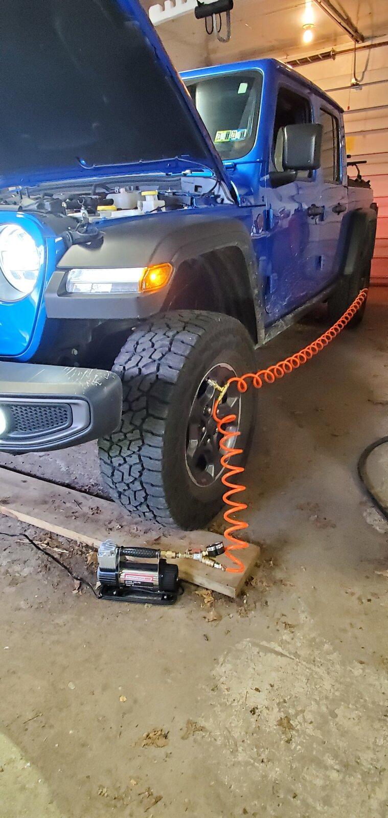

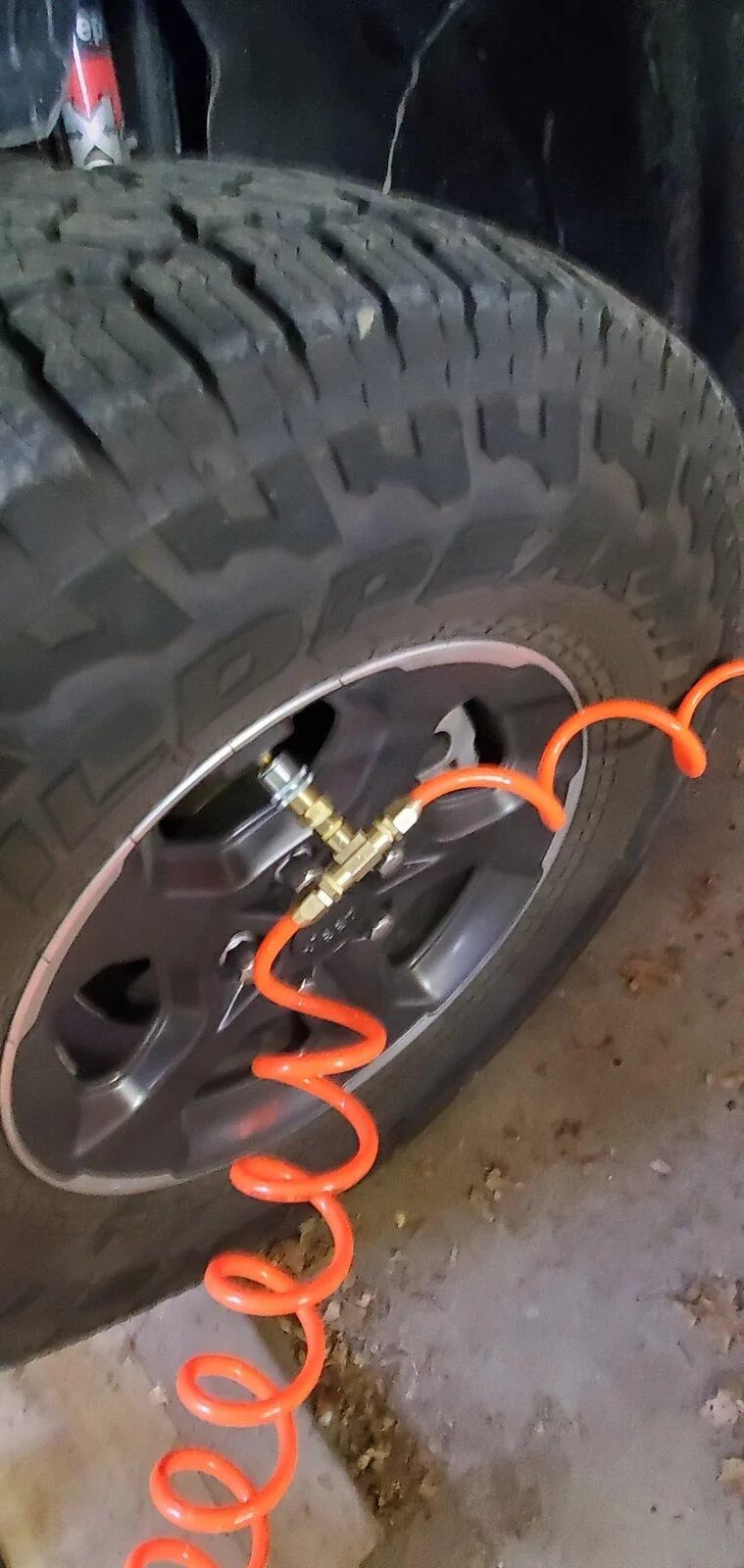

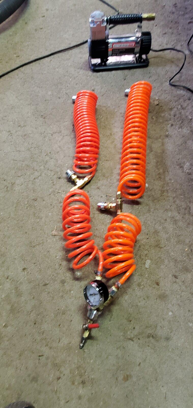

I did a diy deflate/inflate system. I don't recall how much $ I put into it...slightly under the Speedflate system.
Deflates a 4 oem rubicon tires at once in 2 minutes and 25 seconds (35 psi to 18 psi). Inflates with a Harbor Freight pump in 12 minutes and 30 seconds
Jeep Gladiator Airing Down? 20210109_150140
Jeep Gladiator Airing Down? 20210109_150148
Jeep Gladiator Airing Down? 20210109_162225
