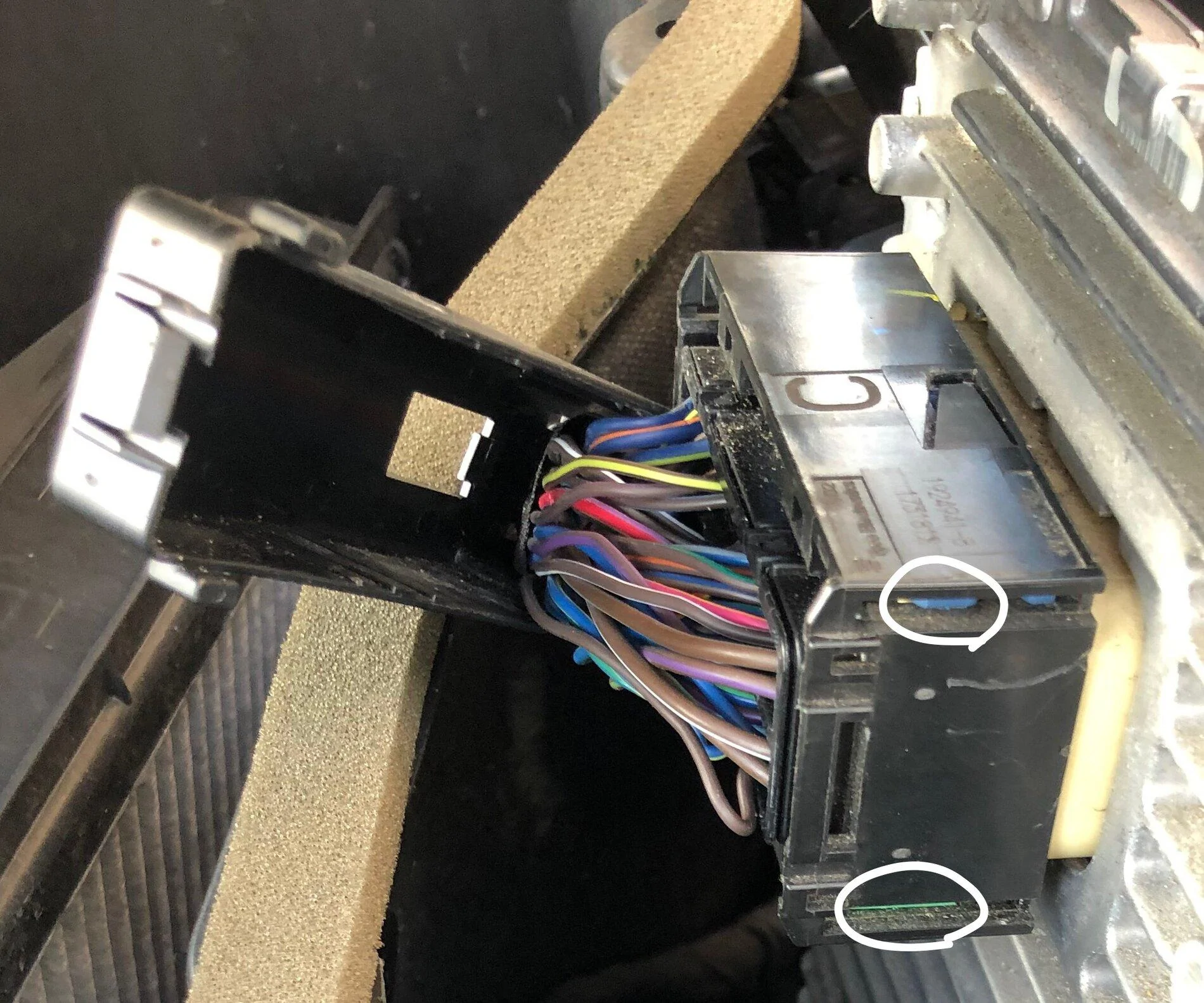

Jeep Gladiator PCM Disconnect Not Working, Any Tips? A3EBB5B4-A7C3-4F7C-94AE-680561DD3BBD
I found this picture on a Charger forum. Just poke a pocket flathead from the top to unlock the connector. Getting it back on is going to be annoying. There is limited room and visibility.

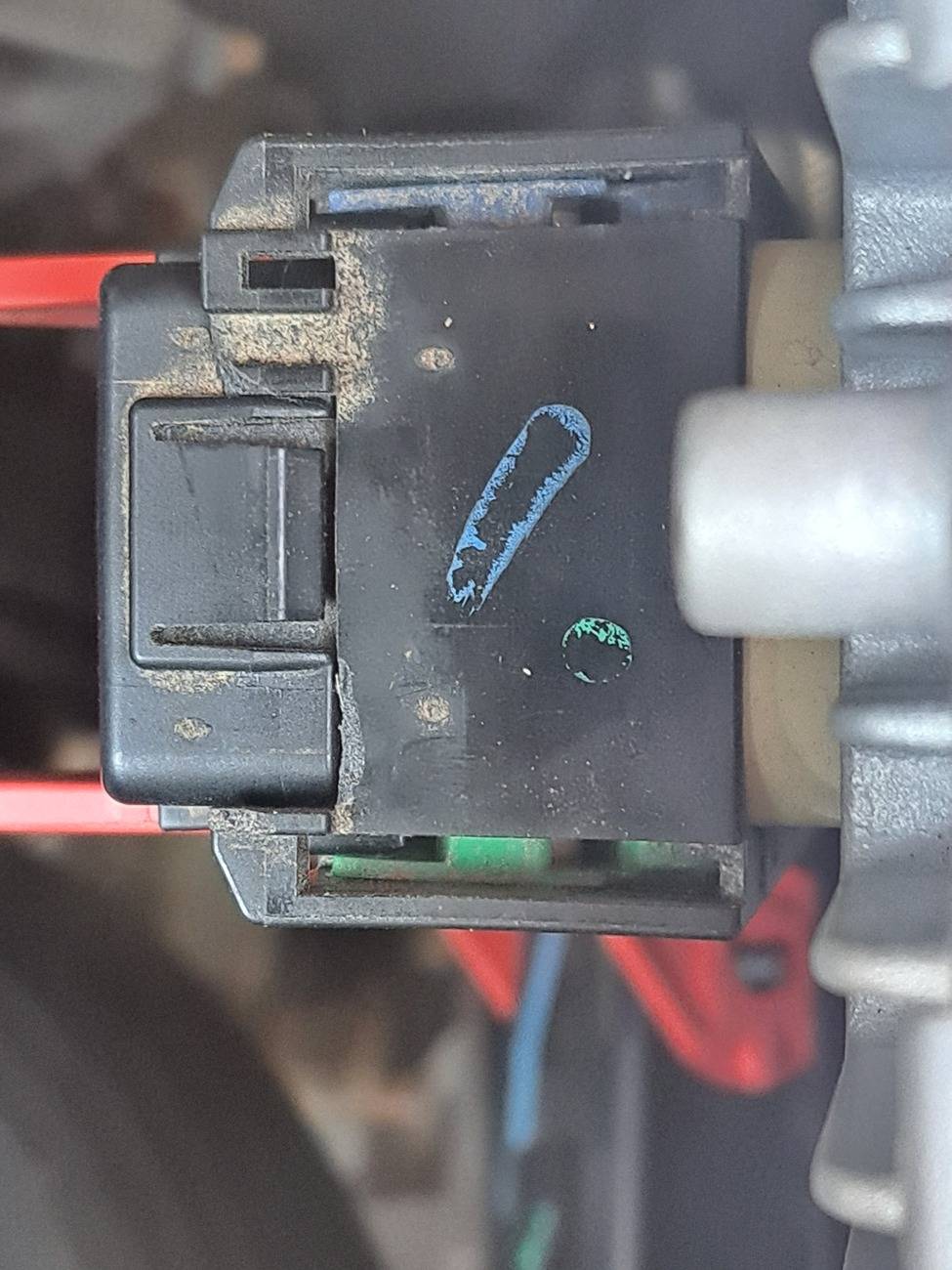

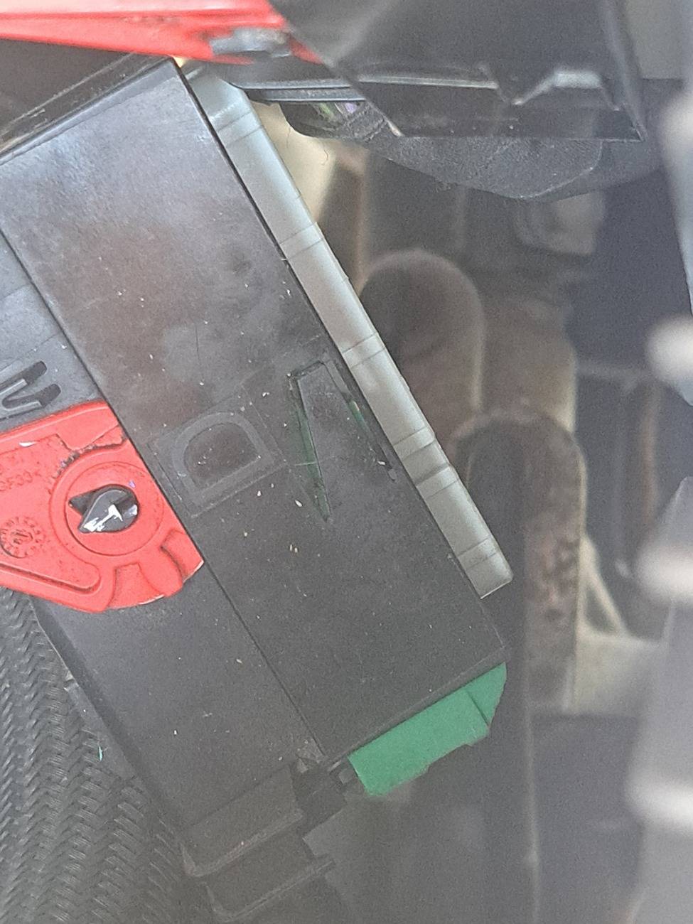

This video was a lifesaver. because it lead to you showing the same issue I was having... after placing a small flathead screw driver on top and tapping each one down slowly after 5 mins it came free.... including an image of the TOP of mine for others to see a clear picture of one being fully stuck from the top view and one showing one side once it finally was out far enough to wiggle the connector off.
Jeep Gladiator PCM Disconnect Not Working, Any Tips? 20250224_085713
Jeep Gladiator PCM Disconnect Not Working, Any Tips? 20250224_085742

also note on MINE the top locking tab is missing as it is cracked off which makes it so the LEVER doesnt work because the top tab is missing so the lever just pushes OUT away from the connector vs. pushing the taps on each side DOWN
