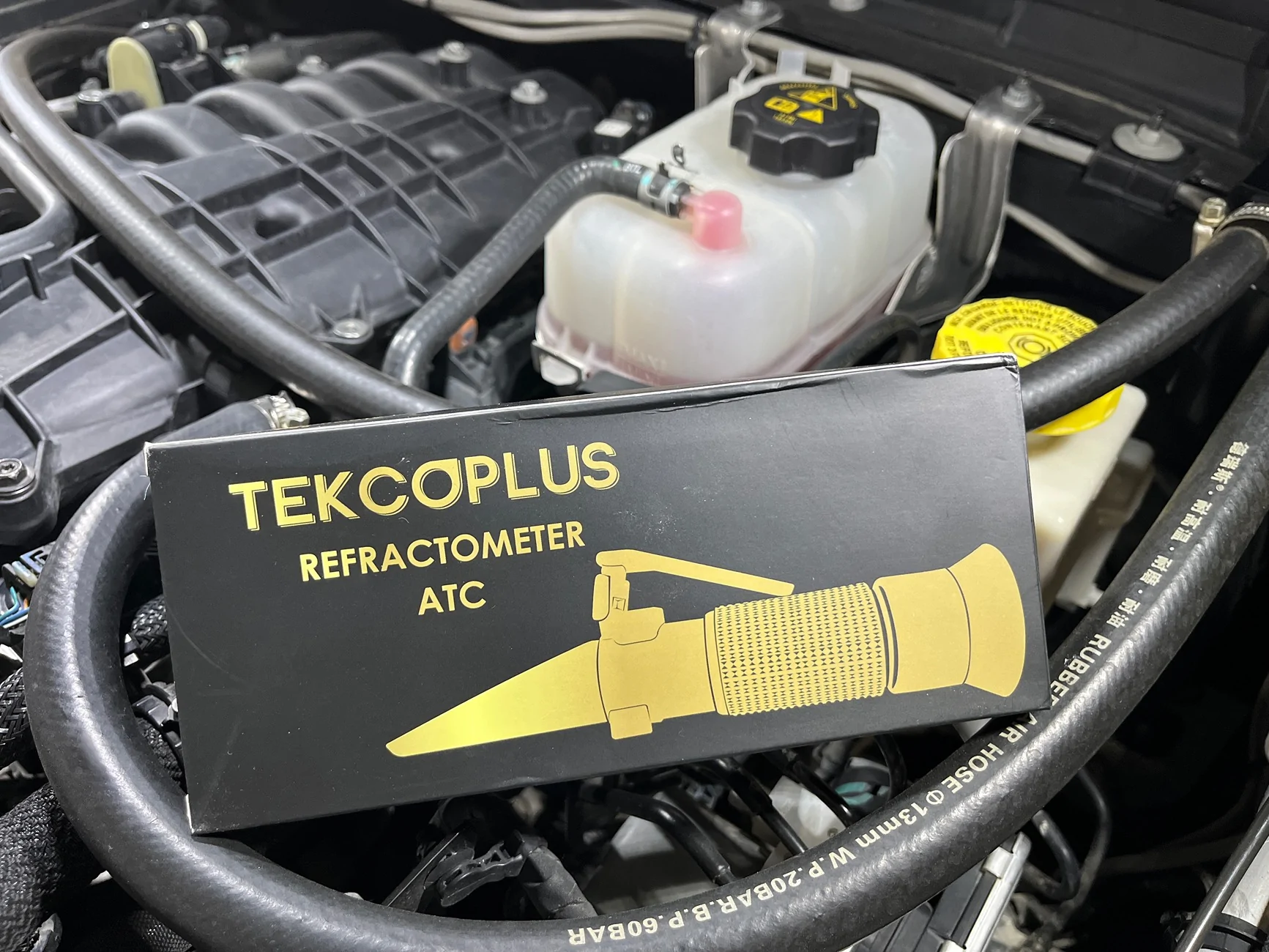

From what I've been told, a traditional (and cheap) antifreeze tester, that uses specific gravity to determine (freezing point and) coolant mix, will give a false reading for OAT-formulated coolant. To properly test the mix of OAT-formulated coolant, a refractometer is required
Thanks for this tip! Mine arrived today and I’ve already calibrated it and going to test it on my coolant in the morning!
All it will give you is specific gravity, - the concentration. It won't tell you the health of the coolant, if it needs to be replaced and so on.
Also note - some refractometers mention “Not For Use with OAT Coolant”
So make sure what you get is going to work for OAT coolant.

I tested my coolant potency with the refractometer and the ethylene glycol column showed coolant @ 35% mix. Without having this tool, I was guessing and aiming for 35/65 coolant/water, not 50/50.
Having just done a flush a month or so ago, I also decided to try lowering engine coolant temps by using Red Line Water Wetter in the mix.
Flush procedure I did was to disconnect the bottom hose and dump its load. Put the hose back on and fill with distilled water only and run engine up to temp to open thermostat a few minutes to cycle solution, then disconnect bottom hose and dump. Did this 3 times.
My process then to do the final fill was to pour in one concentrate jug of Fleatguard Cummins coolant, one bottle Red Line Water Wetter and topped up with distilled water.
Having no knowledge of a refractometer, I used a coolant tester to check freeze/boil point and had it showed -12c(+10F) 124c(155F) solution. It did not give me potency %. (What was the result?)
I did see a drop of 15F in coolant temps and never did see the 222F which is when my thermostat opened before.
I was good to run the rest of the summer like that until having read a different post from @ShadowsPapa that if mix isn’t at 50/50, cavitation was immanent so I begrudgingly sucked out the coolant reservoir and filled it to max line with concentrate. It is after this point @g2020 mentioned the importance of checking OAT coolant with a refractometer which showed me I am now running at 35% coolant. Freeze point now of -22c(-7F) - 127c(260F). Sometime in November, will suck out the bottle and top up with concentrate again which should protect me through our -30’s c winter.
All that to say I learned of a new tool for the box and was a great experiment.
Why??
That's reduced protection against freeze and boiling, not to mention less additives to protect things. You lose the chemistry of the coolant itself, the protection against oxidation, protection for water pump seals, helps prevent galvanic reaction between the dissimilar metals in the cooling system, and so on.
That's not when the thermostat opens.
These, and all others, have a range, typically they begin to open in the 190s and don't fully open until into the 220s, depending. Between those numbers, they are partially open/partially closed.
