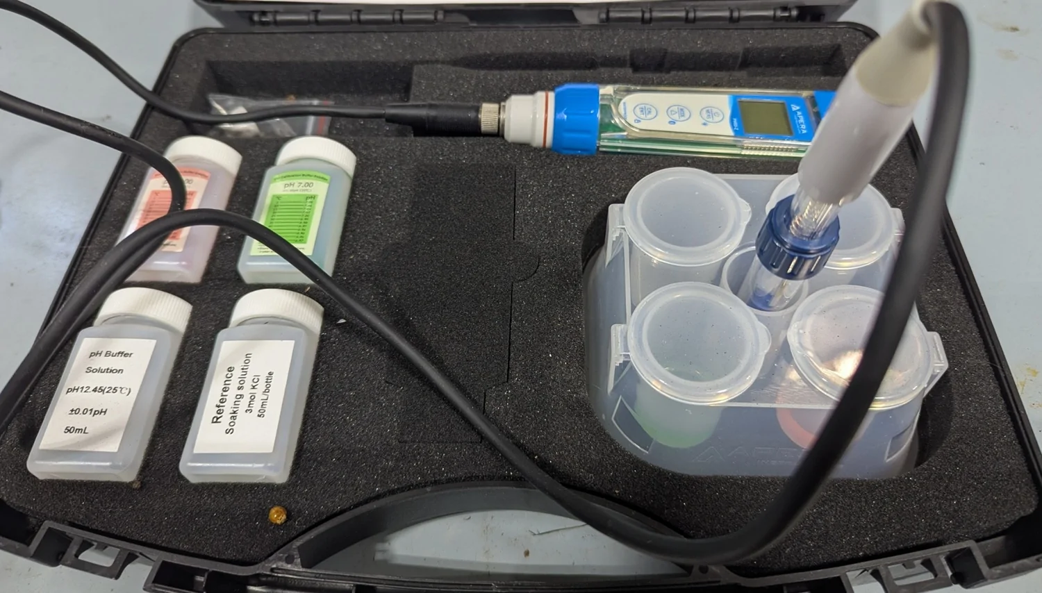

The plating chemistry I work with has a very narrow band of operation - 5.2 to 5.6. I found it's best at 5.3 for my uses. Above 5.6 or so, it's pretty much ruined and you start over with new chemicals.
You can lower it with hydrochloric acid, but too much lowering it and you mess with the chloride balance (potassium chloride and ammonium chloride are a large part of the makeup.
Another bath - the passivate, runs under pH 1.
I was wearing out my other testers, and they only last so long anyway before the sensor part, the glass bulb, has to be replaced. So I bought one that can more easily handle very strong acids but still handle my cleaning solution pH about 11.
Jeep Gladiator PEAK Antifreeze + Coolant Equivalent to OEM Original pH meter

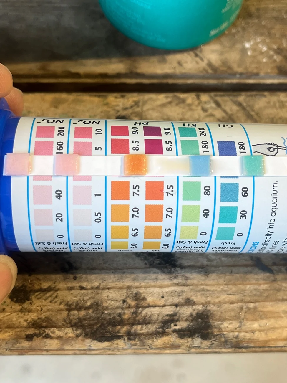

@ShadowsPapa made a good point (you do make good points but this one is worth its weight in gold) checking the pH level of your coolant. Having a level of 7.0 + is alkaline, lower numbers is acidic.
In all my driving life which started in about mid 80’s, I’ve never looked at the pH of coolant. I did however know from mechanic friends and early discussions of coolant that the solution turns acidic at about 4 years which can then cause rad fatigue and pin holes so I always just made sure at about 3 years I’d have a flush done. I never experienced issues.
This time, this morning, I grabbed a pH test strip and sucked out some coolant and tested it. 7.0 - 7.5 is where mines at. I have just recently done my own flush so the solution is fresh but I’m pleased at what I saw. Mind you it’s a pH test strip probably paid $.20 cents each. Not anything near the rocket science lab equipment @ShadowsPapa would use.
