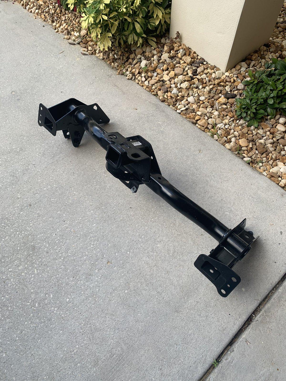

I guess this was my first mod and I’m new to Jeeps so figured I’d ask for some feedback on 2 items relating to the install of the MOPAR Class IV receiver hitch.
I have a Rubicon with the backup sensors and after installing the hitch, they aren’t working. Is it because I unplugged them as part of the hitch install process and more they need to be reprogrammed, or is something broken? They worked fine before. One of the plugs was a little difficult but I don’t see how I could’ve broken it.

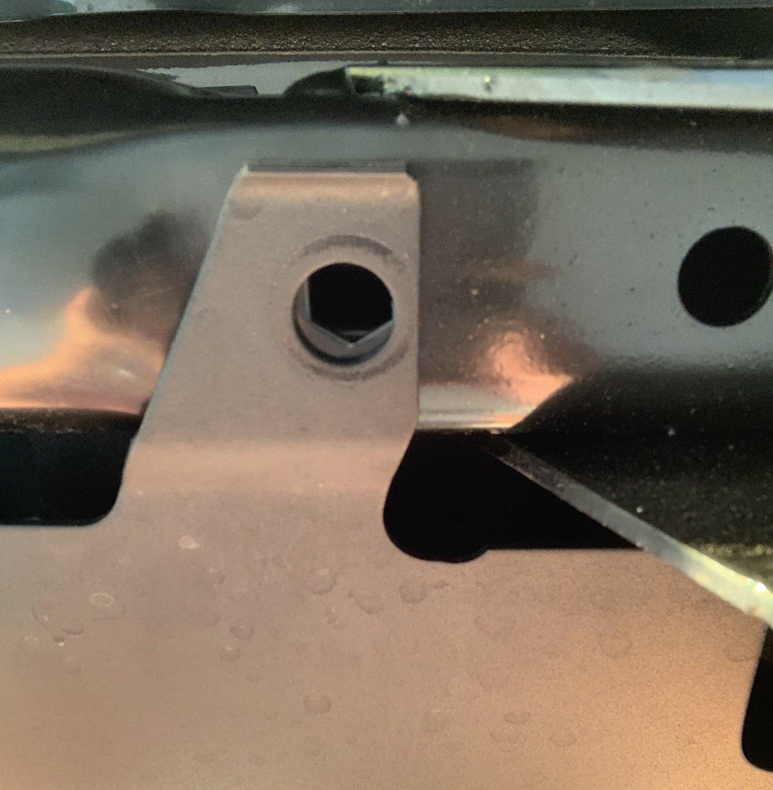

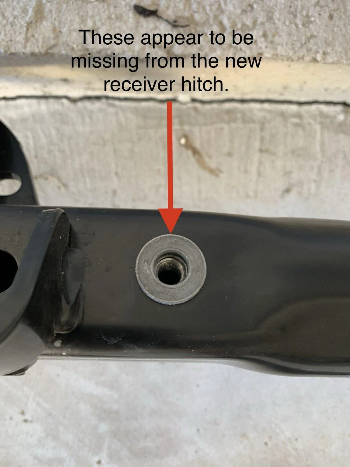

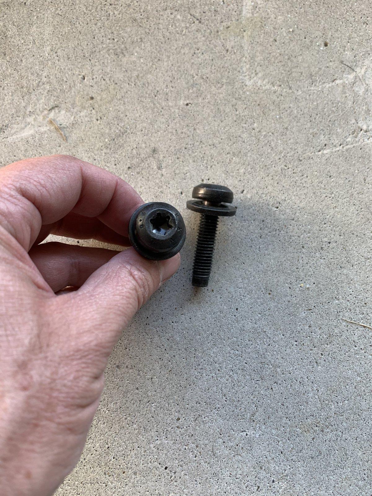

Secondly, part of the plastic bumper screws into the bottom of the hitch with 2 torx bolts. The factory hitch that was installed on my Gladiator at the factory has what appears to be nutserts in the bumper for these torx bolts to thread into. The new receiver hitch has holes in the same location but nothing to thread the bolts into. Can I just buy the nutserts to install myself or does it really even matter since it’s just securing plastic tabs? Photos below.

As to the missing nutsert, of course you can install your own but it may be somewhat difficult in getting the exact nutsert part number to order if the hitch illustrated parts breakdown does not list a separate part number for it. My OCD would have me putting some kind of plug or faster setup regardless but it looks to be non critical if left off.

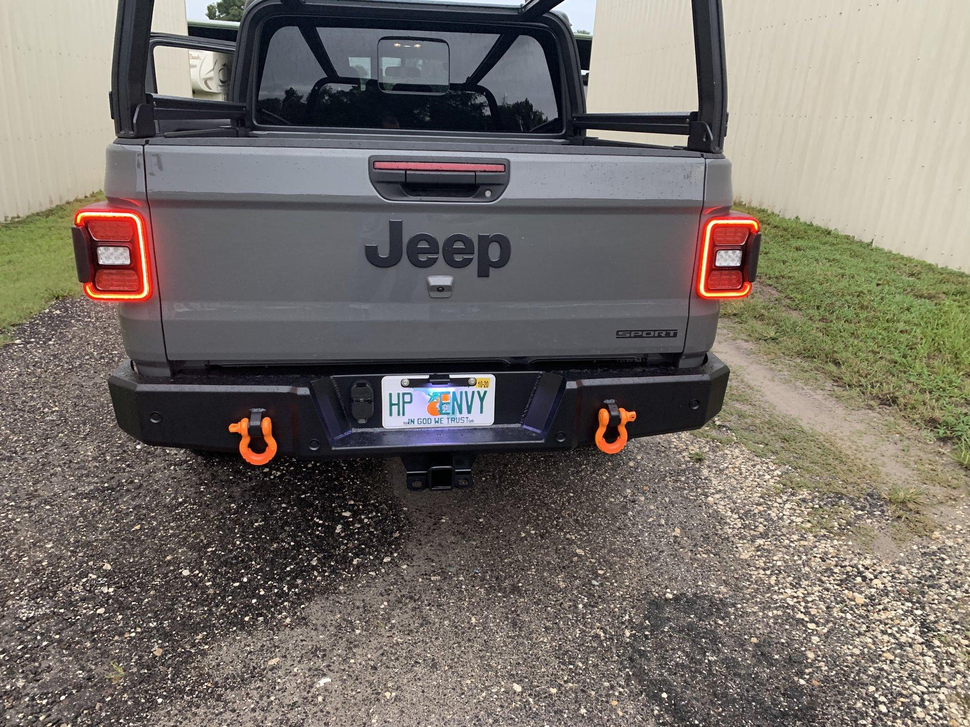

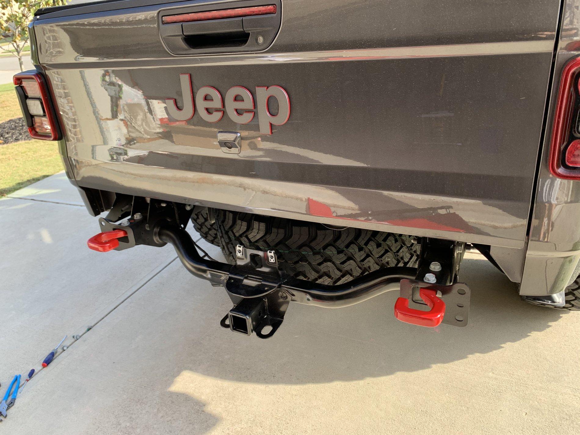

What’s the reason for switching hitches?
The hitched on our Gladiators aren’t like the ones I was used to on TJs and JKs. On our trucks the hitch seems to be a structural part of the frame like a crossmember.
It’s not like buying the receiver portion and just bolting it on like the Wranglers ( not sure about JLs). If you truck didn’t come with the tow package the “crossmember” is still there but is tucked up against the bumper so you can add a hitchball in the hole of the bumper.
To add the 2” receiver you have to swap out the “crossmember” with the one where the 2” receiver is welded on. I found all this out after being rear-ended and doing my own work to put the labor monies toward other mods. Got hit so hard it bent the receiver.
While I was at it I replaced the rear bumper with a Magnum Raptor instead of using a new OEM plastic one.

Great looking bumper! I called my dealer and asked if they had the receiver hitch in stock, and they said yes. I showed up and they tried to seek me that bolt on Class II receiver.

I’m curious about the two Torx.
did you ever do anything? I just installed my hitch and was like, what the heck? Lol
No, I haven’t done anything with it as of yet, not sure I’m bothered enough by it at this point.

Reviving a really old thread here… I just recently purchased a JTR and swapped out the hitch for the class IV. Anyone ever find a solution for the two torx bolts that attach the bottom of bumper to the hitch?
