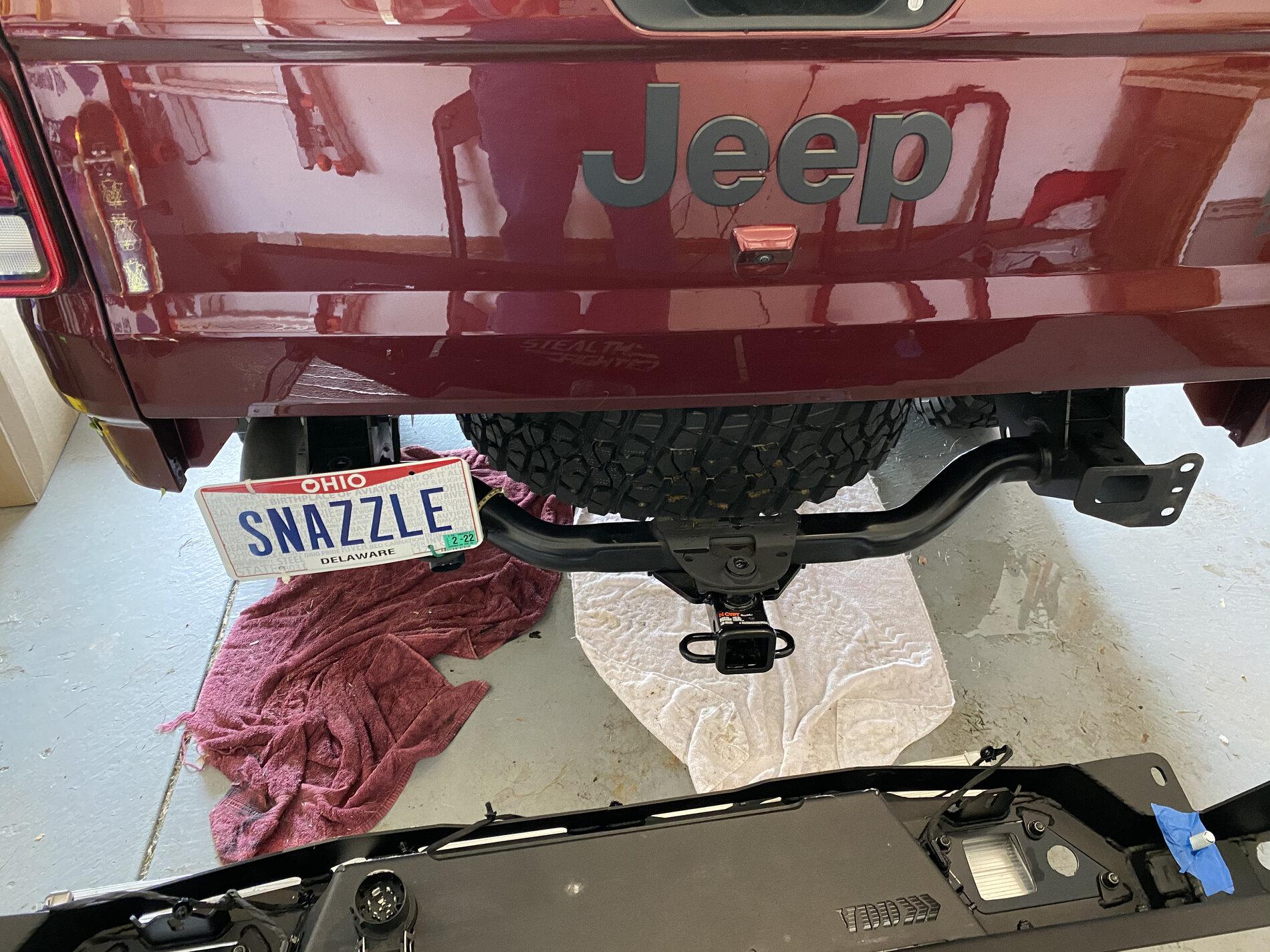

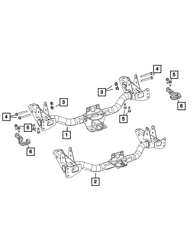

Attached are the prints of the rear crossmember with and without the receiver. My Willys came without and I ordered a Curt Class III Hitch kit for $99 through eTrailer. The difference is that the Curt is bolted on (two up through the cross member fro the bottom and one down through the top) whereas the OEM has a single 4" weld across the face.. Is the weld superior? Probably. But I 'm not worried. In and of itself, the Curt is rated 5000 pounds. But the truck is restricted to 4500. https://www.etrailer.com/Trailer-Hitch/Jeep/Gladiator/2021/CU74FR.html?VehicleID=20215001631
Jeep Gladiator Class II receiver hitch d28c7ee4e675e10d77f4456961f64db8
Jeep Gladiator Class II receiver hitch IMG_2978

If UHAUL installs a Class III (5000lbs) 2" receiver and you have the automatic transmission (manual has less tow capacity) then 4500 on a Willy's Sport will be the max. That 1000lb difference may be useful someday. Class IV is overkill but Mopar available. I believe there is a Class III Mopar addon but not sure it hits 5000 lb capacity. Class III can be from 3500-8000 lb.

Thanks I hadn't looked at the specs on the bolt on Class III but 5000 should be more than the Jeep can tow without the Max Tow accessories. I'm sure it will be safe. The base frame mount is every bit as stout as the Class IV hitch only lacking the welds vs bolts.

What the heck is the difference between
68368176AA
82215648
