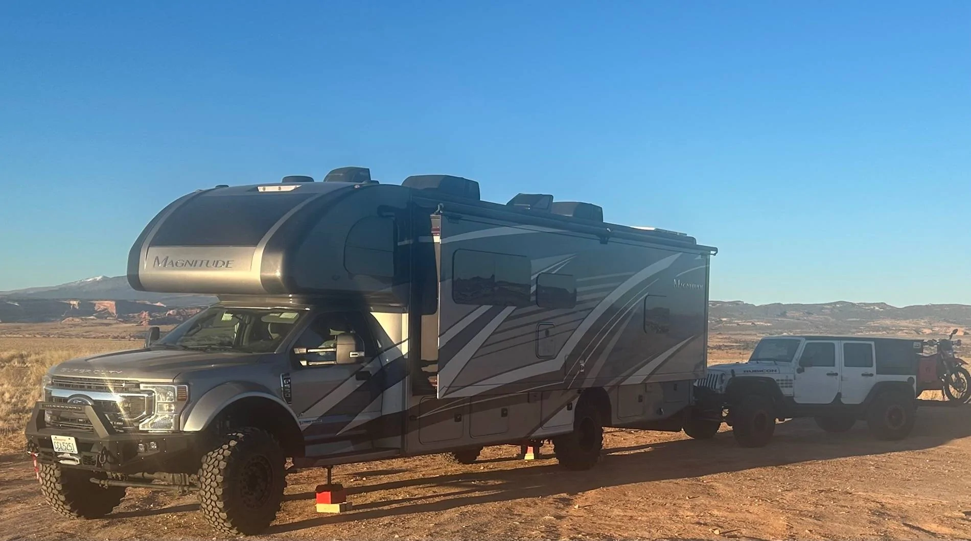

my motorhome has an onboard propane tank mounted behind one of the doors, and quite frankly, it can be a pain to get it filled in remote areas. In fact, I carry two exchange size tanks and have a regulator and hose that allows me to use the exterior propane port to connect these smaller tanks to the motorhome…just have to shut off the onboard tank and connect a smaller tank.
Two years ago on our winter trip, I had a hard time finding someone to fill our onboard propane tank in Northern Arizona/southern Utah. At the truck stops, it was too cold, short staffed, storm on the horizon or some other stupid reason. We stopped at 7 places over 250 miles, and finally found a KOA that would fill our onboard tank. At that time, I only had one full portable tank that was full, so swapped the empty at a Home Depot. I‘ve even thought of replacing the onboard propane with two portable tanks I could swap at Home Depot or other store in a pinch, but taking along two portable tanks has solved our problem.
We spend a lot of time boon-docking, so it can be hard to find places to fill an onboard tank when it runs low...
