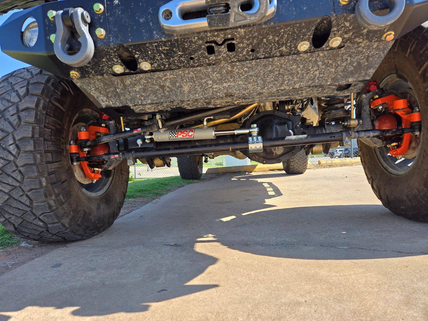

It’s been a while since I sold my Rubihara LJ but when I went to 37’s I put a PSC/redneck ram assist on it. Great companies to work with. I emailed them several times with noob questions since it was my first time going to ram steering and got really helpful responses. It was a huge improvement in on road and off road steering feel. I wound up going with a rebuilt gear box from redneck ram due to budget as they were about 2/3 the cost of a new PSC gear box at the time. I added the kit cylinder assist, reservoir, and radiator mount fluid cooler from PSC.
I noticed the same that you commented about that if sitting at idle it was a bit stiff but bump the throttle and it was luxury car steering with the heavy tires compared to stock steering. I lived in NV at the time so I was paranoid about it overheating but never had any issues with it.

Just a quick update after everything is installed. I've got about a 1k normal driving miles on it and I'm really happy with the way it performs. I had some concerns that it might slow down a quick steering response, but that is not the case. The only downside is, when the rpm's drop down to 500 (in gear, idling), it doesn't really add much assist. Just a little bump of the throttle and all is good. It turns the 37's aired down, with front diff locked with ease.
Could you tell me which PSC kit you went with? I am curious about the belt driven compared to the Electric Pump replacement they offer.

It was the belt driven kit.
I've since gone up to 38x13.50's and even aired down to 9psi, there's no problem turning, even when locked.
