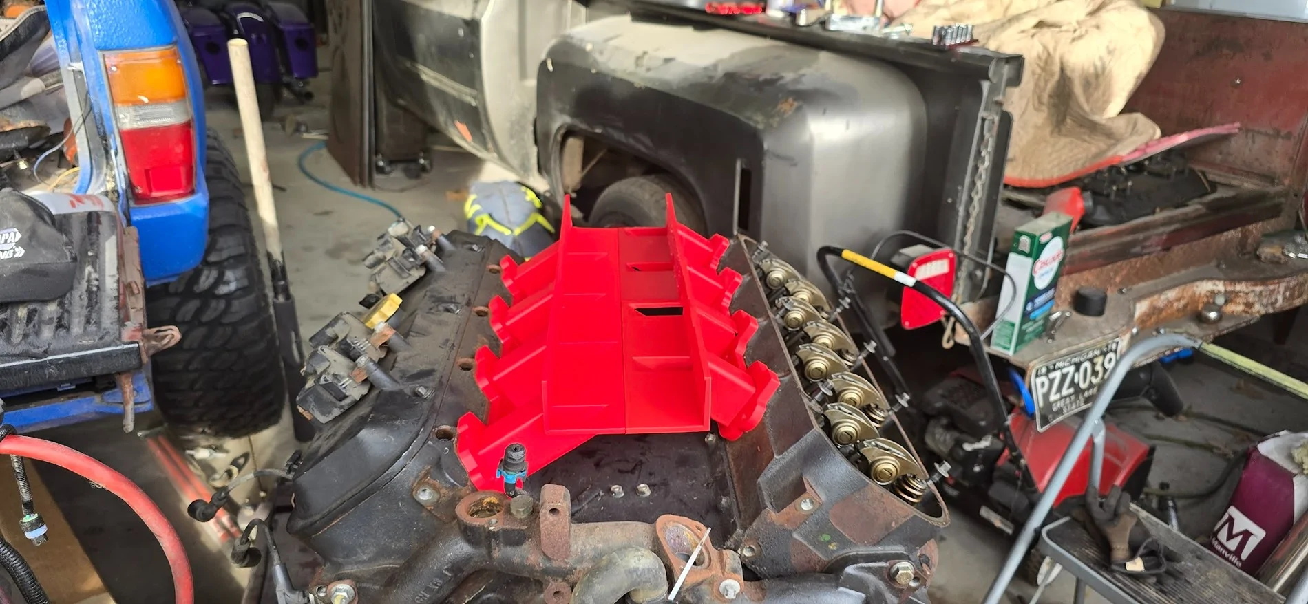

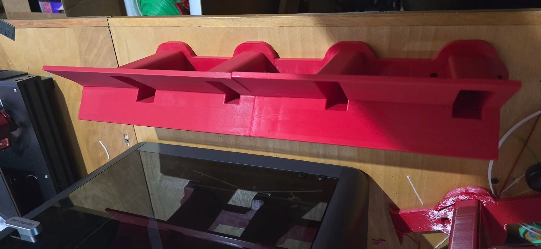

Printed the first trial last night, mainly to make sure I got the angles, spacing, hole locations right.

Test fit, nailed it, so good to go with a real design.
Amazing the amount of weiners who just can't wait to ignore the words test fit and start yammering about laminar flow to show everyone how clever they are.
I direct them all to the STEP files, look forward to seeing all their designs :D

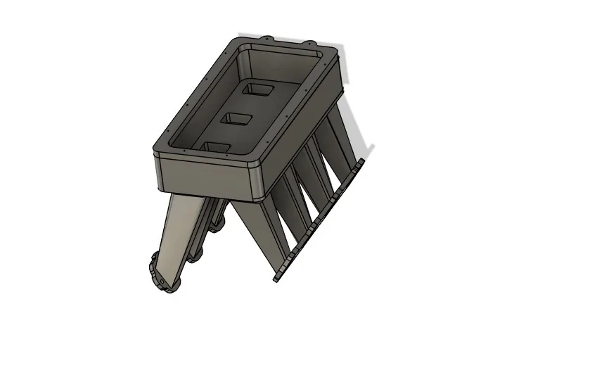

Mr 2k per download was inspired to release his files open source, which is nice, because the Holley lid pattern is the piece of the puzzle I was missing.
So I'll have two, maybe three sets of runners, an 8.1, an 8.8, and perhaps an 8.8 with injector bungs.
Then squeeze the runners together so they fit within the Holley footprint, instead of hanging over like these do, and make the plenum bolt together fore/aft as well as the bolt on runners.

I'm, like 85% done with this.
Needs the runners hollowed out, and flanges made to have them be bolt on, needs the plenum divided to print in 2 and bolt together.
I'm more or less done with the project myself for the next 4-6 weeks.

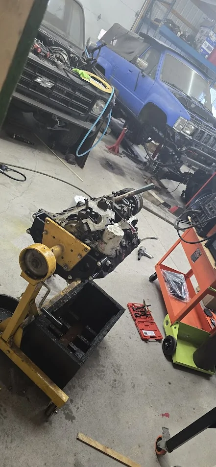

Of all the stupid things to be stuck on, I can't get the cam out, because I can't get the crank pulley off lol.
Thinking I'll have to modify my Chrysler/LS three jaw deal as my best bet.
Haven't really decided on an order of operations here, but currently leaning towards having this drop in ready before I pull the 6.0

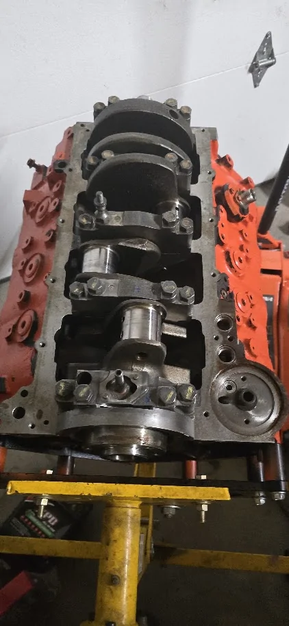

Went back to work on this last night. Guy who builds lots of these for truck pulls and boats mentioned he often needs bearing halves to get the clearances where he wants them, sure enough, I had about 0.0015 on the front and nearly 0.003 in the back lol. Not only does it not meet the "rule of thumb" for clearance by bearing size, it doesn't meet PSI's spec either.
Aftermarket vs OE quality, there is no Six Sigma accuracy in the generator engine process lol.
So, as I always caution people, being weird, has a price, and for me, this price was another 80 bucks in undersized bearing halves to get all 5 to 0.0025 - 0.003.
With that bit of tedium done, need to pick up few odds and ends to put together the bottom end, just a rear main seal and some STP lube and I should have a short block.

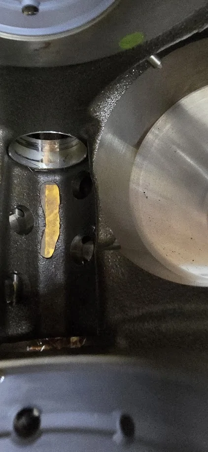

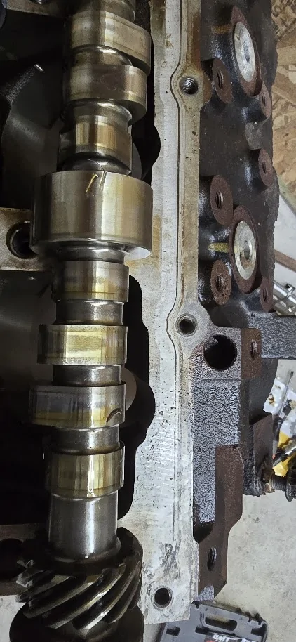

I forgot to put words lol.

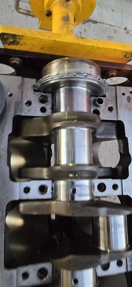

I hadn't taken the stock cam out, so I went to do that, it was fairly stuck covered in shrapnel, and # bearing is pretty gacked up.
So I'll hose the block out and get the bearings replaced. Kind of annoying to have to take it off the stand, but it is what it is. Not terribly surprising for an engine that I know ate trash from the other bearings.
